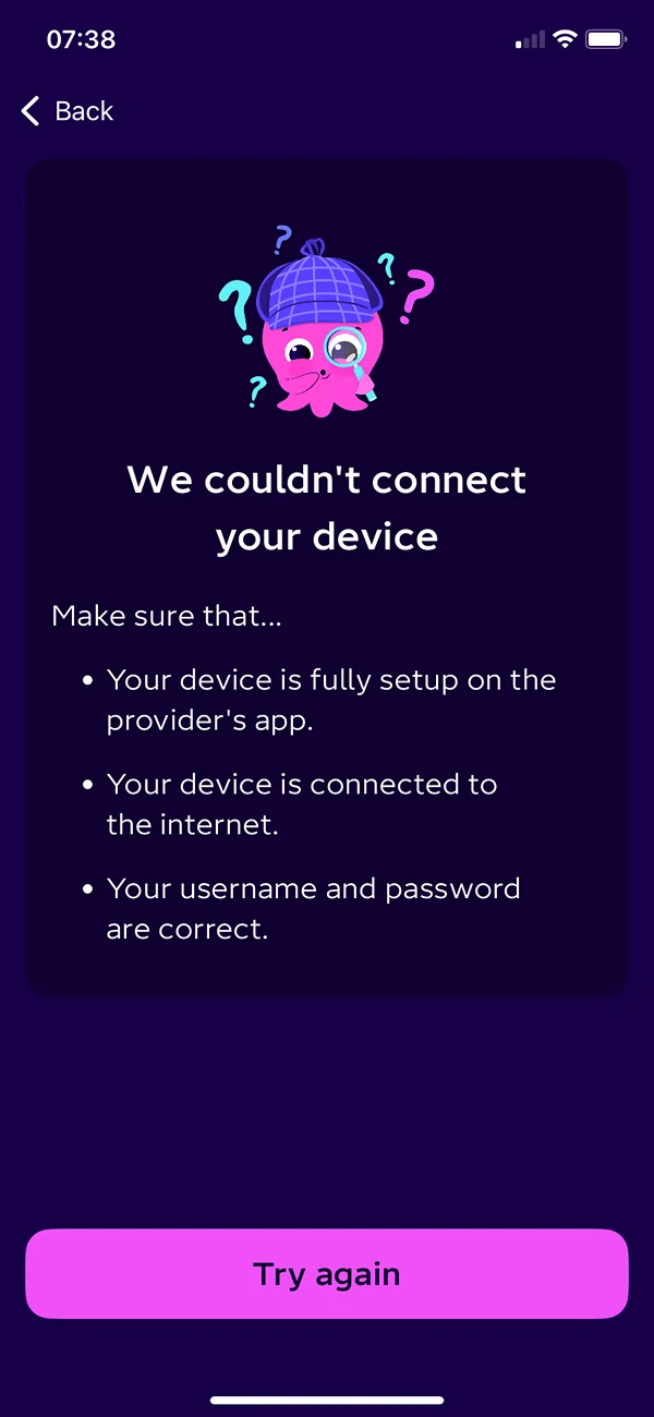

Hi,
I’ve been onto the Octopus Energy up again this morning and the choices are – add device.
1. battery
2. Electric vehicle.
3. Heat pump.
Self selected electric vehicle.
Next prompt is are you at home and plugged in?
Next option is make of electric vehicle.
Next option is your model
The next option is brand of charger.
Next option is model of charger.
Once I’ve selected all these and then get the following error message.

Hi,
1. battery
3. Heat pump.
Hmm, not sure how to proceed.
Octopus installed my Zappi so they already knew about it. I wonder if you need to let them know you have it before it gives you the option - might be worth pinging them or searching their FAQs.

Try choosing a make of car that is not supported then maybe it will connect via the charger. Tell it that it is a Land Rover PHEV

Octopus changed their preference of onboarding into intelligent go back in November. They’ve now said they will try and integrate directly with the vehicle if its supported even if you have a compatible EVSE. With the vehicle integration they can see SoC from the car which they can’t via the zappi integration. All a part of their recent efforts to manage the off peak charging rates and those who have been gaming the system somewhat to extend the off peak rate for the whole house.
You can still integrate with the EVSE but you had to ask octopus CS to allow the option in the app.. I think they’ve now made it some what self serve and there was a link you could follow to do it… it was the octopus forums so can dig out the link if needed.

Octo Intelligent Go, by default, wants to control the car, which forces a Porsche Connect subscription.
However @taycangt3 you need not accept the default process. Tell Octo that you do not wish to maintain a Porsche Connect subscription, and ask that they control your wall charger instead.
They've done this for me and it has solved integration problems.
Once you're connected to the charger then, on the car, you'll need to
- disable any active charging Timers
- fiddle the charging Profile - instead of setting a preferred charging window e.g. 2330-0530, select the option for intelligent control (so it can take instructions from Octo Intelligent Go)
- Set the charging Profile, noting that what used to be the 25% 'minimum charge' slider now becomes your charge limiter (max setpoint). Without this set to say 80 or 85%, Oct will charge the battery to 100%. Once set the car will terminate the session at the desired COS, as indeed mentioned already by others on this thread. (You'd wat Oct to do this, but unfort it doesnt work like that on my 2020 4S)
looks like you can follow this process to avoid having to call CS up..
IO Go - enable charger option
can take 24 hours to show in the app though
