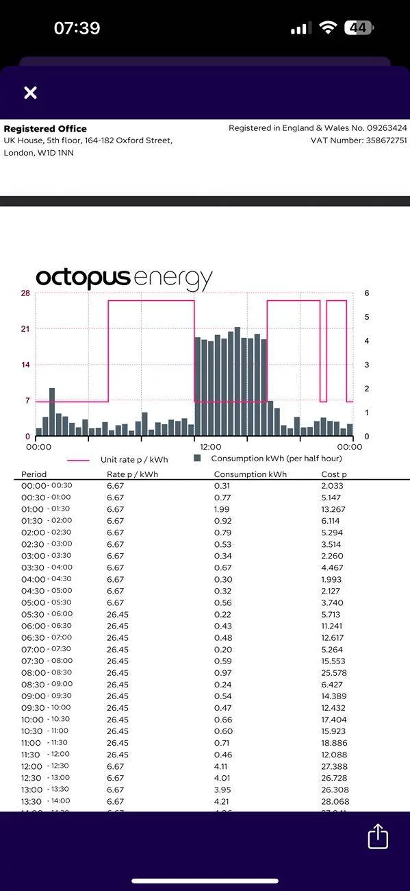

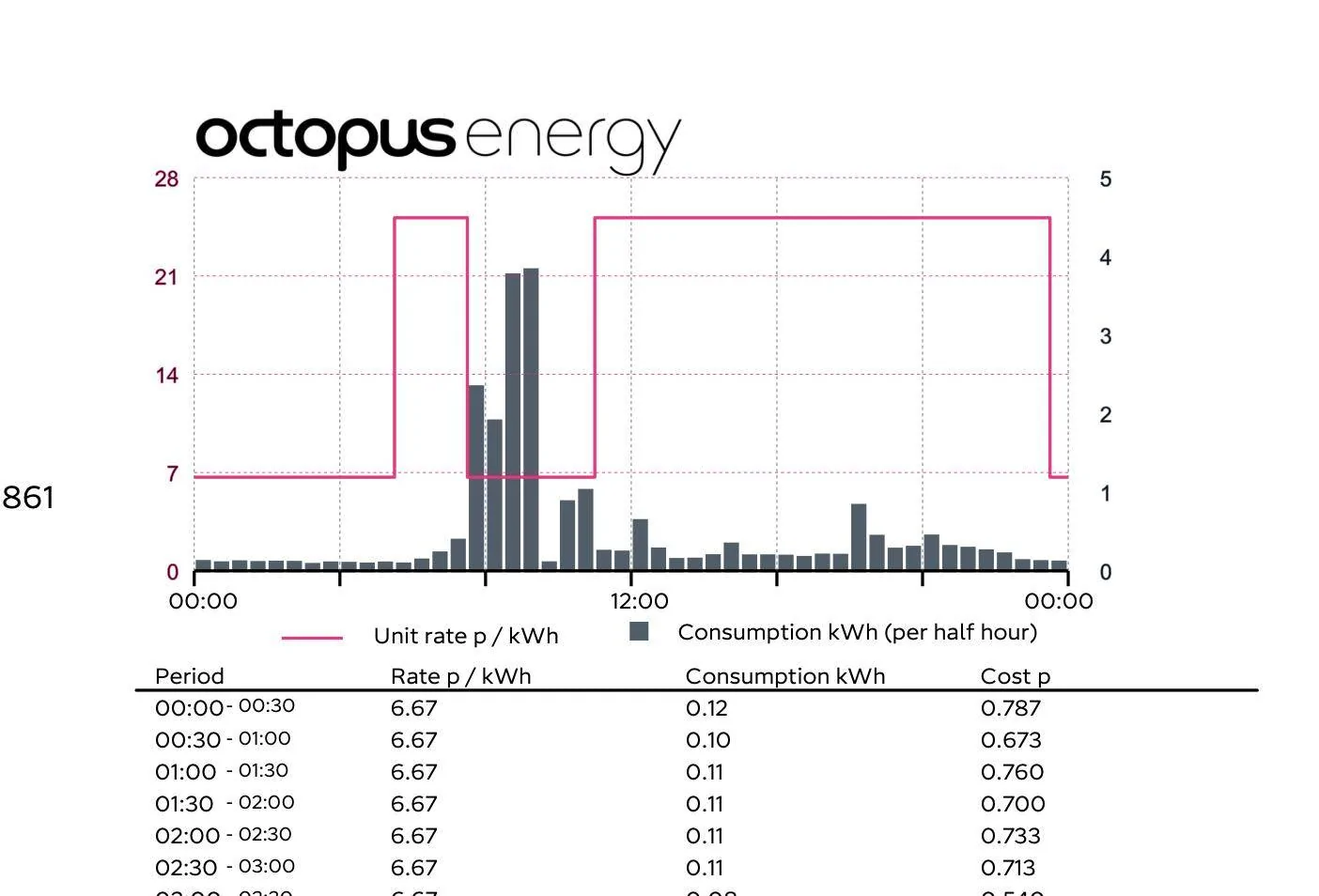

Is IO controlling your charger or your car? I have a pod point charger which IO cannot control, so I have IO controlling the Taycan, which appears to work absolutely fine, except the rate stays at peak rate when IO charges the Taycan.
Yes - IO is setting the charging schedule and controlling charging times via the myenergi charger. Here is a typical daily half hour data sheet - as you see OE seems to control the charging well within the low rate time periods. (For info i have a PV system and battery strorage which means that the house doesn't consume any grid power during the day ).

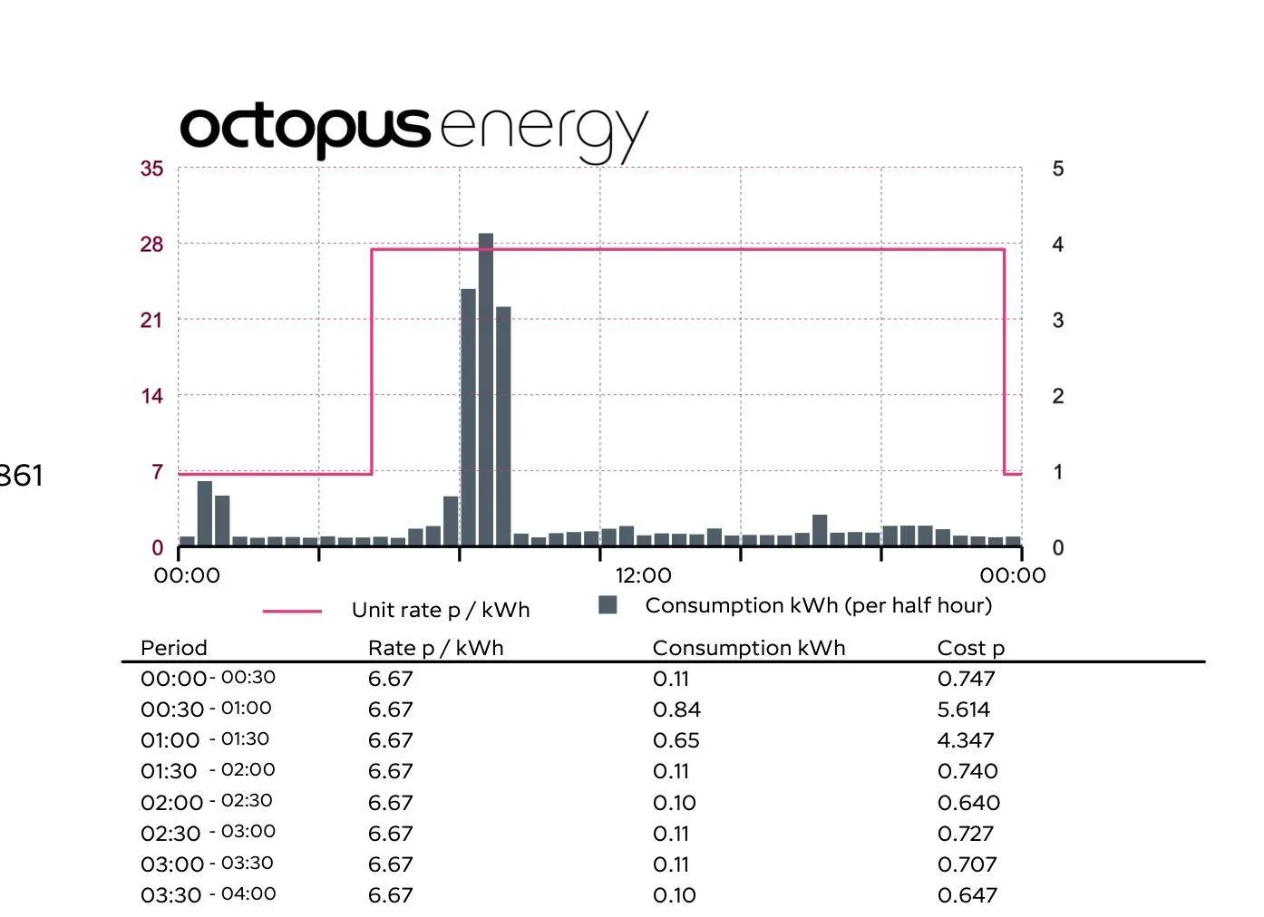

Thanks @SJGG , mine works fine in the same situation as you’re pointing out there in that within the 11:30-05:30 window I get the 7p rate.
However, when IO initiates smart charging (IO is connected to my Taycan), outside of that window (anytime but for me typically in the morning 8-11am) the rate (i.e. the pink line) does not fall and apply the 7p rate to those sessions. It should do that and always has with previous EVs, it’s just with the Taycan that it is not.

It's interesting that the charging sessions you've highlighted are beyond the overnight cheap window. Is the car charging in the cheap window but needs to continue charging later because it's not had enough time to complete? - if you regularly ask for 70kWh on a 7kW charger you need at least 10 hours to complete and I'm not sure how Octopus handle that. Does the charging schedule Octopus gives you have enough time to complete? I believe Octopus will actively stop you gaming the system if you ask for more charge so you can use cheaper electricity around your home outside the normal overnight window.
Bottom line: you need yo speak to them.

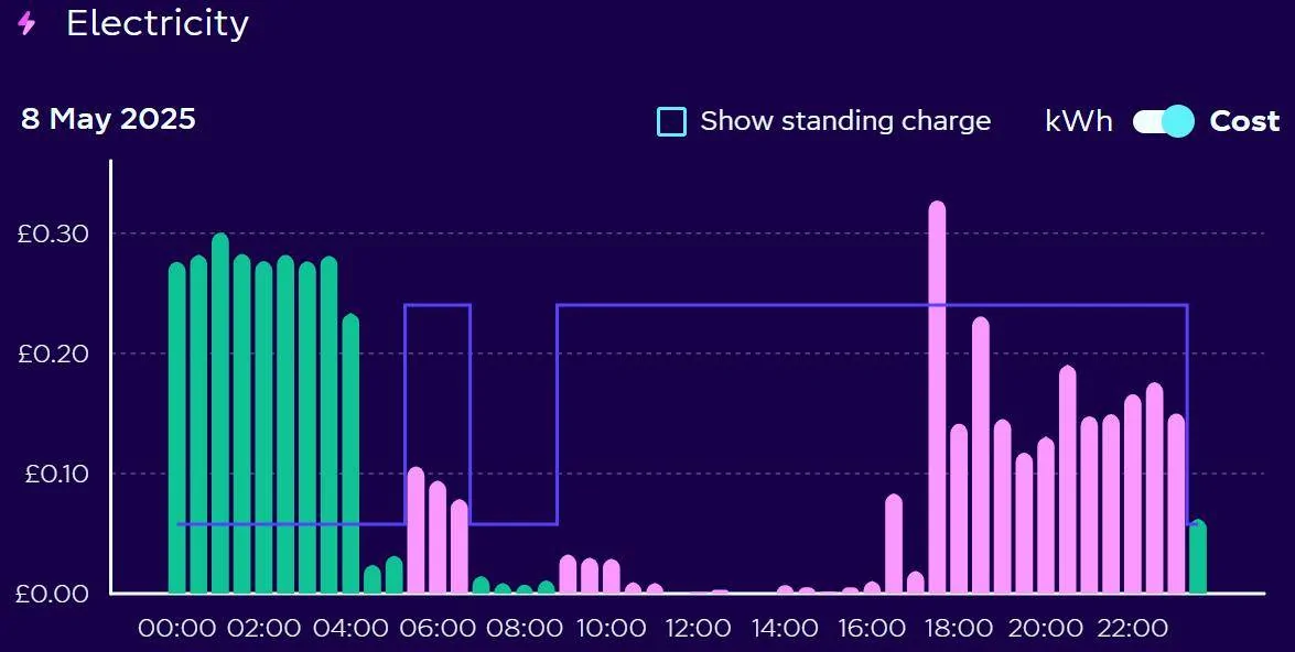

Yes @tophamn I inevitably will need to speak to them. Out of window sessions for me have been for both when I’ve returned home from a trip empty the night before and it continues outside the window or when I want a top up to 100% for nearer to when I depart rather than topping up to 100% and having it sit for 5-6 hours. Happens maybe 2-3 times a month.
So it’s not about gaming the tariff and it seems far too much of a coincidence that it was the change of car connected to IO when these out of window smart charge sessions stopped having the 7p applied to them.
It feels like a system issue their side rather than it being the Taycan, but I would still be keen for somebody to confirm that they’re getting out of window sessions at 7p with their Taycan being the connected device for IO.

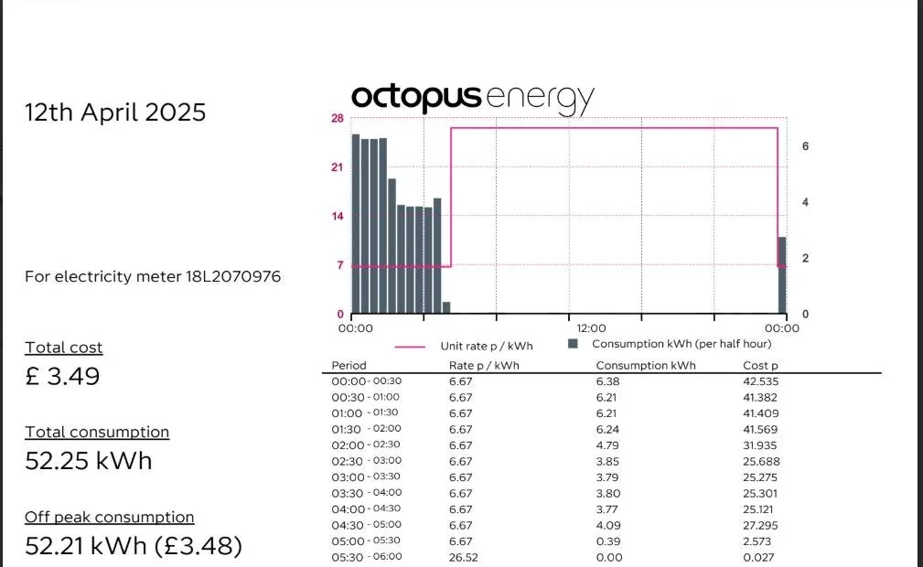

Thanks for the original post, I'd not checked mine for a while. I can only find one example of 1.5 hours of charge at the higher rate, so seems to be OK for me. The example below is a Saturday where it charged during the day, 5th April.

Great thanks for that @DSB , just to make sure, it's definitely your Taycan that Octopus is controlling (its connected to it via the app), rather that your charger?
Yes, the wall box has all settings off, so its the car and IOG working together. I did have one issue a week or so ago (haven't got the bill yet) where it started charging in the evening and the schedule on the IOG app was for the night only? Normally it has the on peak hours in the schedule as well as off peak. Sounds like yours is on its way for remedy
