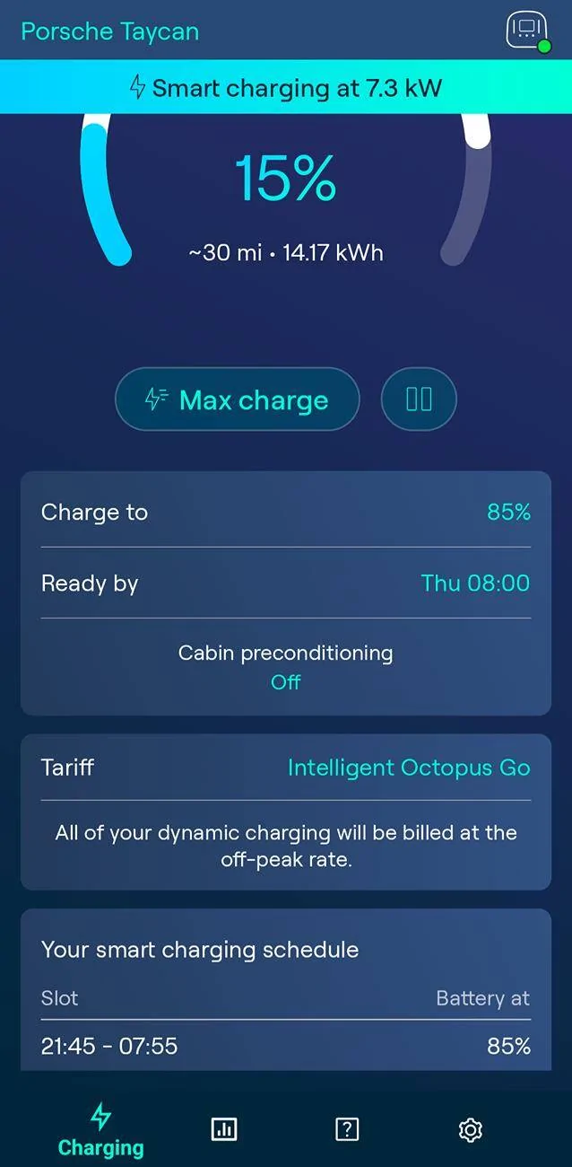

I took delivery of my Taycan 4S last week. Really loving it so far. Awesome car ??
Just thought I'd give anyone who is on the Intelligent Octopus tariff a heads up that it seems to be communicating nicely with my Taycan at the moment.
When I switched the car to the Taycan in my Ohme app (from my wife's car) it prompted me to sign in to my Porsche account. Now it sees the state of charge and is doing all charging at the cheap off-peak rate. Fingers crossed it continues to work! Not sure if you need Connected Services for it to work?
Let us know if it's working for you!

I assume your car is under 3 years old and has Porsche Connect functions. As mine is 4 year old and I don’t subscribe to Porsche App Octopus App cannot communicate with my car. However I am still able to take advantage of cheap overnight electricity by using Porsche App timers to start charging.

I'm surprised to read that Ohme communicates with your car (via the cable or through Porsche's server?). From reading many threads in this forum it seems problems occur whenever the Porsche server cannot communicate with the car.
I have Octopus Intelligent go and a Myenergi Zappi EVSE. I have settings in the Myenergi app but no option for it to talk directly with the car. Note that in this config there is no way to determine the current level of charge in the car.
My options are to use the Octopus system to control either the car or the charger - for the sporadic issues communicating with the car I opt to control the Zappi charger. The working solution I have is to use the Octopus app to set a % of charge to add - if I over state the % charge required I then rely on the car's profile/timer settings to limit the charge. Octopus then control the Zappi charger to add charge to the car at their cheap rate (which is usually in blocks through the night) - and again note that if the charger doesn't allow the car to charge before it reaches the required level it shows the error.
The communication is via the Porsche server. When I selected the Taycan in the app, it prompted me to sign in to my Porsche account. From the comments above I'm thinking you have to have an active Connected Services subscription for this to work. Mine is under 3 years old so still has that. I'm also not sure that the Zappi charger has the capability to connect with the Porsche server.
I do think it's a bit lame that you have to subscribe to the Connect Services for this to work. I'll enjoy it for now and possibly re-subscribe when it expires because it is a nice feature
