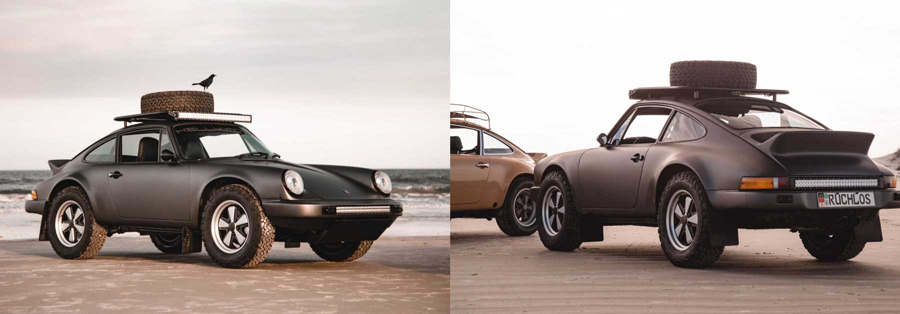

There is a dog basket in the centre of the tyre where the bird is perched!
I though it was a nest for the pet bird which gets strapped in a harness when driving.
