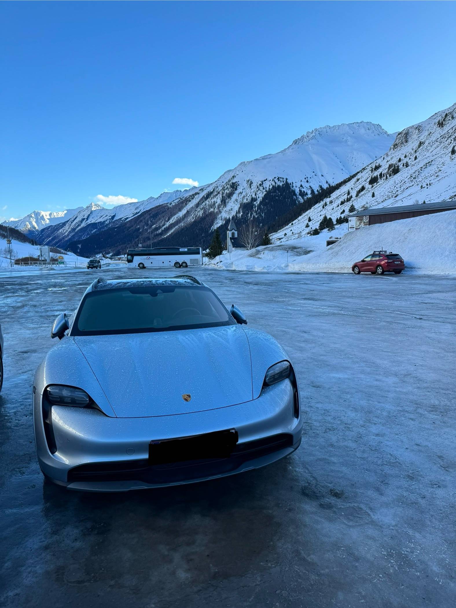

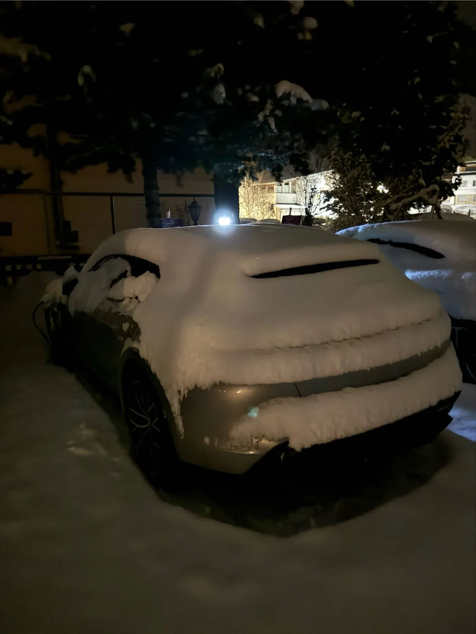

Probably like mentioned above humidity on the rubbers when parked.
This picture was me last week at 5 am and minus 8 Celsius. Preconditioned. Used trunk frunk and 4 doors to pack and leave (after removing the snow) and no issues opening and closing Some days before (second picture)the car was covered with ice and no issues.
In Belgium it is parked inside. Will se tonight what happens I have a late meeting and it is parked outside.
