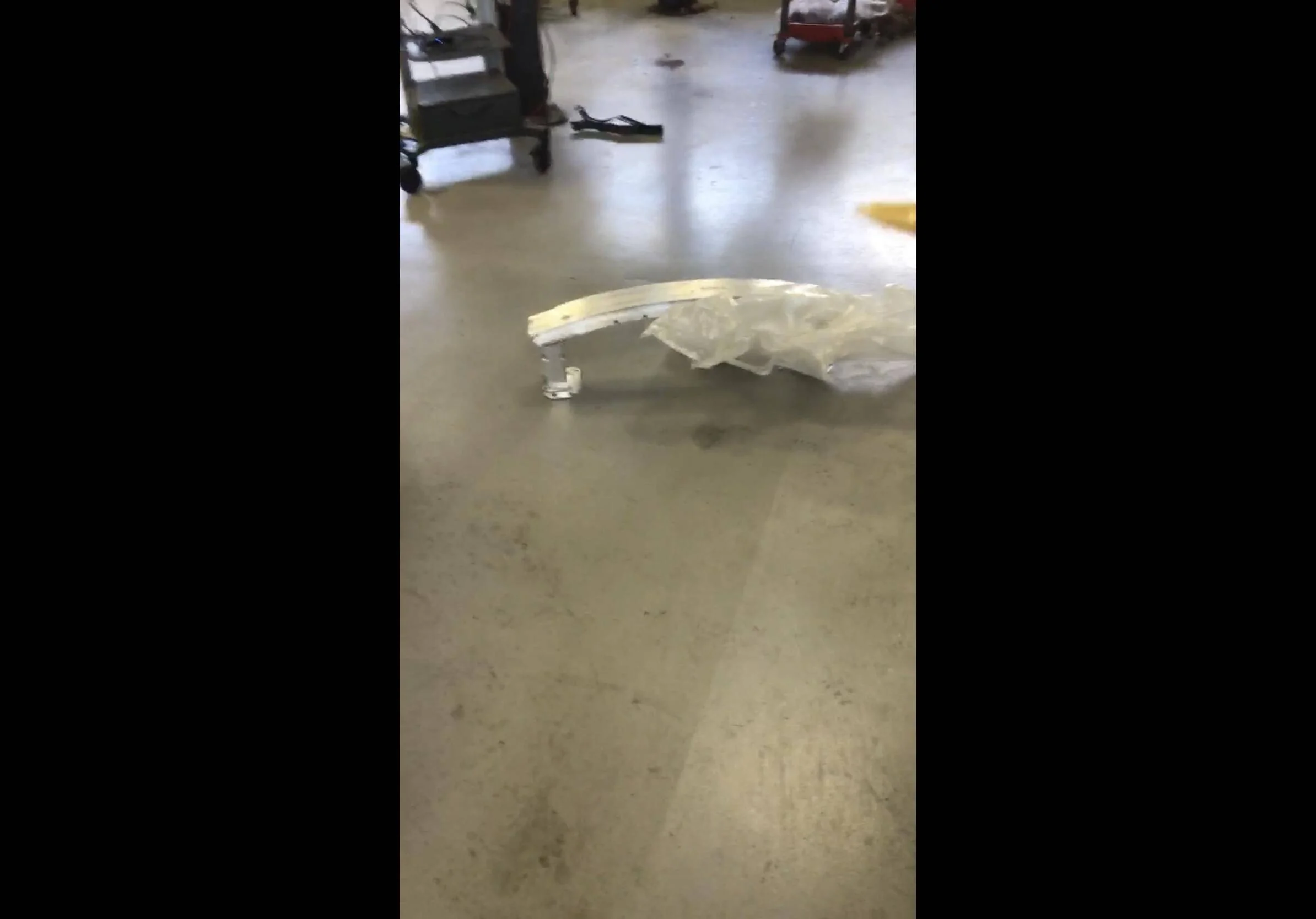

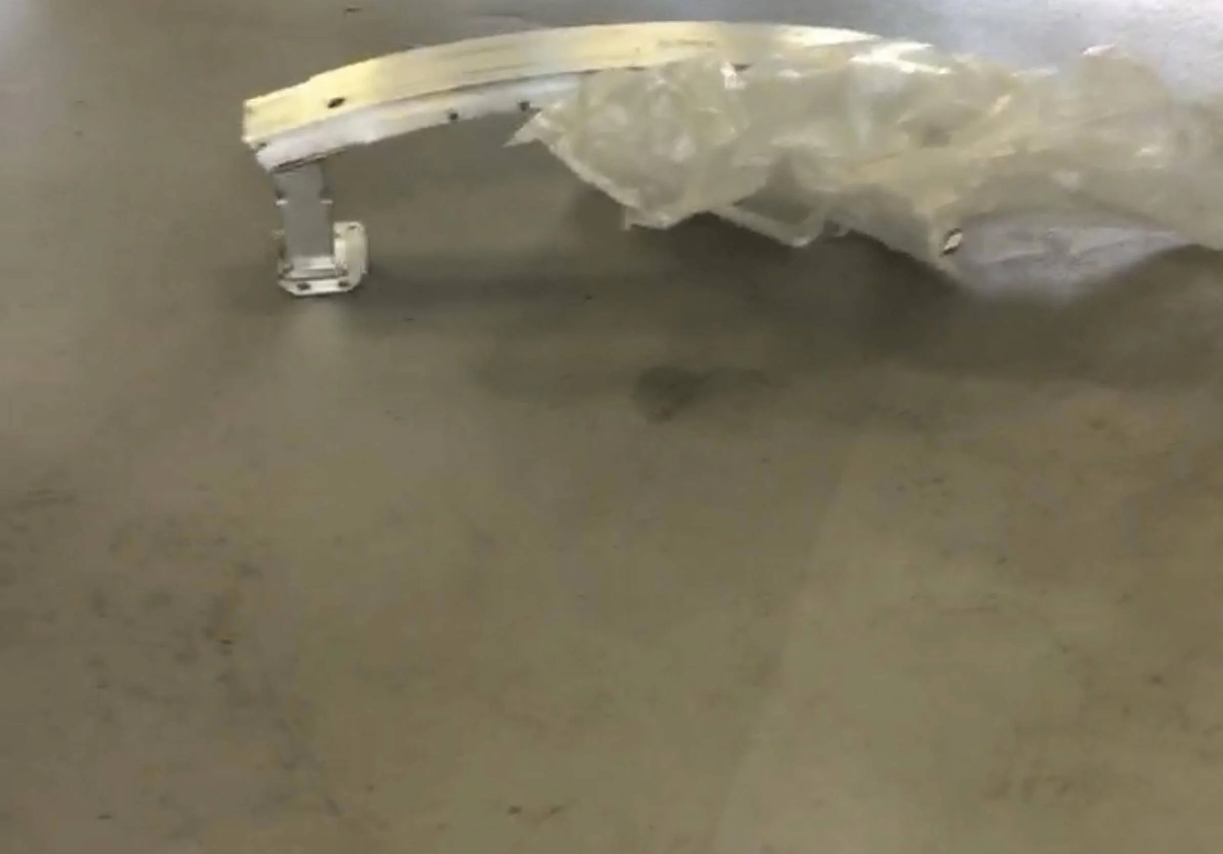

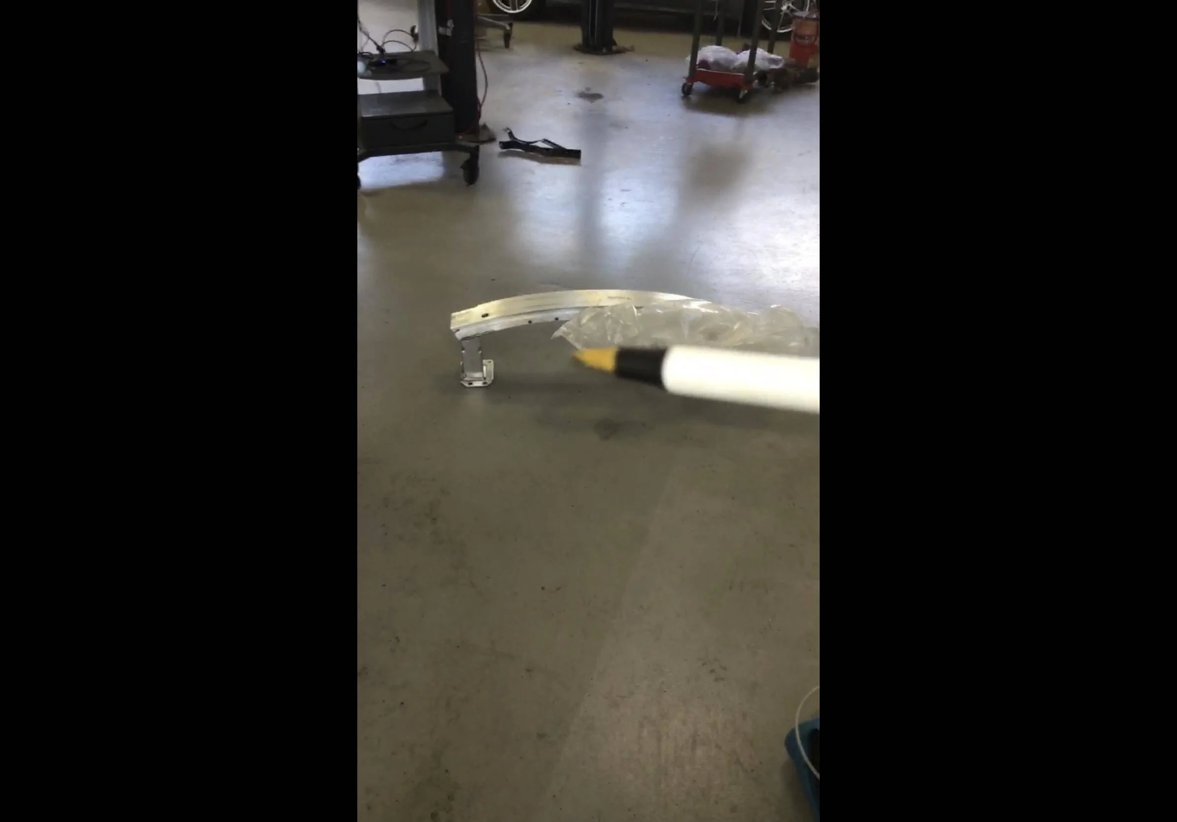

Just had the front bumper recall performed. Scheduled three weeks out timed it with snow tire swap to summer tires.
Recall took one day. However, when I went to pick it up vehicle had many warnings for braking and safety detection. The kept the vehicle another day to download data and found that some wiring or connections where not correct post bumper reinstall.
Adding images of new bumper (interior) they installed.
All good.
Porsche Taycan Front Bumper Recall in USA IMG_5550
Porsche Taycan Front Bumper Recall in USA IMG_5552
Porsche Taycan Front Bumper Recall in USA IMG_5553

How can it even get to the point of handing a car back to a customer without checking there aren't a load of warning lights on? P1ss poor.
REIL
Rick
Dec 8, 2020
345
305
West US
Taycan 4S+ / MY20
They said when they drove it post bumper no warnings. I had them place it on their level 3 charger so it would be ready for me. Unplugged and instantly had 3 warnings scroll through drivers screen right side.
They quickly gave me the 2023 Macan T loaner I had originally.
No big deal my dealer is really great to work with. Service two vehicles with them.
They offered to deliver my car to me the next day. 45 miles away from dealer.
I collected the vehicle at dealer just in case.
All good now.
