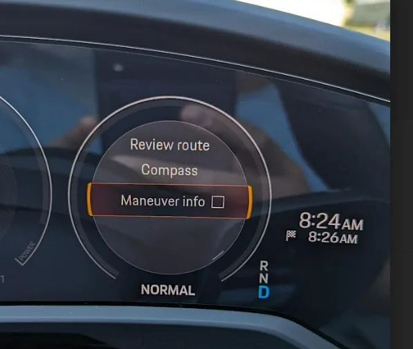

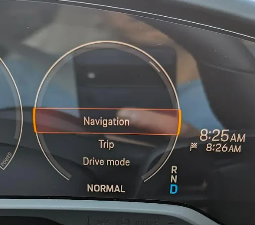

SOLVED: Turn by turn navigation pop up in the right (3rd tube)
@or1
@magnitude
I am going to be showing off here as a rookie owner who solved this very annoying problem on the first solution drive and second drive of the car overall. This is not in the manual to be fair as I had plenty of time to read it over a 2 year period when I started dreaming of owning the Taycan.
Problem: Navigation turn by turn (official name of the feature is Maneuver Info) pops up and goes away when a navigation event is upcoming. Can be dismissed with a Back button, but annoying distraction if you do not need it, as Center screen shows this info just fine. My annoyance of this is because I want to see my Information data in the right tube to monitor the HV battery temp going up without distraction when I am navigating to a Charger.
Solution: The most obvious thing is certainly to dig into Center screen Map/Navigation options but there is nothing there. However, we all know there are Options hidden under items in the Instrument cluster for certain features when they are active or shown. So I dug into them and what do you know Maneuver Info is a CHECK BOX, thank goodness they thought of this!
1. Navigation must be in scope for the Instrument Cluster
2. Select Navigation in the 3rd Tube.
Then the Navigation turn info will become active (not pictured).
Porsche Taycan Funny little things that drive me crazy | diva safe zone 1688735162323
3. Now the killer Rookie move, this feature has Options underneath that look like this.
Uncheck Maneuver info and the pop up no longer will be happening in the right tube, but still showing just fine in the Map/Nav view on the Center screen where it should be! Now you can decide if you need to see the turn-by-turn Maneuver or NOT! I would be totally fine seeing it if I am just navigating normally, but I do not want to see when I want to monitor HV battery preconditioning real time.
Porsche Taycan Funny little things that drive me crazy | diva safe zone 1688735254716
