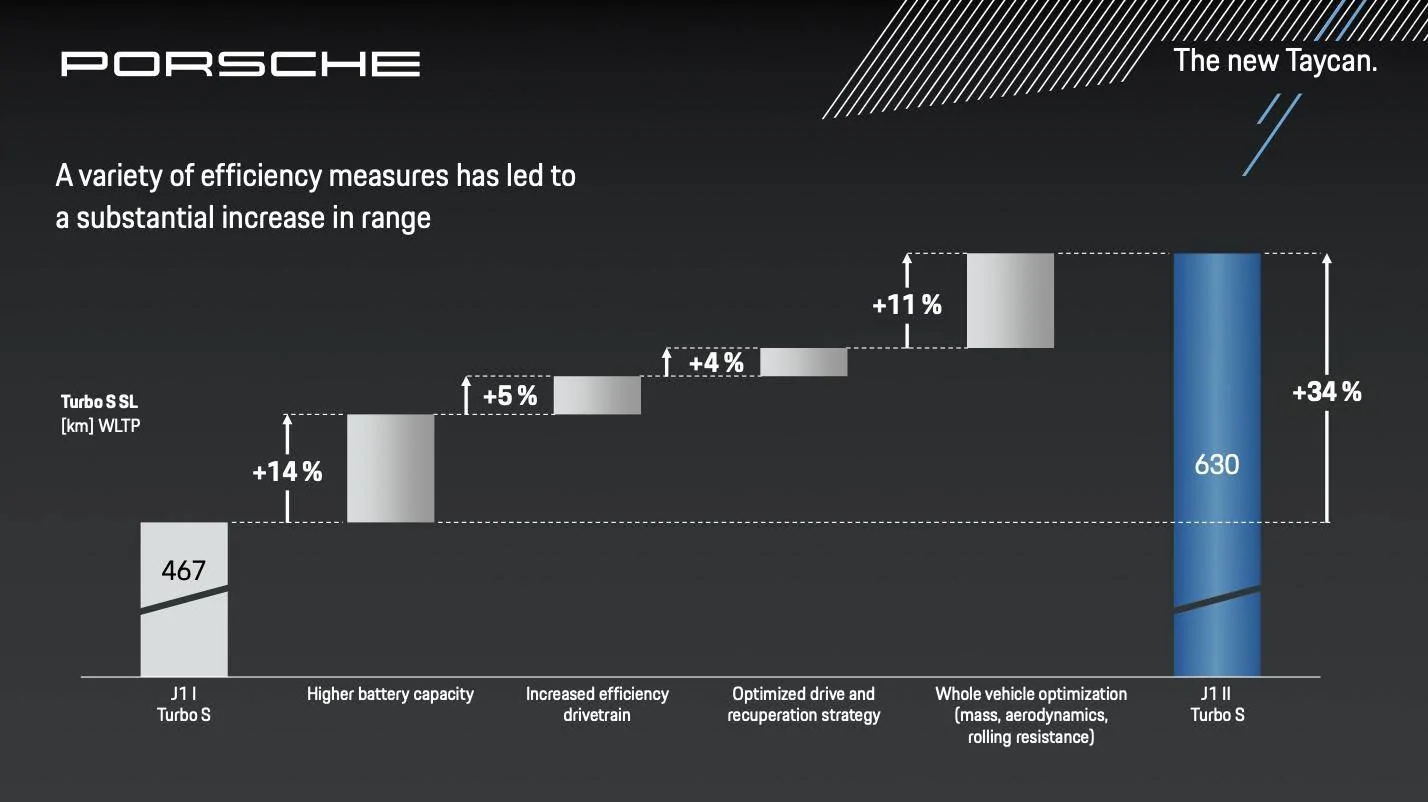

Interestibg for sure but marred by using WLTP as a measure which is lab based and wildly optimistic.
Is there a real world example...I'm guessing not?
I'll settle for the larger battery as the main (obvious) reason.
this is a % difference, the base will likely be WLTP too. I'm now 17k miles in J1.2, driving the same daily routes as my J1.1, the efficiency gains are real and comfortably +15%

How do you know it is the efficiency gains but not the battery size?

I have a gen1 rwd PB+ and got a gen 2 PB as a loaner for a week, which on paper should have a longer range, but did not feel this is the case at all. I suspect most of what Porsche calls as “overall efficiency gains” in the chart above is the removal of their own sandbag with the first gen official range. My personal guesstimate of the real world difference between gen 1 and gen 2 is about 15-20% and great majority of that improvement seems to be battery size and rest (max 5%) due to uglier headlights, uglier wheels and maybe some slight efficienty gains from new motors.

I noticed that rolling resistance and aero was almost as much of a factor (11%) as the battery (14%), so are there different tires on the J1.2? If so, that could also be something that the J1.1 owners could take advantage of. That and the more aero wheels with a bigger battery and the J1.1 should be very close to the new range. Maybe?

All J1.2 cars have PB+

There are some more range optimized 21" wheels. They have Hankook iON tyres on them and they are narrower (same width as a 20" wheel). Porsche does not recommend them for the track, but claims that they increase range.
Specifically they are available for the Turbo S. So I am sure that because there's the Turbo S in that graph, then the rolling resistance part of it, is due to those wheels.
Aero however is a different story, I think they squeezed a little more out of the body.
The part number is 9J1073663AA.
245/40 R21 in the front and 285/35 R21 in the back, whereas the normal width 21" have 265/40 and 305/30 accordingly.

Not sure what you mean. This is not true for RWD and 4S. PB+ is still an option for those.
Not in UK all J1.2s have PB+ and can't imagine NA or RoW any different- this was one of the key facelift changes...hence the extra range.
