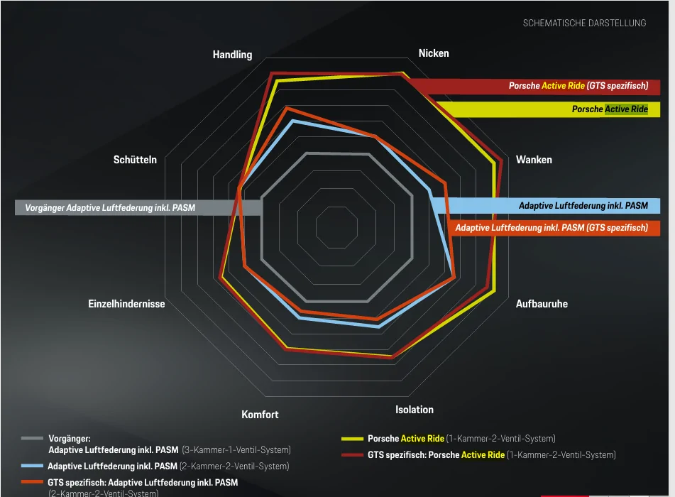

d00d
Mar 7, 2024
553
373
4MB, HYA
yes
If you're ordering this, I would think PAR would be part of any build.
The graphic from Porsche that mpaulus007 posted shows very little difference between GTS and other trims, it's then essentially for the Race-Tex.
No need for Race-Tex, then go for a 4S and 21" summer tires (Dynamic Pack not available), drive in Sport or better.

dcp10
dcp10
Feb 5, 2026
74
Oxford, England
Porsche Taycan 4S Black Edition with Active Ride • Tesla Model 3 LR AWD
That's helpful, thanks. Anyone know what "Nicken", "Wanken" (no sniggering at the back please) and Schütteln mean please?
Google translate isn't very helpful here…
nicken = "nod"
wanken = "wavering"
aufbauruhe = "rest period" ?!
einzelhindernisse = "individual obstacles"
schuttlen = "shake"

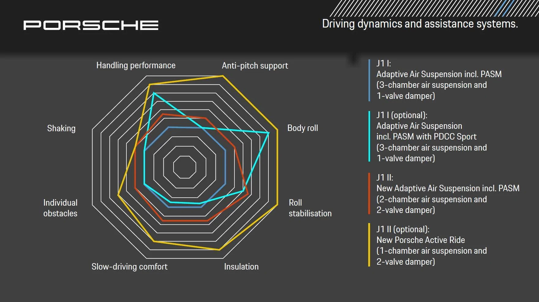

d00d
Mar 7, 2024
553
373
4MB, HYA
yes
Right, but drive both with 18-way and 21" same tires, is there then much of a difference that drive mode doesn't equalize?
For English, compare to what Boss Hogg posted.

RED!
Stu
Jan 15, 2026
243
93
Toronto
'24 ST GTS, 996 GT2, 87 Turbo Cup car, 04 NSX
This is a great indication of feel, imo.
The “isolation” measure feels to me like the diffeeence between a sports car and a luxury sedan.
I’ve read/watched people talking about how the ride is better than an S-Class. Again, it’s a matter of taste, but I’m looking for an estate wagon that feels like a two seater (a shooting brake) not a sedan that handles well. This is where this thread gets into trouble - perspective on this drives all other variables
