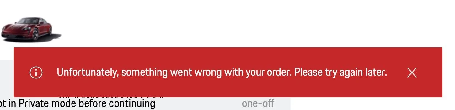

I have ordered ALK from the Porsche Connect Store but the website keeps telling me activation in progress, says it can take up to 10 minutes but it's been stuck on this for almost a week, frustrating to say the least.

It is advertised and it DOESN'T work.
I've tried FoD for the past 4 weeks, and I get this error:
Porsche Taycan Has anyone successfully updated a FOD for their Taycan? _P2
And it is a fallicy to assume that just because something is "advertised" that it is going to work.
Diet Coke was advertised as guilt free and now is linked to obesity. Thousands of other examples exist. Shall I continue?
Make an appointment with the PC. They can fix it.
I had the same, everything worked after a visit to the PC.
