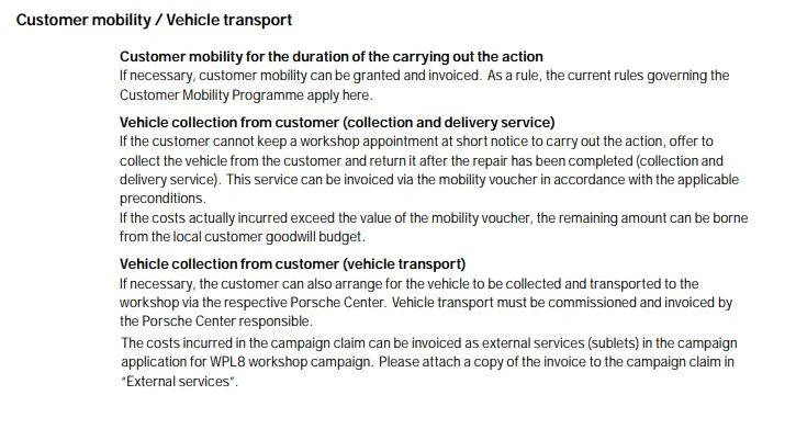

Per TSB for campaign WPL8 heater replacement, labor time for the replacement is 6.7 hours, and not only are dealer costs for loaner reimbursed by PCNA, costs to pick up and return the car could be included also:
Porsche Taycan Heater broken. My turn. 1714430387976-33
https://static.nhtsa.gov/odi/tsbs/2023/MC-10246451-0001.pdf
Super helpful, thank you! I didn't see the campaign listed in the email, nor was there an open recall listed anywhere for my VIN, so I wasn't sure if it was all under the same TSB. Cheers for the confirmation!
