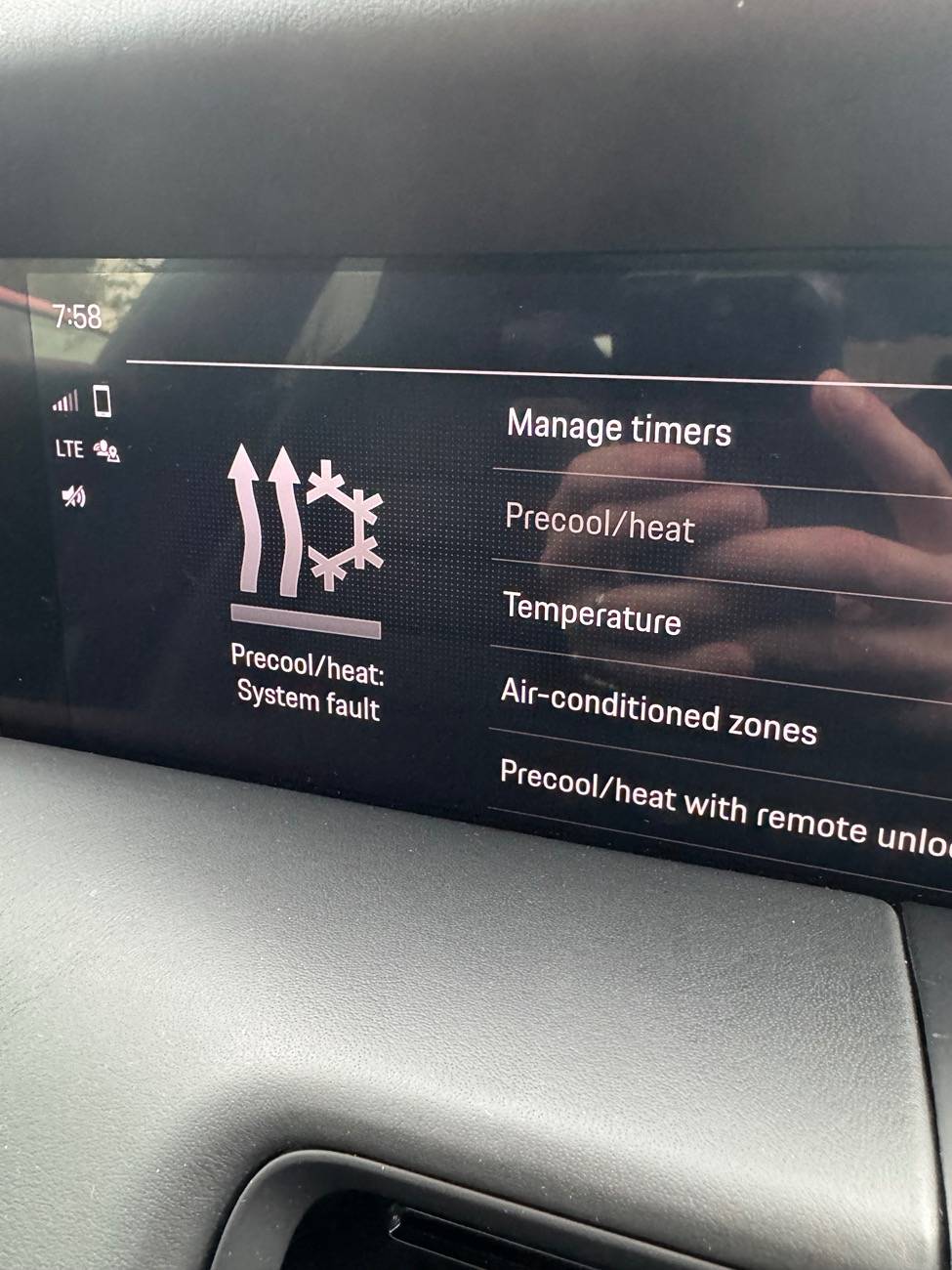

Do you guys know if anyone mentioned in the other "heater problem" threads if the heater can break again after repair/replacement? Or the new version is a "permanent" (as far as they know) fix?

Just fyi, my car lost heat a couple of weeks ago with the same system preheat error as above, service said it may not be the heater (they actually said it's probably not the heater). Apparently they've seen this error with other parts failing, so it seems Webasto is not the only unreliable cabin heating part Porsche is installing in their cars (my car is not even 3 years old, on second heater, 17K miles on the odometer, garaged all its life, very mild winters except for one trip). Car going into service later this week, I guess I will find out.
I think the error is the same for any of the many failing components of the heating system. The code will probably be different.
