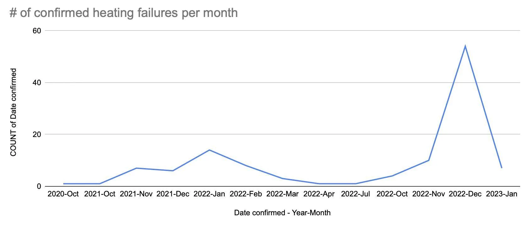

Heating failure (no defrosting or defogging) is a safety defect in USA.
So far only 5 Taycan heating failure complaints to NHTSA. US Taycan owners must be OK with it.

Read the forum and the list of occurrences on github, and you will find a number of owners who have had repeated heater failures on the same car. A 2023 Taycan built in November 2022 and delivered has to have its heater replaced. Has the fix done on your car, and mine, fixed the problem, or will we have it happen again?
No heater does not mean fogging will always occur in cold weather. Fogging occurs when the dew point of the air in the car (humidity) is higher than the temp of the windshield. There are conditions in which clearing the window with cold air will not defog the windows. Read forum posts by owners who have had this occur.
Heaters are failing, and being replaced, in Taycans in model years from 2020 through 2023. Instead of determining the root cause of the problem and proactively fixing the causes, Porsche is waiting until they fail and letting owners and service departments repair them in the field.
Complaints to NHTSA about heating systems failing in Teslas got the NHTSA involved and a proactive response by Tesla.
Attention/interest from regulators will help motivate Porsche to provide proactive response to this now 4 year old continuing safety defect problem.
