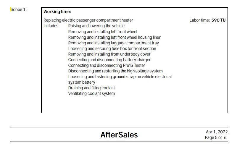

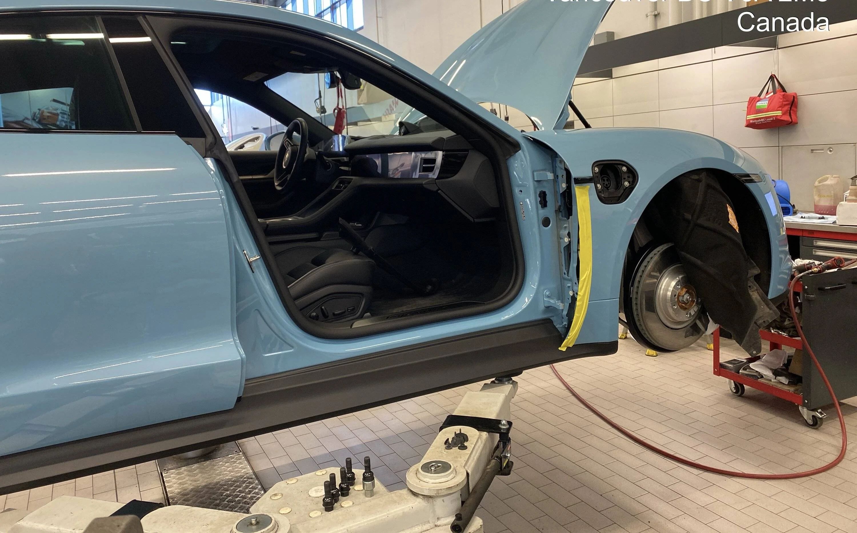

Does anyone know how invasive the heater replacement process is?
To replace my charge port door mechanism, they had to completely remove the front passenger door and front passenger wheel.

I'm bring my car in on Tuesday. I don't like the idea of my car being taken apart, but I don't have a choice.

Wow thanks. Removing the wheel and wheel liner sounds easy. Don't know about disassembling the luggage compartment tray and removing front underbody cover.
I ask because Tesla once had to disassemble the interior of my Model 3 and they royally f*cked it up. Had to bring my car back multiple times and have them reimburse me for multiple damage.

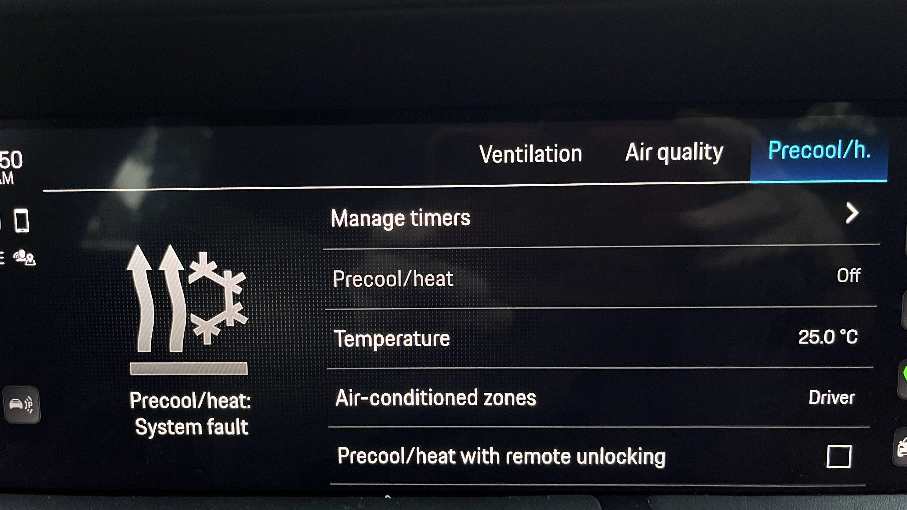

The AA told me the car would fail an MOT without de-mist capability - that's how they seemed to justify immediate recovery and bypass the man-in-a-van. Incidentally, as soon as i confirmed it was a Taycan they asked 'is it the heater'? I said how do you know. Reply: my last call was the same issue. Regarding warnings - this is all i saw...
