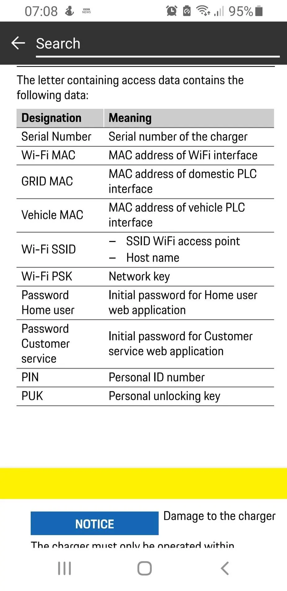

11,073
6,854
In the envelope for mine, there were instructions to dampen the paper with water to read the obscured PIN and PUK. (No, I don't know what PUK means.) I took a photo and then returned the document into the envelope after it dried.
These are not the passwords or user accounts to use, as mentioned.
Accounts are either Customer or Home and are preselected for you.
On the paper both accounts and their passwords are clearly visible.
The PIN is set by the user.
PUK is the personal unlocking key if you forget your PIN.
Porsche Taycan Help needed....! How to access PMCC Web App? Screenshot_20210708-070802_OneDriv
