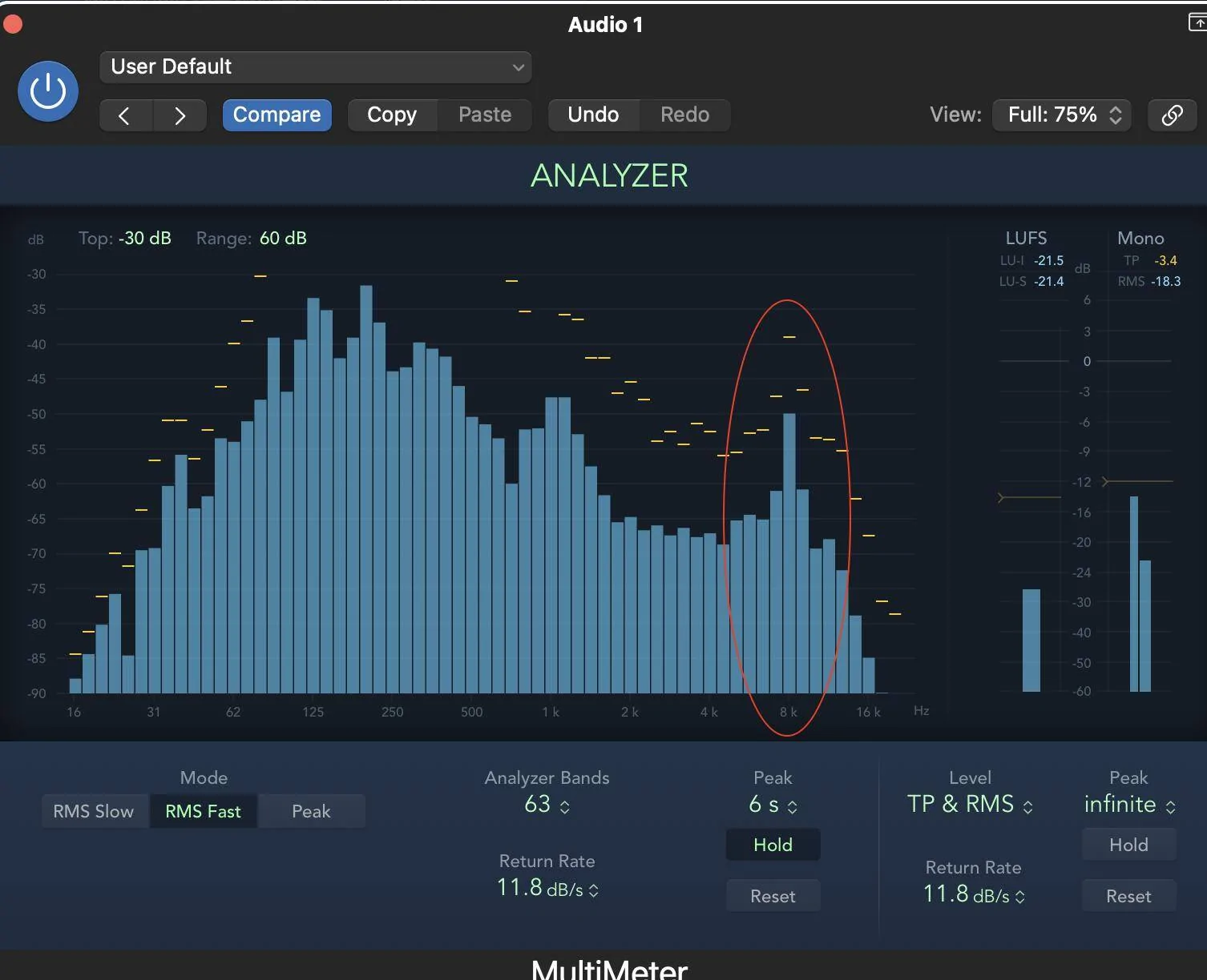

+1 the same sound, happens between 10 and 20MPH, braking and accelerating. 2020 Turbo. Totally wrecks the enjoyment of how 'quiet' the car is otherwise. Has anyone heard of a fix, or better had an actual fix of this? Mine seems a little worse in the cold. Tried changing drive modes but nothing helps. Maybe maybe it reduces slightly when I manually switch regen off, but the problem is you cannot switch regen completely off on the Taycan since it's part of how the brake system works. FYI I have PSCB but since the noise isn't from the rotors or pads (99% sure) I don't think brake type matters. The noise is a sharp peak at 8kHz, see below, which to my limited understanding could be the switching frequency of the inverter, but that's all I know since I'm a sound engineer/acoustician. The lower frequency peaks are just background/ambient environmental noise, the 8k is the screech.
Porsche Taycan High pitched noise low speed - light acceleration or light braking Screenshot 2023-11-15 at 8.25.52 PM
