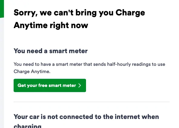

Sorry, I should have said, I already have a 'S2' smart meter installed... (by my previous supplier, Shell Energy). Is this the root of the issue then, that I need an Octopus compliant type smart meter? Therefore the one set up by Shell isn't suitable?
You need any SMETS2 smart meter, so you’re ok there.
The Octopus Intelligent website eligibility checker doesn’t yet cope with Taycan. Since June, all Taycans are eligible regardless of charger make and model. Once you’ve switched you can add and set up the Intelligent tariff using the Octopus app.
The support info on the website isn’t the best/up to date.
If switching supplier, pay off any debt to your current supplier first. All being well you can switch in only 3 days.
I checked compatibility by emailing [email protected] with meter type, car make, model, variant; and although this is irrelevant, charger make and model.
Customer support is patchy at best - both OVO and Octopus. Be prepared to use the member experiences here to challenge/corroborate any suspect replies.
