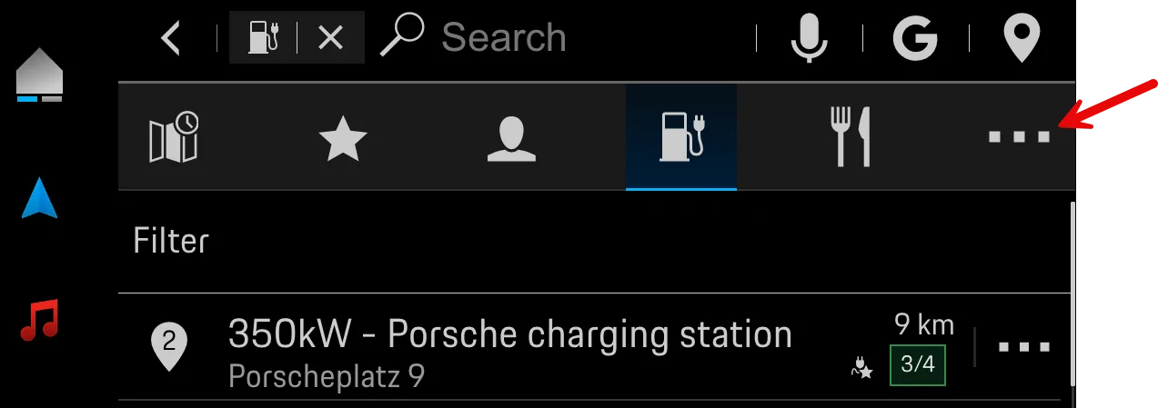

"Prioritise Porsche Charing stations" in nav settings. It will choose the one 8km down the road for you.
Edit: the three dots at the bottom right corner opens the nav settings

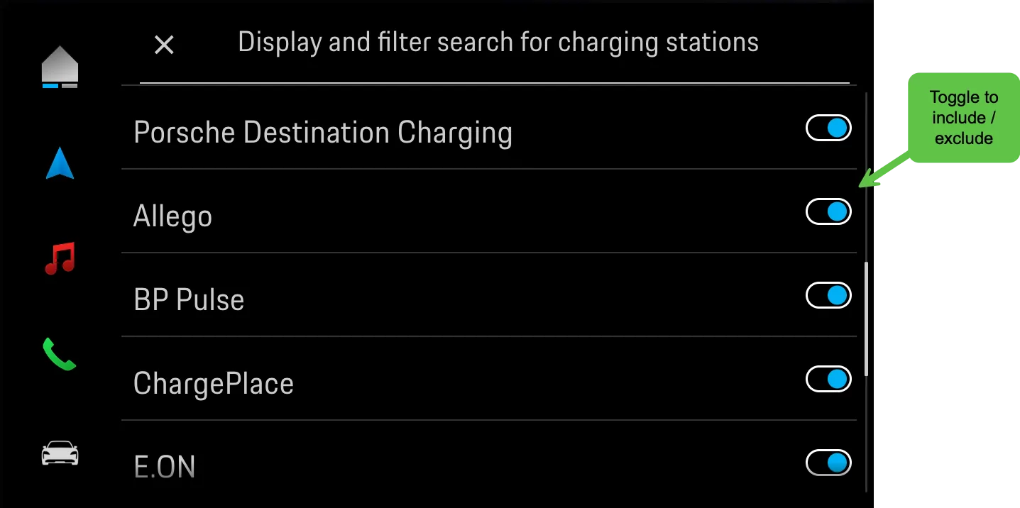

What version of satnav software do you have? You need 3892...it's then in settings and filters...

For route planning you must go to the PCM and within NAV you'll find an option to deselect various Operators who are part of the Porsche Charging Service (which is an option that you can enable / disable). This is a small list of operators and so as I suggested earlier you can't do what you want to do and where you can it is restricted by the current list of signed up Operators - many of which may not be on your travels.

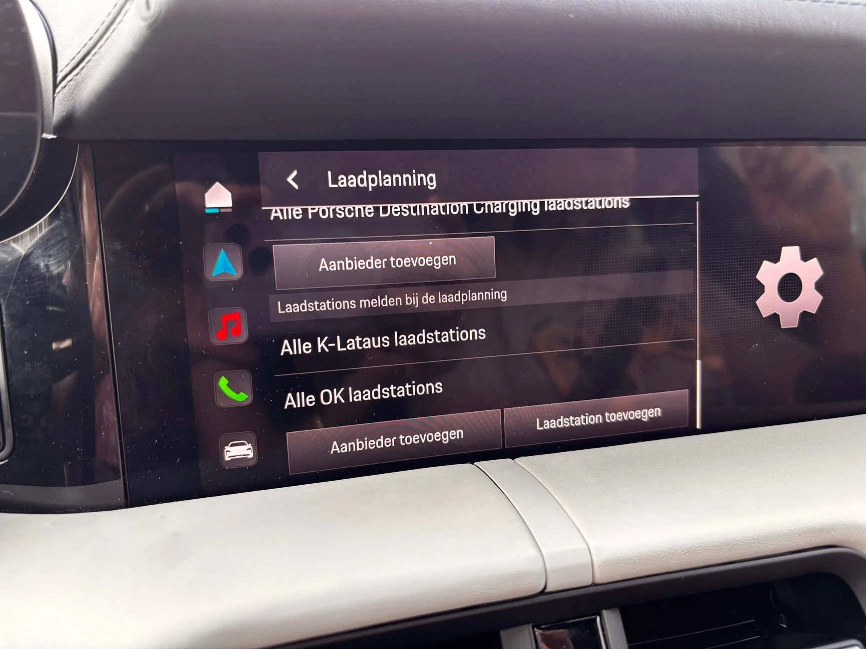

UPDATE: I found it! (Probably)

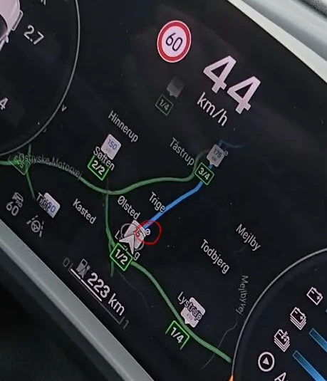

In the menu chargingplanner you cannot only set your preferred stations but also brands you want to be announced in your planning. I entered the two I cannot use in there and today passed this brand twice. It was marked with 🚫.
because I didn’t have to charge I don’t know how it will turn out in the planner, but it looks like this is it

My menu looked very different from your foto. It’s the other 3 dots. It had a ton of brands in it.
this was a sidemenu from the picture i put up. I can add it later on with a pucture :)

How to get to the big list of brands (sorry, don’t know the english terms that well)
- navigation
- 3 dots for settings
- charging planner
- bottom option (announce station in planning) -> add brand
- huge list, you can search there
see video.
