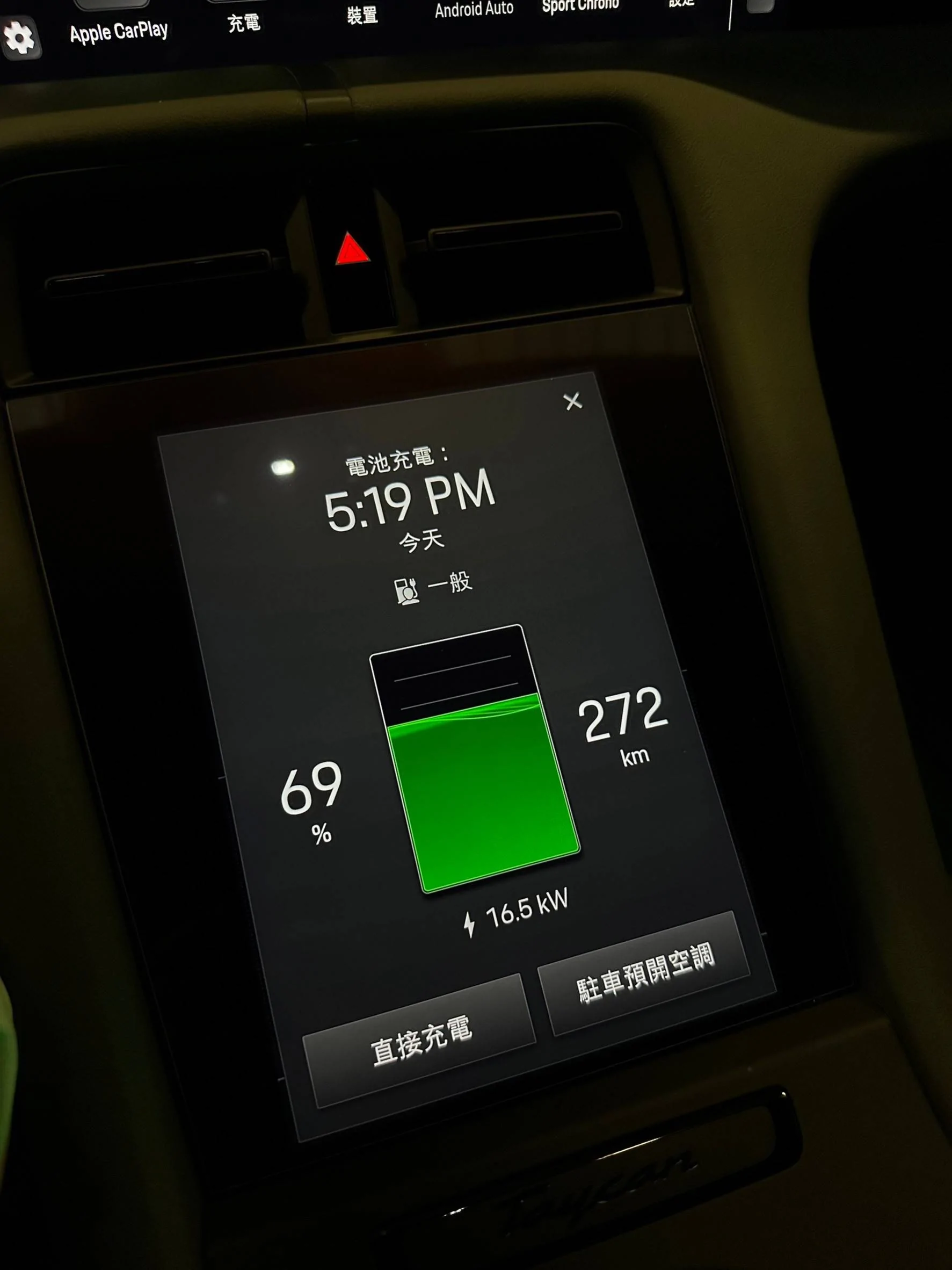

Can the Taycan be set to charge at a specific power level like Tesla?
For example, if the charging station can deliver 11 kW power, but I only want to charge at 6 kW.
Because I've tried to use the 220v/80a AC charger at public charging station, it provide 17Kw per hour with J1772 connector.
But the charging process will failed/disconnect within 10mins, only 3-4Kw has charged into my Taycan. (RWD, MY23)
I checked my vehicle equipment in My Porsche, and I'm sure MY23 Taycan has already equip with 22 kW AC onboard converter.
So I'm trying to reduce the charging power from my Taycan when charging with high power AC charging station to avoid failed.
Porsche Taycan How to limit the charging power within a certain range. S__160104465
