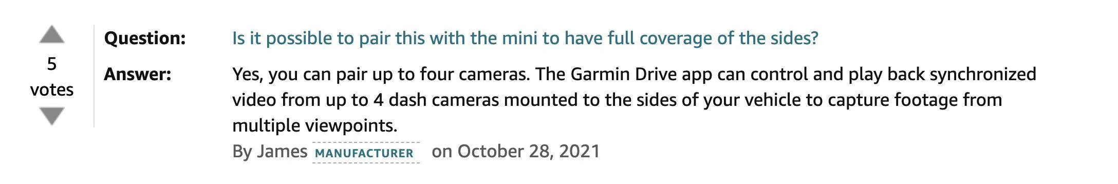

jkoya
Jason
Oct 27, 2021
428
314
No CA
Has anybody had success with two Garmin mini 2’s combined as a pair? One front facing, one rear facing? The only information I can find has the mini 2 on rear and the 47 forward facing. [INITIAL][/INITIAL]
Someone asked this question on Amazon and the response was the app could handle 4 cameras with synchronized videos. Don't know if it actually works or not though...
