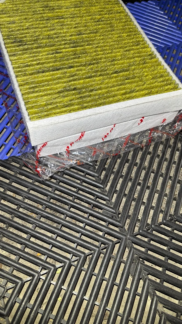

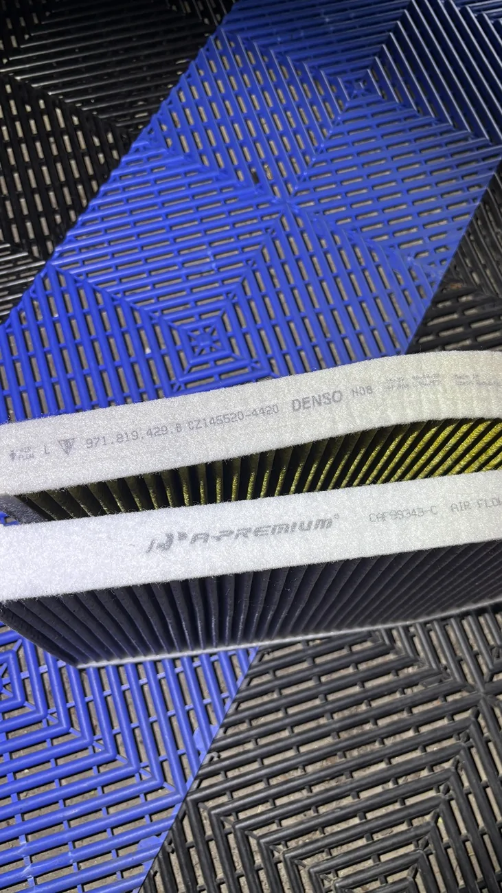

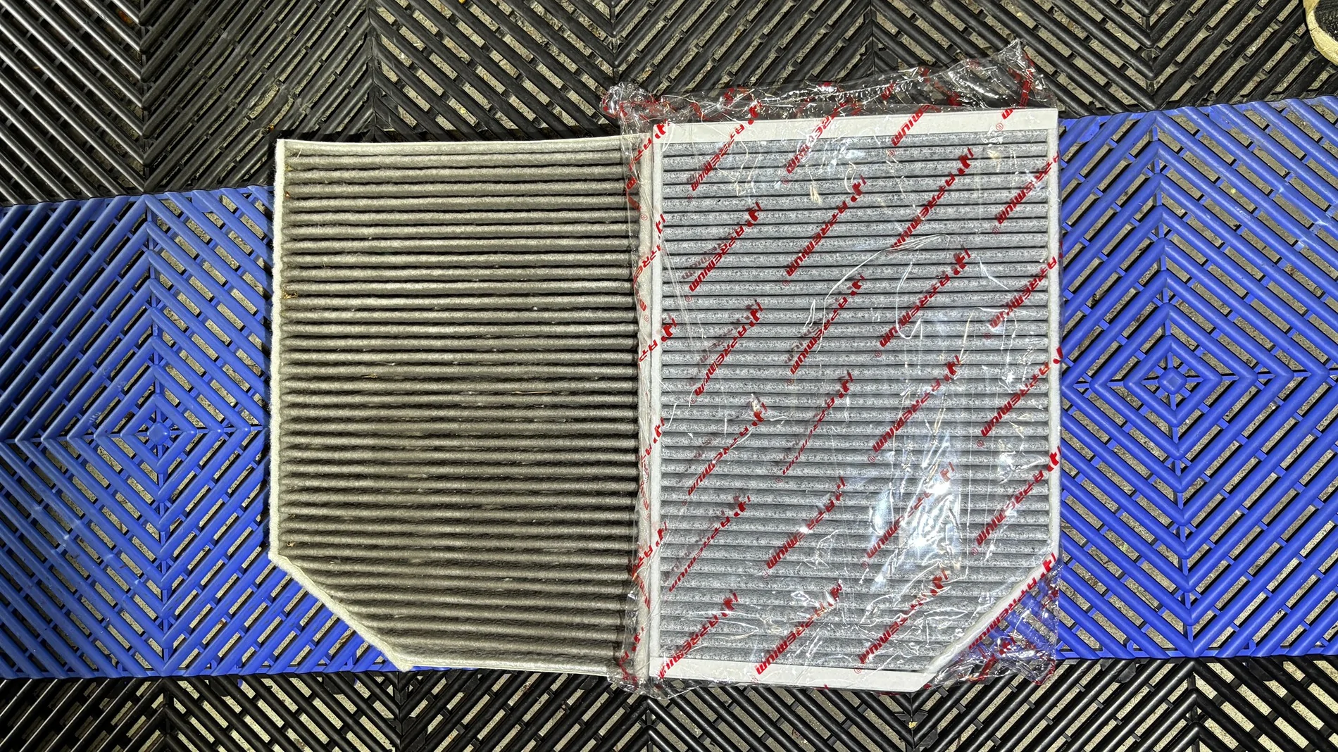

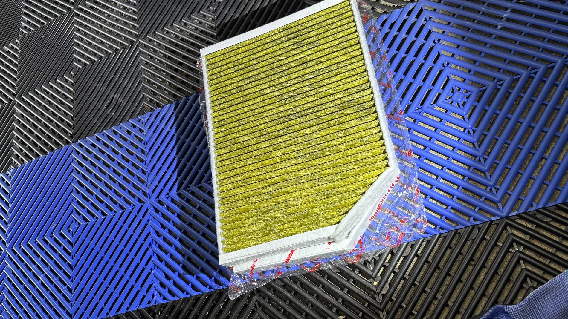

I recently had to do my cabin filter replacement on my car. Thanks to OP for posting these Korean instructions. It really was one of the easier jobs you could do on the car.
Based on the feedback from the forum here, I bought the amazon a-premium two pack of filters. I can say without question that they are a high quality replacement filter. I see no reason to pay the extremely high cost of the OEM filter when these exist.
I snapped a few photos of the a-premium next to the OEM for those who are interested. You will see the a-premium is slightly larger than the OEM filter, or perhaps the OEM filter was squished from being installed for a couple years. Whatever... in any case it made no difference on the fit, I was able to install this in less than 20 minutes. It would take me longer to drive to the dealership!
I hope these pictures help someone make the same decision

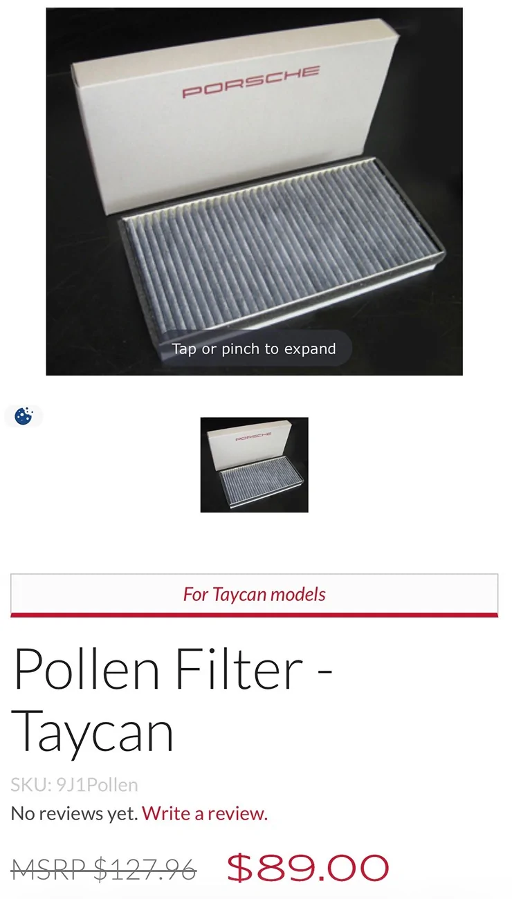

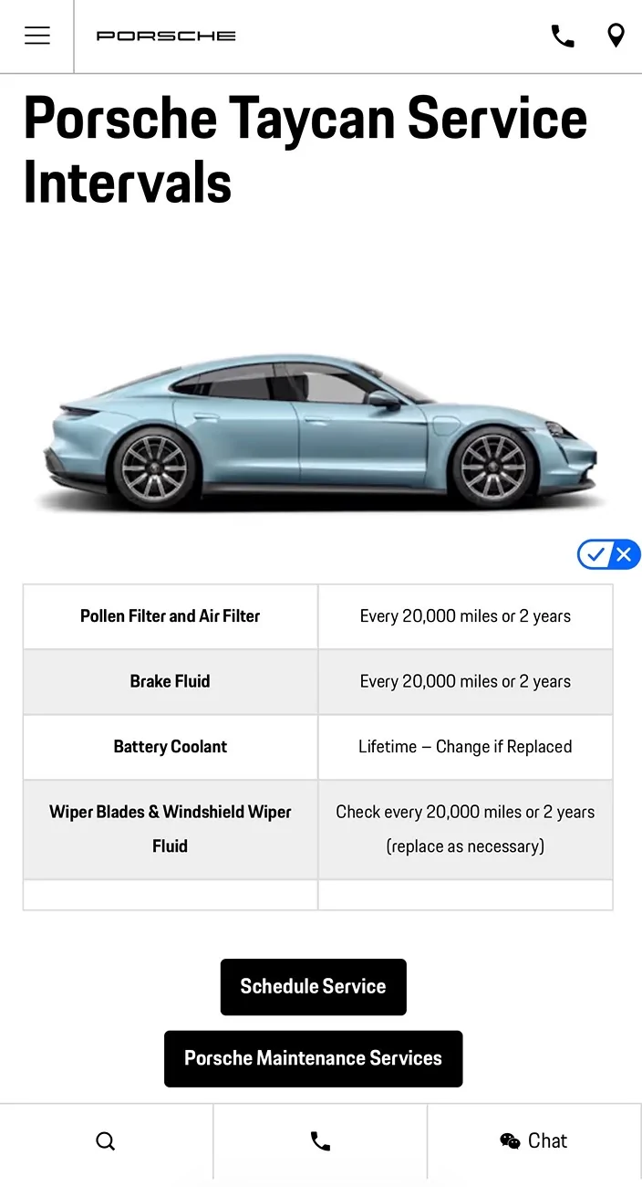

There is also a Pollen Filter that maintenance says to replace. Where is the location of this filter? I can't find any information online about it
Pretty sure the cabin filter is what they’re talking about. It would filter pollen as it filters the outside air coming into the cabin.
I would normally agree with you, but it seemed like they differentiate them. Plus there are Porsches with two filters
There is only 1 and only 1 filter.
It is located under the glove compartment and easy DYI.
I replace mine every 6 months.

Seems like you’re the type that gets easily offended. I can’t help you with that. The cabin air filter is easy to replace. I’ve done mine before. I’m not talking about the cabin air filter. When I go on the Suncoast website, the pollen air filter (NOT the cabin air filter) is shown. When I go on Porsche Riverside’s website for Taycan maintenance, they mention a pollen air filter. I came here to ASK if this is in fact the case. Get off your high horse and help people out. That is what a forum is for as well. No one is trying to confuse, we are trying to learn. Your links to a cabin air filter are irrelevant to my question.
