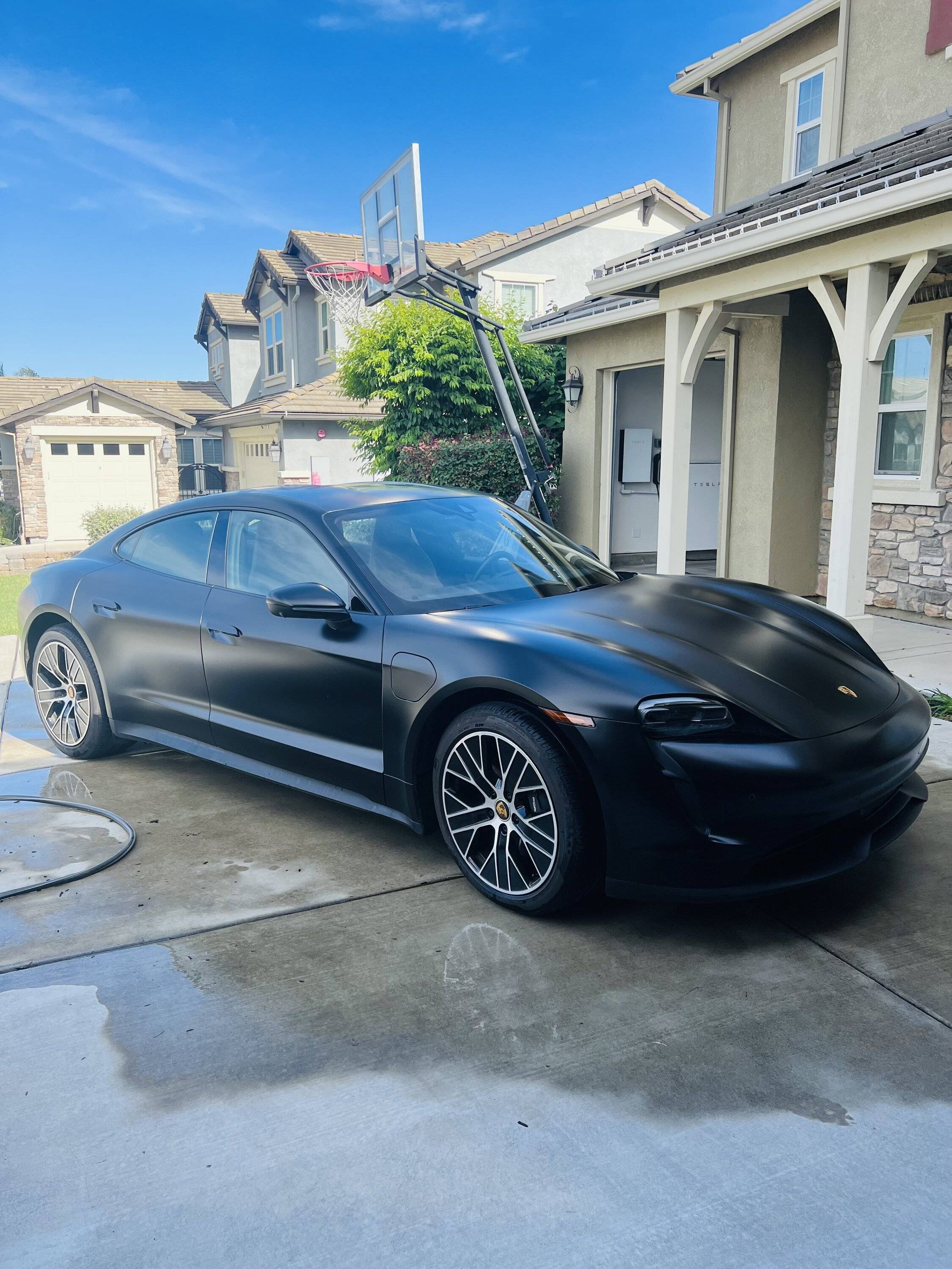

Xpel Stealth PPF which I've had for almost 2 years now. I hand wash about once a month with a home garden hose at low pressure, microfiber hand mitt, and chemical guys satin/matte finish soap. No problems.

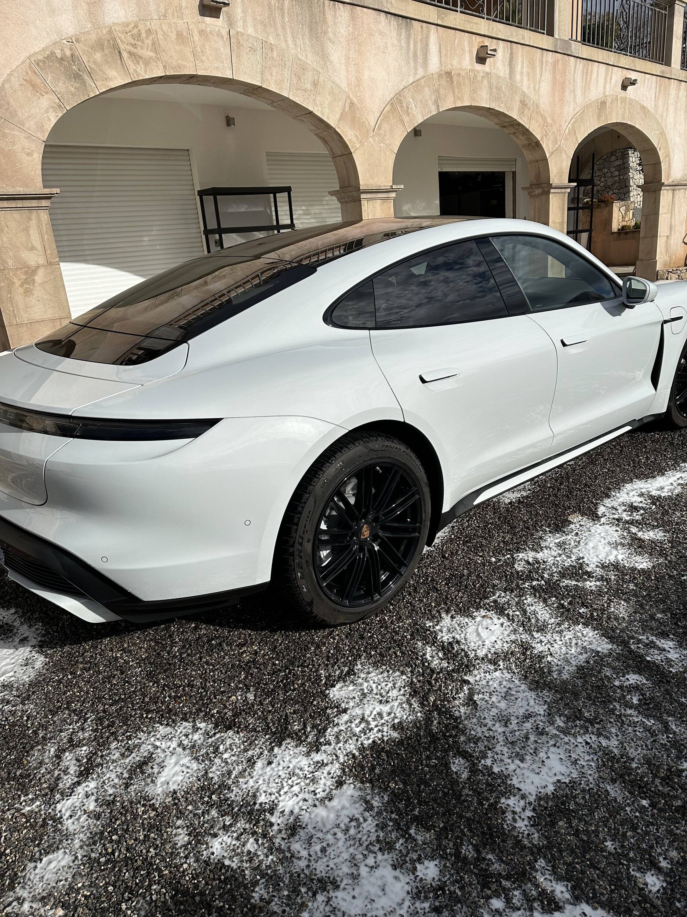

Porsche Taycan How to wash ppf + ceramic coating ? IMG_1241
The wheels are solid black when clean.

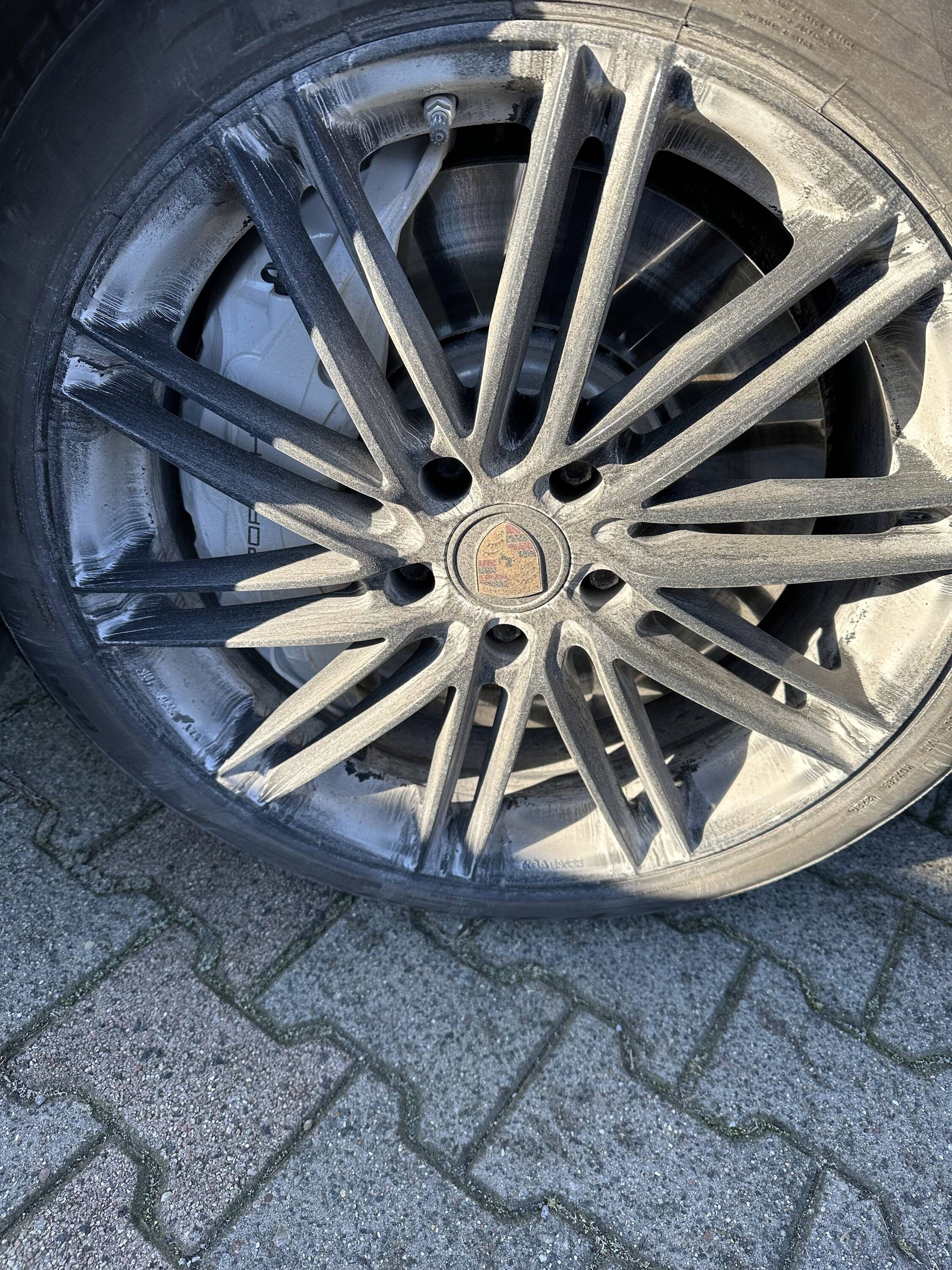

Porsche Taycan How to wash ppf + ceramic coating ? IMG_1246

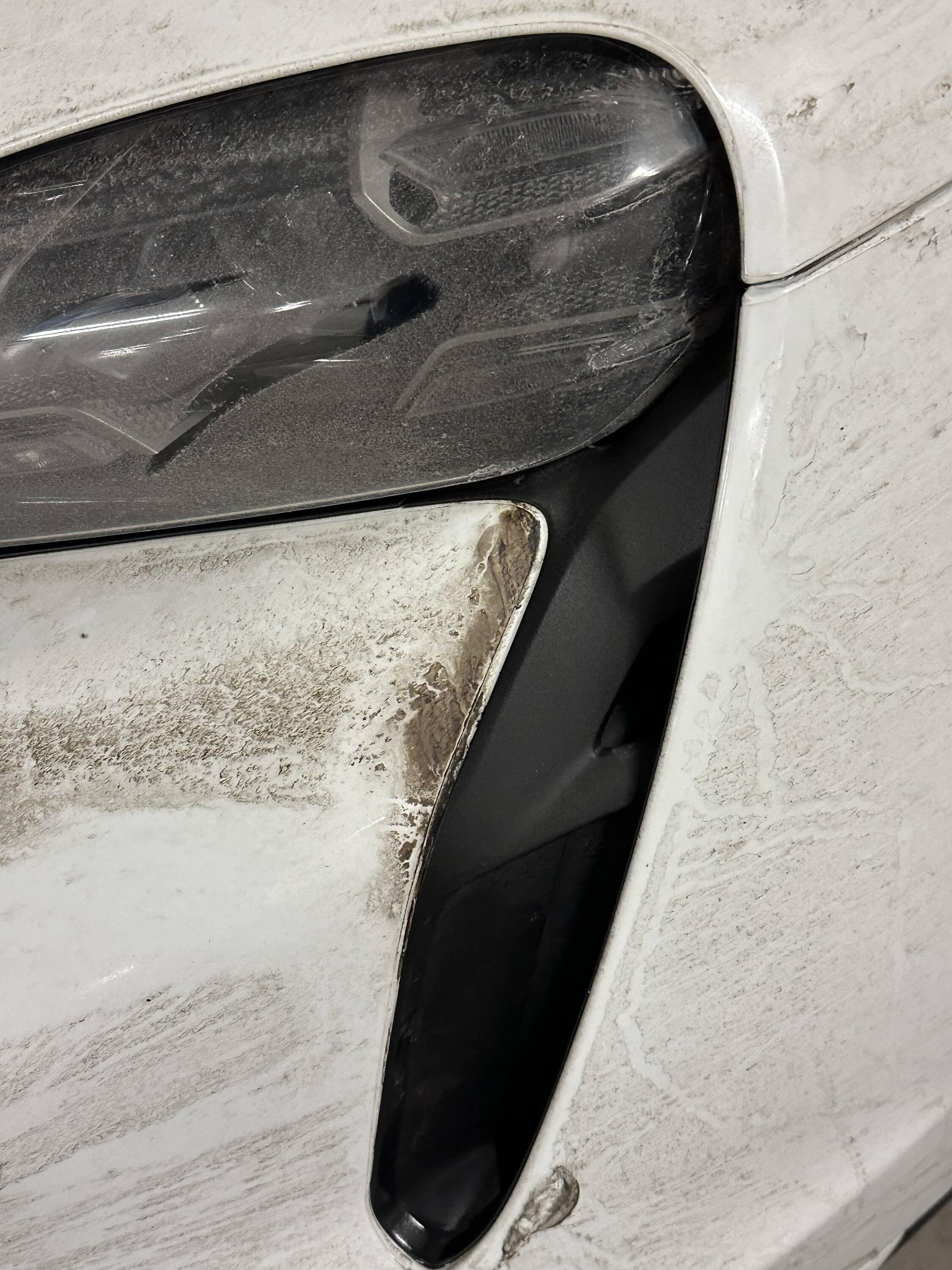

Porsche Taycan How to wash ppf + ceramic coating ? IMG_1230

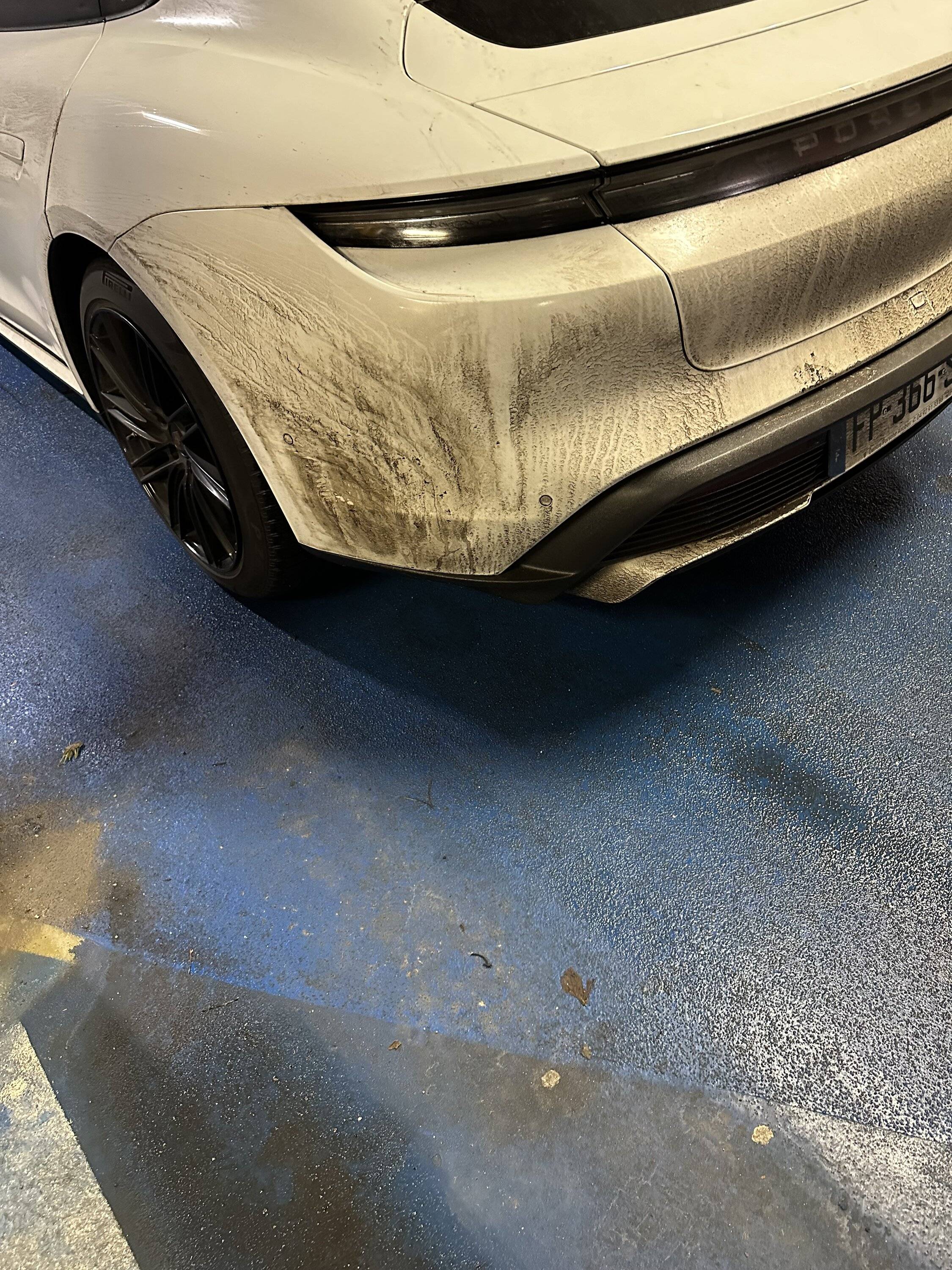

Porsche Taycan How to wash ppf + ceramic coating ? IMG_1290
