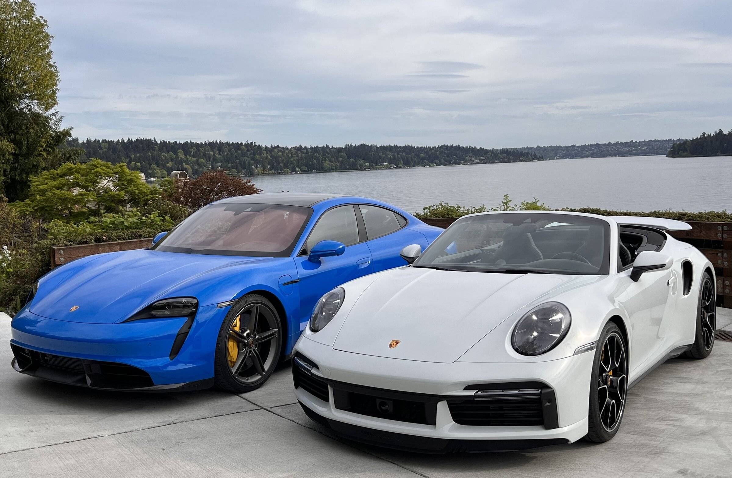

If you just want to protect against rock chips you can do the front end for around $3000USD with a good installer and top rate PPF. If you want to protect the paint from scratches and swirls then do the whole car for around $7500. I dont think you need ceramic on top of current films. Most have it built in. Doing it can add around 1200-1500 in most markets for ceramic.
It think for flat paint doing the whole car is a great option if you can afford it. Prevents microswirls and scraches that are super noticeable in flat paints. If you car is white (looks to be) or metallic, then these micro scratches are hard to see and you can probably skip doing the whole car.
I did my entire Taycan (flat Voodoo Blue) and only the front of my 992 TTS (White Metallic) for these reasons.
Porsche Taycan PPF or Ceramic coating? IMG_1401

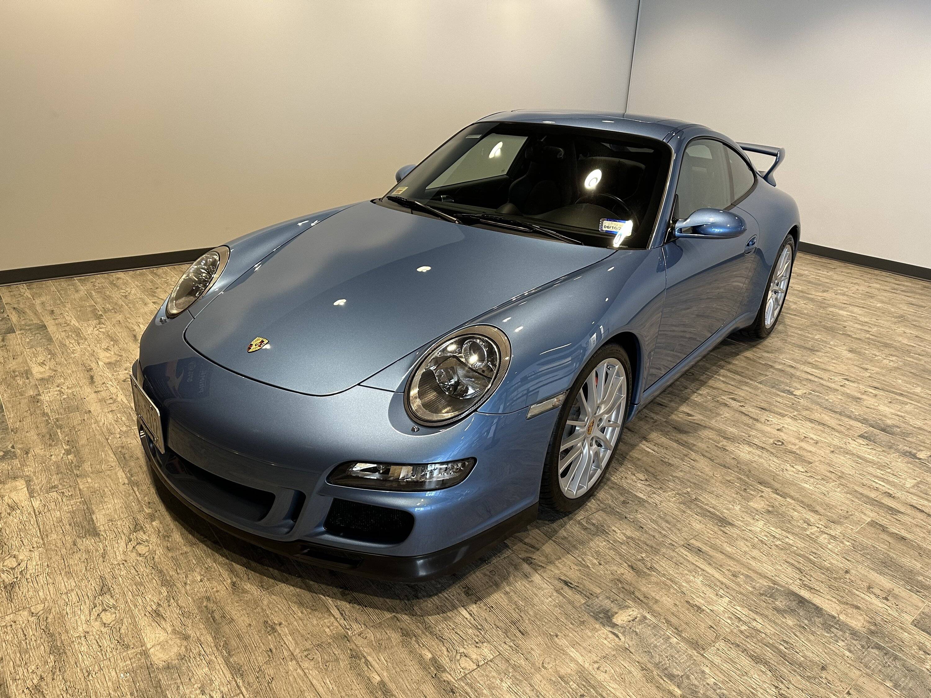

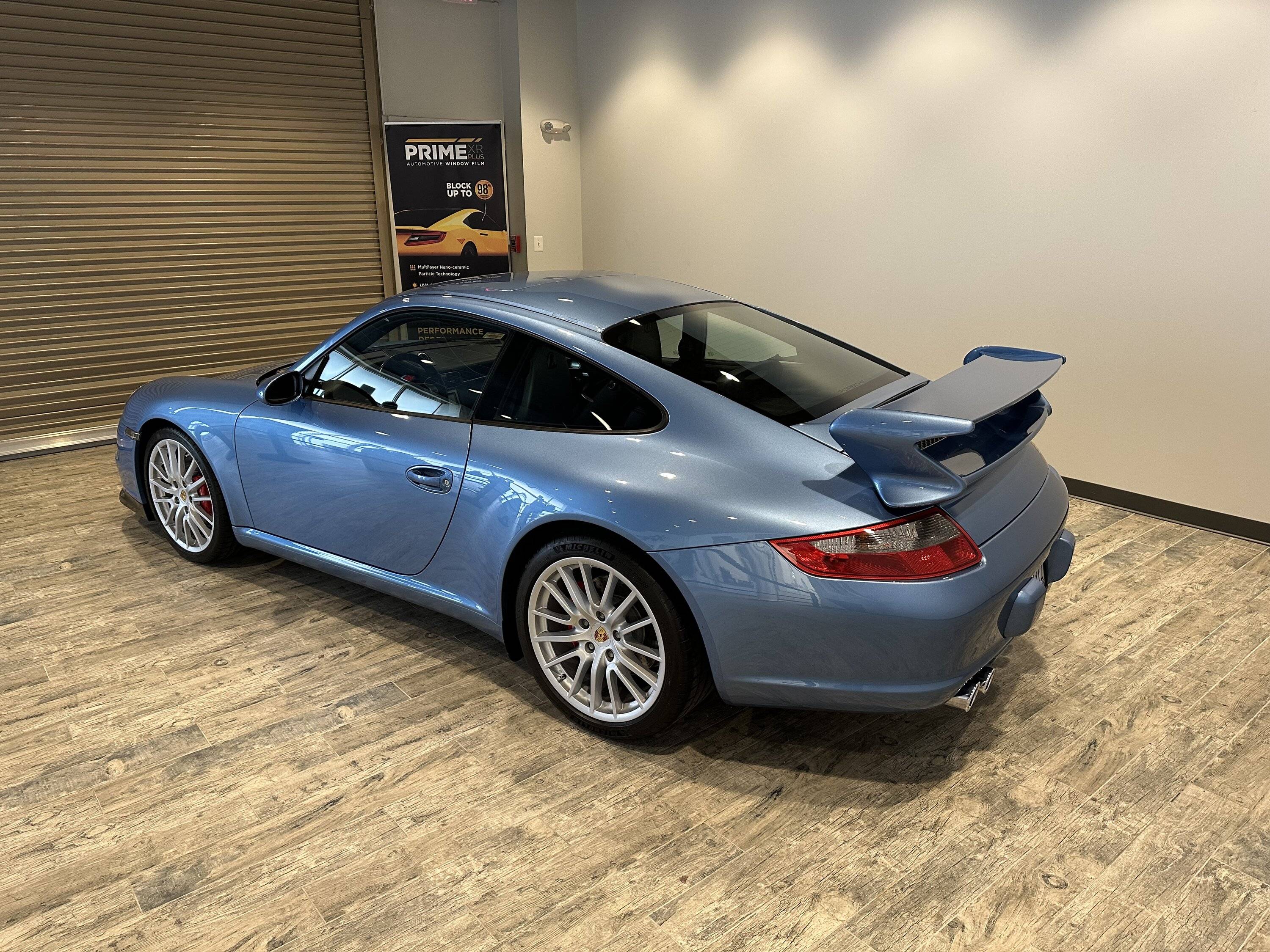

I recently wrapped my entire club coupe from tip to tail with ppf to protect against paint damage from chips, door dings and stupid damage from other accidents or maliciousness. With ppf, you can avoid paint damage/scratches, so the combination of ppf and paint-less dent repair can help you keep oem paint without blemishes.
Porsche Taycan PPF or Ceramic coating? IMG_4305
Porsche Taycan PPF or Ceramic coating? IMG_4301
