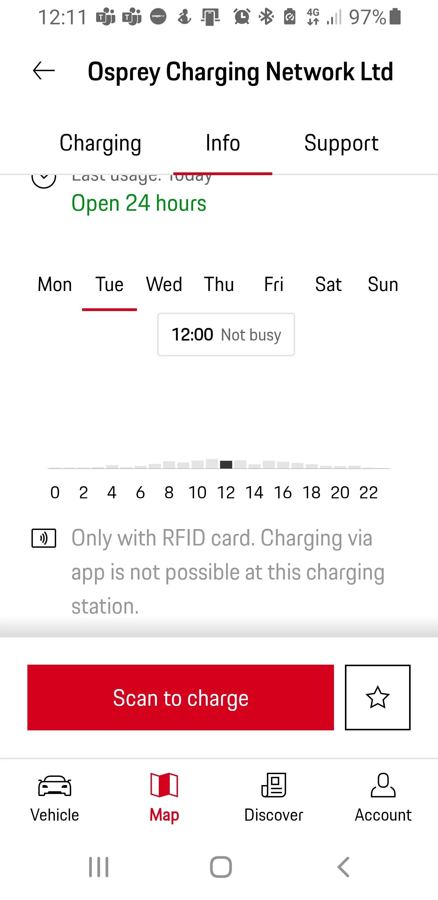

If it is the 75kW EVSE at Haddington then you can only use the RFID card (Taycan card) according to My Porsche App. You can't use the app either to start the session. Should have worked with a regular payment card however.
So feels like a comms issue.
