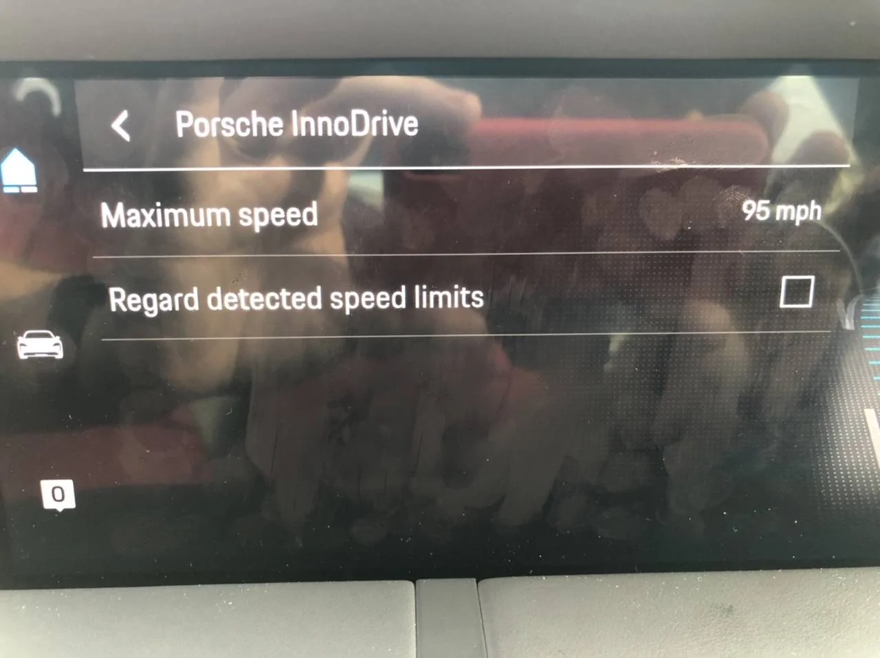

like many I ordered the Porsche InnoDrive, and like many I’ve been underwhelmed. But in addition to being underwhelmed there is a pesky problem with Innodrive in that when on Innodrive cruise control there are occasional “errors” in the speed limit data - this will manifest itself by the vehicles happily going along at 65 mph (as indicated by local speed limits) and then suddenly and inexplicably slowing to 15 mph, shfting into reverse, slamming the vehicles behind you, revving the motor to really grind the dammage into the rear bumper and front grill of the car you slammed into, and then a bit further down the road returning to the posted speed limit of 65 mph (perhaps I exaggerate but you get my gist)…
this behavior has caused me to disable innodrive and “downgrade” to simple Adaptive Cruise control - honestly I don’t know what exactly I’m giving up in this situation, but it irk’s me that I had to do that...
the other day I was waiting for the wife to get us fresh bakery products and I was drilling around in the settings screens in the Taycan (of which there are many)…I found the most interesting setting screen…it’s called “regard detected speed limits” - and it’s “on“ by default - I thought to my self I’ll turn it off and see if makes things better!
I’ll report my findings after some driving experience with this new setting - but I thought I would share for the community - this might make Innodrive less capable of adjusting speed - but I’m also thinking this effectively makes innodrive the same as adaptive cruise control - so I’m still not sure what the exact differences are between Adaptive Cruise Control and Innodrive w/regard local speed limits disabled
