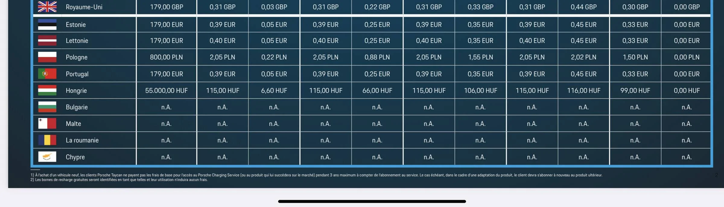

The Porsche Charging service is most likely not available in Romania, together with a few other countries. See screenshot. So I think OP has a bit of challenge to get the rates from Porsche. Probably best to get the Ionity subscription direct from Ionity.
Porsche Taycan Ionity Passport charging subscription ? 2B7E9658-5576-47D5-813C-15EF3728C179
Otherwise it will be a bit expensive.
