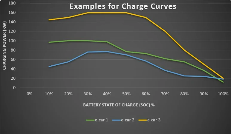

I guess they mean 'up to' (as stated here https://ionity.eu/en/ionity/who-we-are) but as you know there are many variables which will impact a given charging session - battery temp, ambient temp, SOC, throttling, load balancing and so on. No EVSE delivers as 'advertised' in my experience so I guess they're all guilty of a little hype.
350kW will only provide up to 270kW for the Taycan (maximum possible).
This may also be useful (source Ionity):

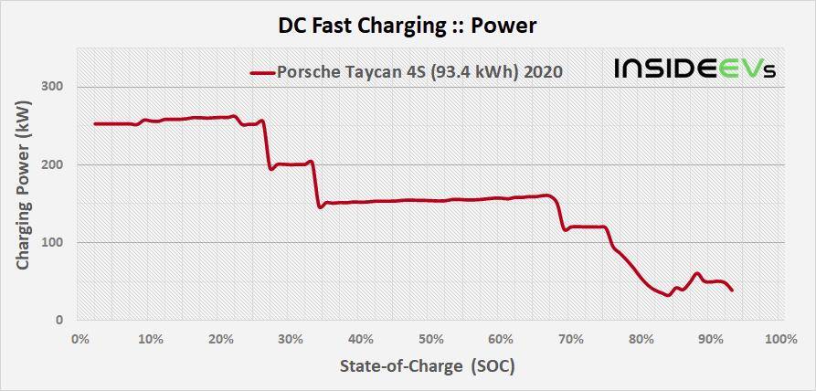

It depends whether it really is the station or the car too though.
If the battery hasn’t been conditioned the car limits the initial charge rate and even if optimised the maximum for a Taycan is 265kW and after about 50 to 60% charged the charge rate starts to tail off anyway. The fastest charging will always be at low SoC levels.
The laws of physics can’t be repealed :)

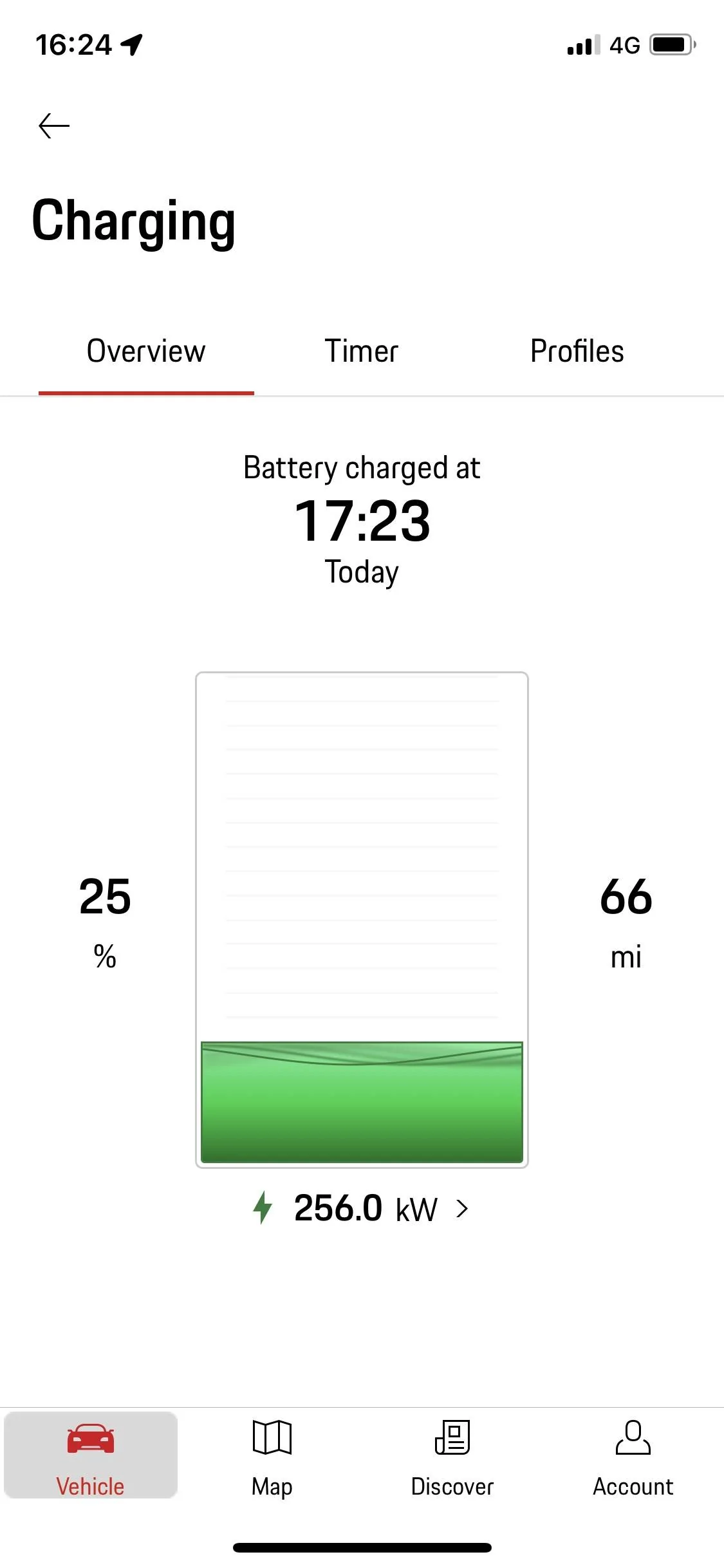

I’m surprised by al all this talk of slow charging speeds at Ionity. If you’ve not unticked the option to have the charging speed governed by the car in order to protect the battery, you’ll get the speed based on battery temp at the time of arrival. Typical speeds I get at Cobham, Chippenham and Hythe can be anything from 60 to 180 kW.
When charging at Cobham on Wednesday I was in a hurry so I unticked the option and got this:
Porsche Taycan IONITY CDAA873F-68BA-4EA6-B4AF-80FC928BD494

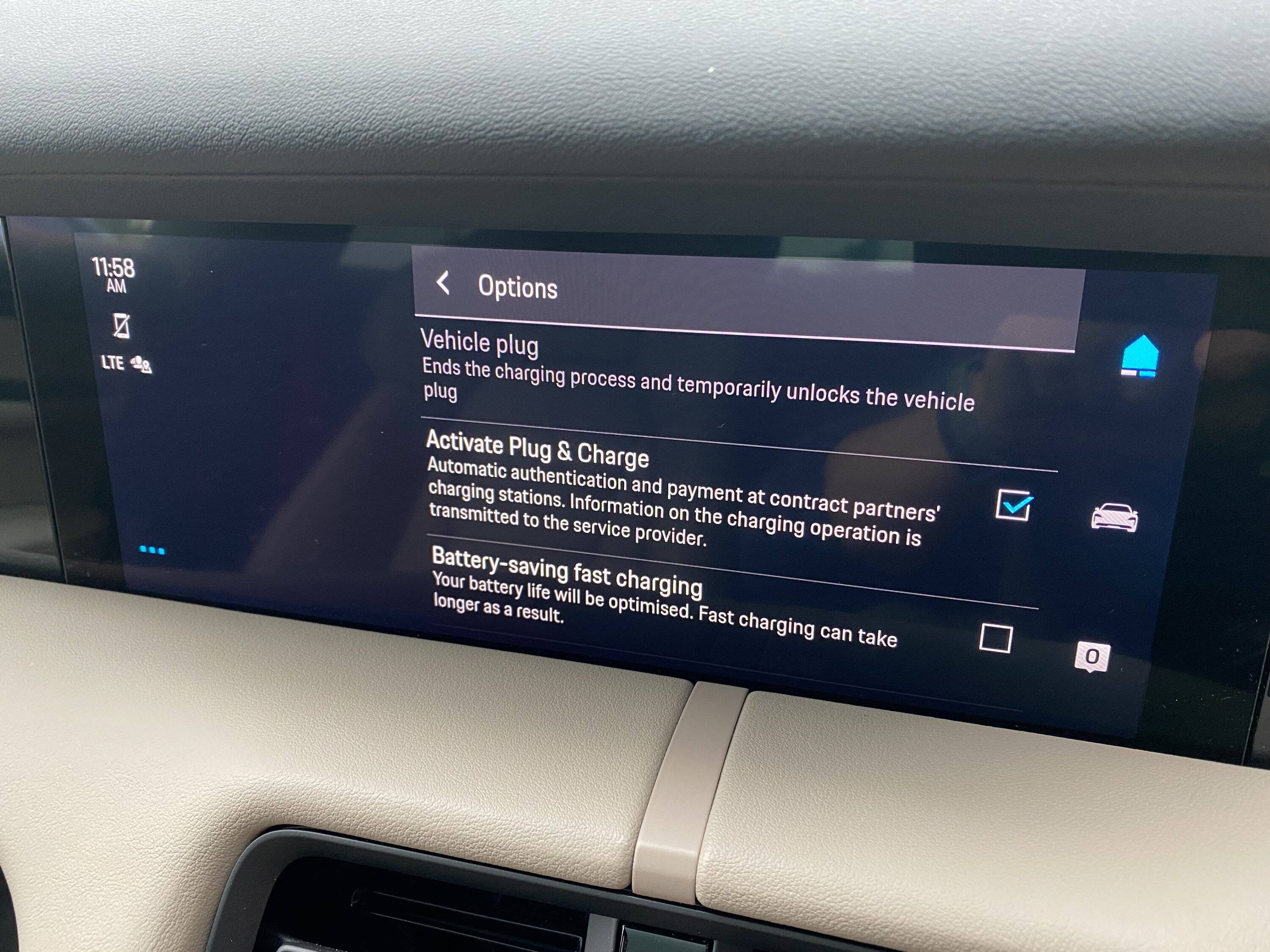

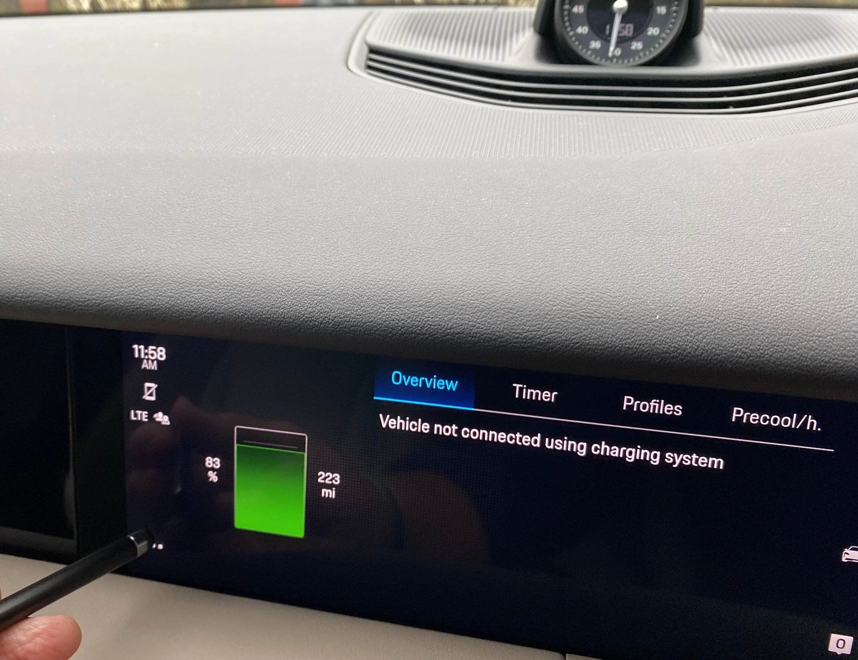

For clarity as to how to find the charging options referred to above, go to charging on the main screen and you'll see this:
Porsche Taycan IONITY IMG_2690
Bottom left of the screen (indicated by pointer) there's a three white dot menu. Click on this and you'll get to the following options screen:
Porsche Taycan IONITY IMG_2691
You'll be ok to keep the 'Battery-saving fast charging' option unticked if you keep to the max 80% charge rule and mostly charge at home on a 7 kW AC.
