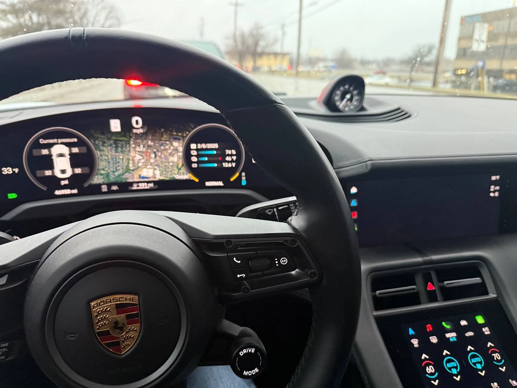

I know this I was big 2-3 years ago - and i think there's a combination of it getting a LITTLE better for me and my just getting used to it
But every once in a while - my PCM just goes black and reboots - all 3 screens (including passenger) but NOT the main cluster gauge screen
Now - it used to freeze the #$%^&*(@%##$ up and i'd have to hit the magic two finger force reboot on the top right, and i'm DEFINITELY doing this less often - but still once in a while
Several things suck about the rebooting:
-um, it's a friggin 6 digit car HELLO, EVERYTHIGN SHOULD WORK
-it takes about 3-4 minutes to reboot - so no music or anything for that time
-normally the hvac will stay on what it was on - so you keep getting the heat or a/c that was on (at least)
-i have a short commute - i have half my drive with no music. blah
So here's why i'm sending this - i have maybe 6 months of warranty left. The last time i was in they did a HUGE PCM update/upgrade/whatever - wiped my settings and everything. They said "maybe this will work" but it didn't
When we all first got these 3-4 years ago the Porsche purists were like STOP BITCHING ABOUT THE ELECTRONICS, IT'S A DRIVER'S CAR AS LONG AS IT DRIVES STOP YUR COMPLAINING. SO i backed off - and i wasn't sure if i saw less complaints because everyone else's stopped doing it - OR if ya'll just got used to it (like me)
But it's seriously not ok to have this happen. it probably happens once every two weeks - maybe once in 40-50 trips - all short in length. Used to be twice a week so hey, it's gotten better
I'm thinking of keeping this car for like 5-7 years - i'd rather have it covered under warranty than not, and my time's a-dwindling for that to happen
And i've told the service guys every time i've taken it in (i'm not horribly close to a dealer) about it with no resolution
here's a vid of it literally happening when i was taking it to the dealer for something else. No judging me for the smudgy/dirty screens - they look fine when they're on and the sun's not directly on them...
