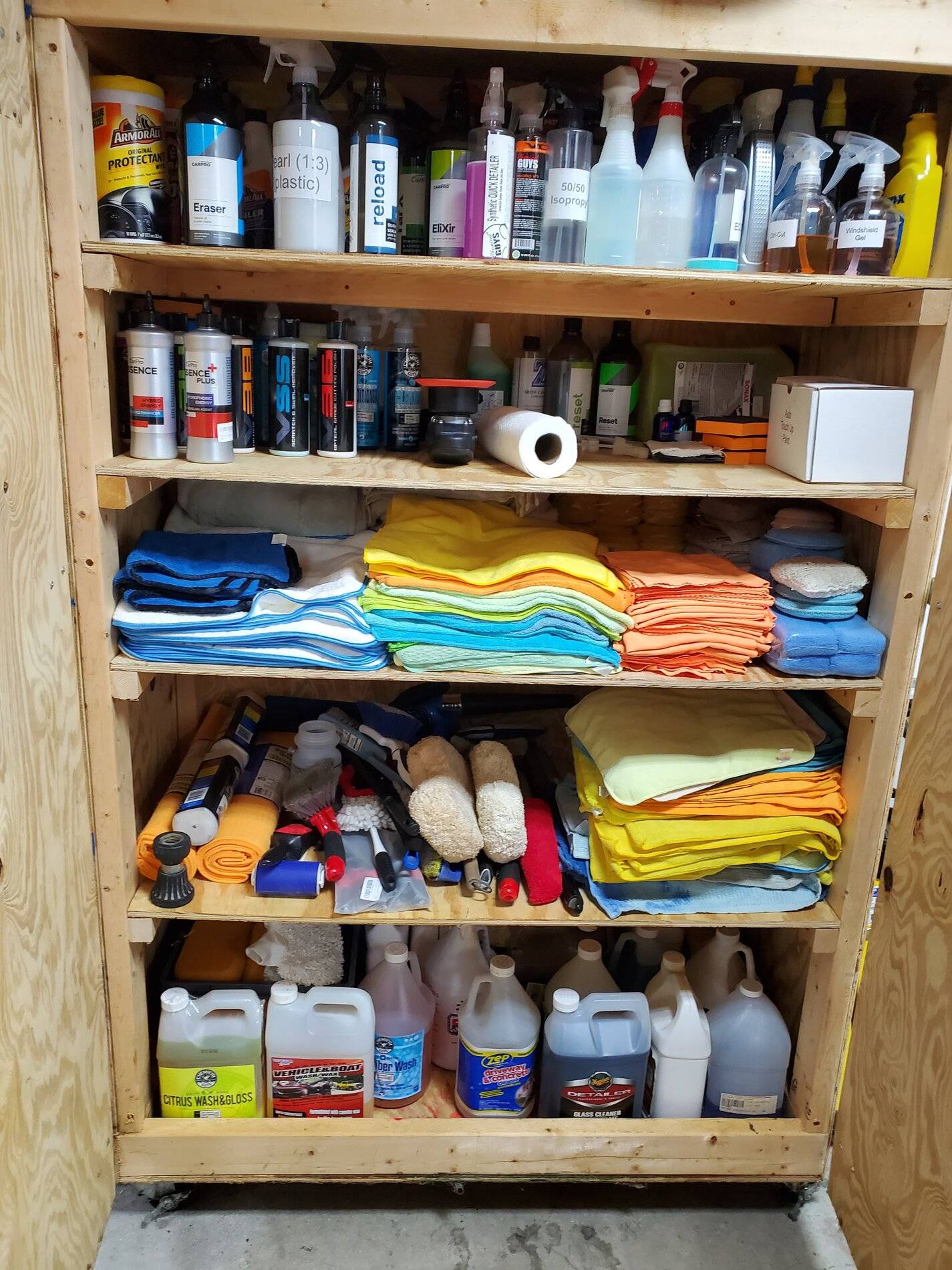

(You think some kid in the corner detail shop is going to do all that? Color me skeptical...)
Then all that is needed moving forward is the occasional wash and surface enhancement with RELOAD, GLISS, or ELIXR.
(Yes, the "detailing" cabinet in my garage looks like a chemistry set...)

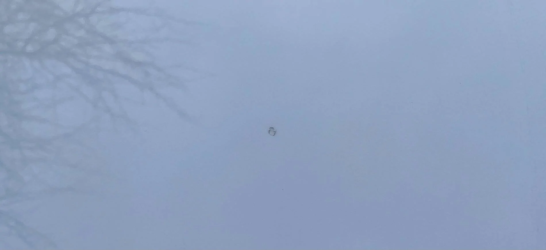

THIS is why you want PPF!
Just caught this while wiping the car down. About 6 inches above the crest on the hood - about 1/8 inch diameter. This would definitely have gone through the paint...

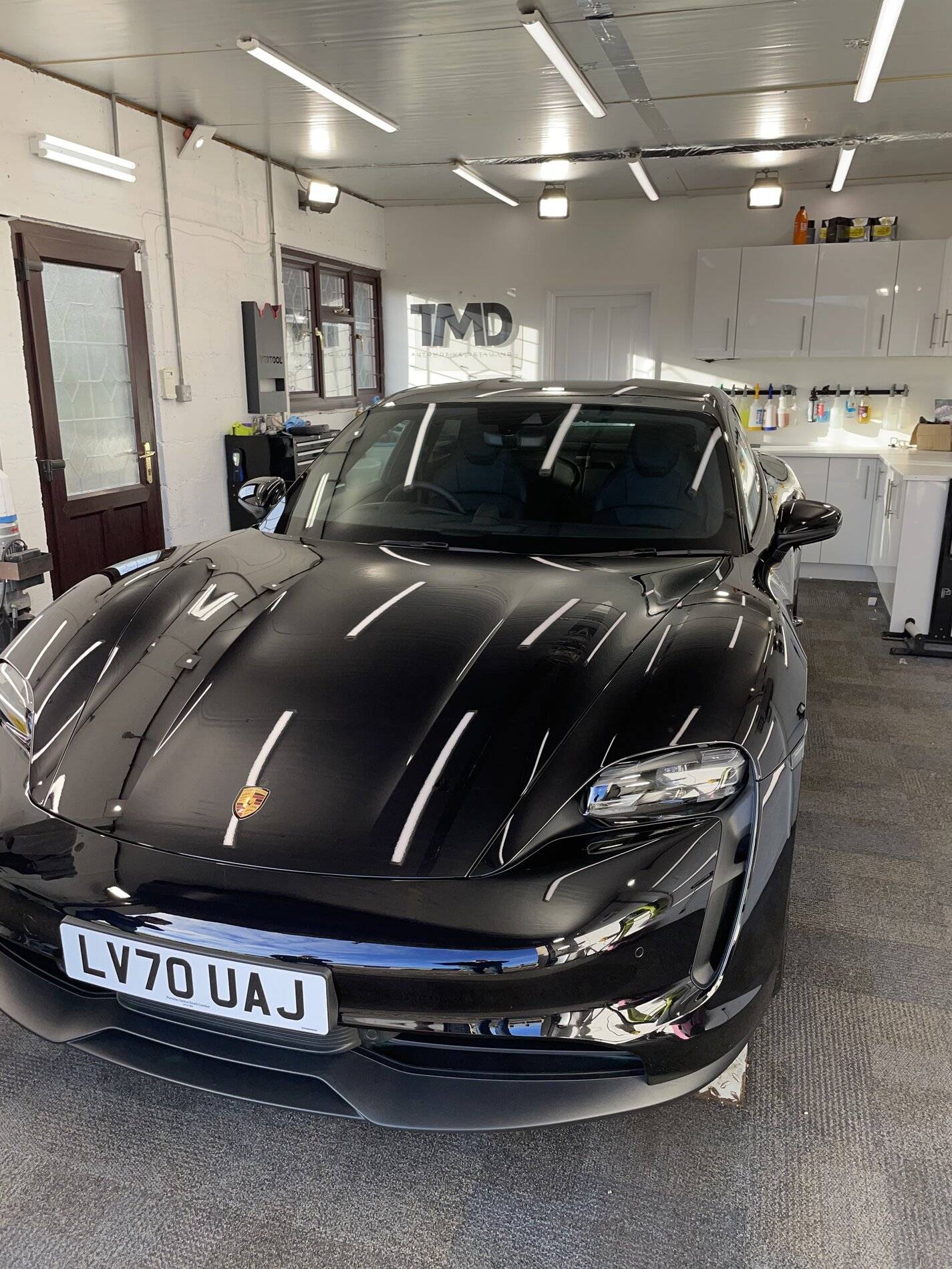

I have just got my car back after ceramic coating and I am really pleased with the results. It really makes the car stand out and it looks a lot better than when I collected the car from OPC. I would say it is worth it.

...and it gives us "eco-criminals" a good excuse to keep our garage heated:
