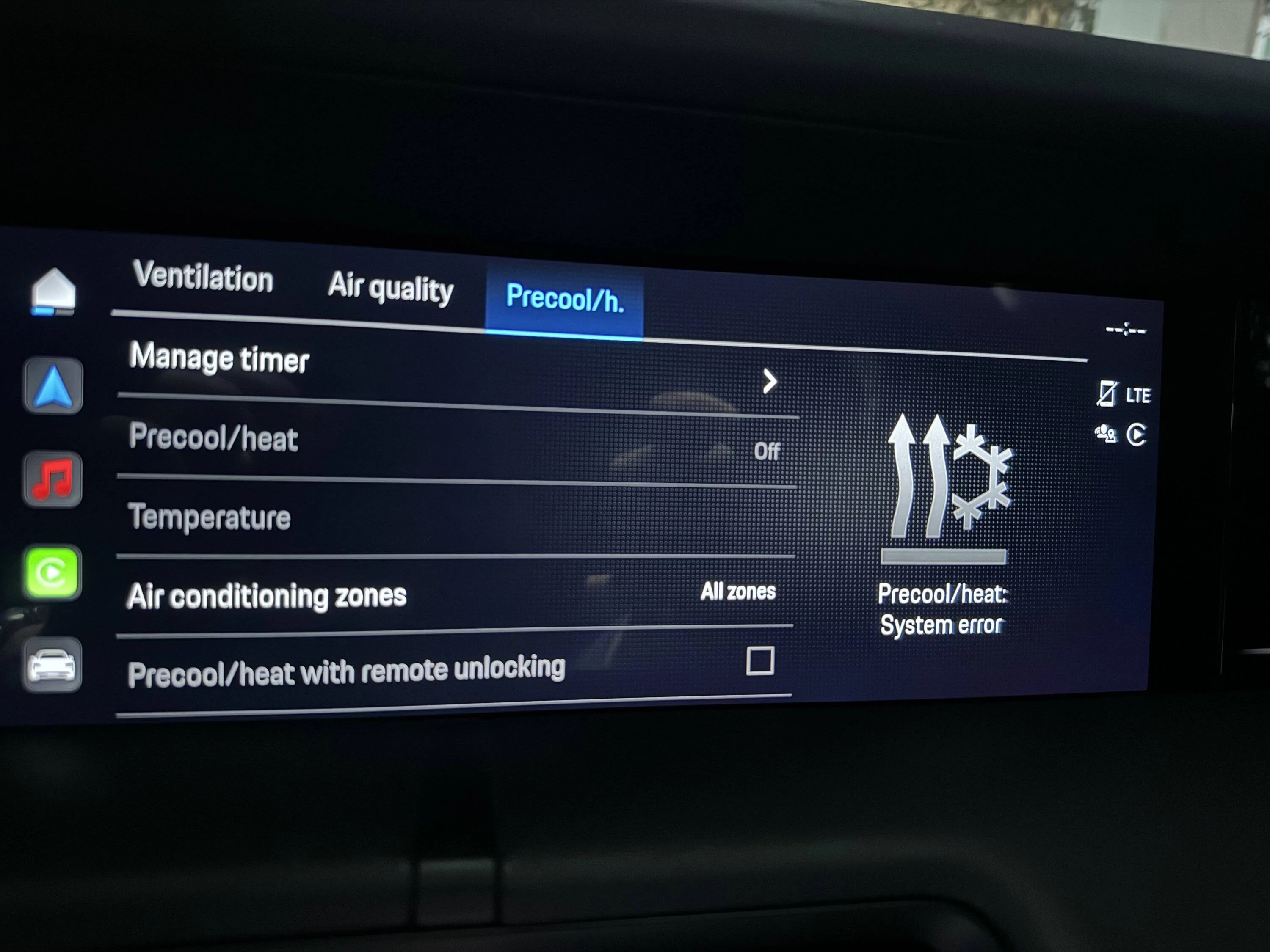

Trying to avoid yet another topic on the Taycan heater problem WPL8 - Replacing Electric Passenger Compartment Heater, but could not find an answer to my question, namely, when the ambient temperature outside is in low 50 F (10 C) and heating is set to 72 F (22 C), should i feel warm air coming out the vents or not? All my previous cars, at 72 i felt warm air, but not on the 2021 Taycan i recently bought used.

The heat going into the cabin is based on comparing the cabin temperature with your setting. There are a few tests. If the car has been sitting at 50F for a while, turning it on and setting the heat to 85F, it should be very warm out of the vents within 5 minutes and not stop being warm. Another way is with the car at 50F, select "precondition" on the lower console display and there should be an error on the main display. Another way is with the car at 50F and charging at home at X kW and Y miles/minute, choose precondition on your phone, and the kW should stay the same, but the miles/minute should drop because most of the kW is going to the heater.
It is odd that the campaign says "the heater coating in the electric passenger compartment heater can become detached." From what I experienced and read, the heater fails completely due to an electrical fault, not some material coming loose. And when that heater fails, you lose cabin heat, cabin defrost, and battery preconditioning for both driving and for charging (on colder days).

for anyone reading the end of this thread, my heater might not be dead and simply susceptible to a software bug.
https://www.taycanforum.com/forum/threads/tsb-wps9-–-re-programming-thermal-management-control-unit-feb-8-2024.19253/unread
i (just) had it applied by the dealership and hopefully it will resolve my issue.
