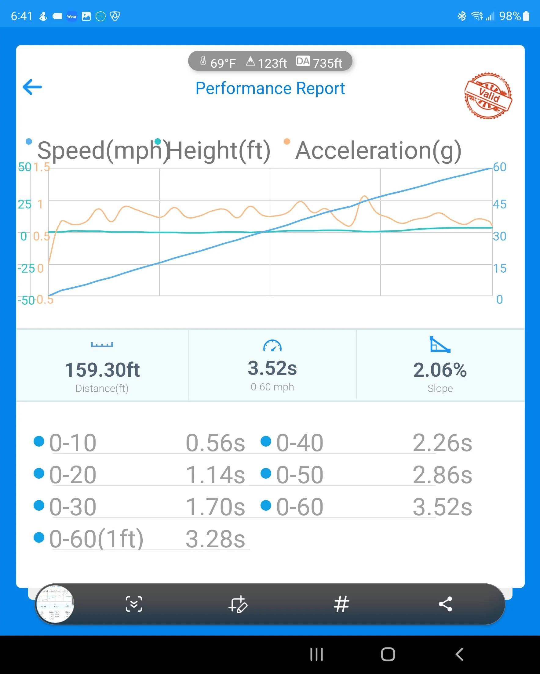

0-60 results...spoiler alert: not great.....however there is a caveat. The Dragy showed a negative slope for these runs vs a positive slope for the runs in the 4s in the exact same location, so maybe the dragy was having issues. The 4s did not have the thermal glass and the GTS does.
75% SOC
Run 1 3.38 1ft rollout 3.62
Run 2 3.35 1ft rollout 3.61
I'm a big guy 300lbs + or -. So im always a tenth or so slower than average. This the first Porsche (911's, Taycan Turbo, and a Cayenne) that has not been at least 1-2 tenths quicker than advertised. It is .15 quicker than a 4s I tested recently in the same location. It's very close 0-30 to the 4s and breaks away from 30-60.
I'm very surprised at this result as the 140+ extra ft/lbs of torque should be moving this car faster in the first 60' than the 4s, but it's nearly identical. I was really hoping for high 3.3x to low 3.4x for me.
Hoping to get to the airstrip over the weekend for some 1/4 runs and further testing.

My Turbo was in the low 3.1x consistently. That's why I was hoping the GTS would slot in the middle Around a 3.4x.

Let me make it perfectly clear that there is a performance difference between the 4S and the GTS. The extra torque and the unique suspension tuning is certainly noticeable. Also, let's not jump to conclusions on acceleration based on one testing session, with as noted, a possible malfunctioning of the Dragy test equipment. Further testing is needed.
I will say that I do not understand the launch control tuning of this car, as the extra torque in that first 2.5 seconds should have the GTS far outpacing the 4s over the first 60'-100'. This probably has alot to due with my lack of understanding how electric motors translate torque to HP at the wheels, especially with no traditional transmission up front and the two speed at the rear. It's almost as if the extra 28HP is all that matters in the .15 difference in 0-60 times. I need an engineer...lol.

I'm actually out testing now, and my Dragy is all over the place. It says it has sats, but I'm beginning to believe the TIG is causing issues.

UPDATE: I finally found a spot for the Dragy that gives consistent results. The only place is on the center console to the left of the front cup holder. Once I landed on that location I got four runs within .02 seconds of one another.
3.52 3.53 3.52 3.54 - much better and more consistent, especially for my 300lbs and a small upward slope. I expect mid to low 3.4x's are what the car is capable of with average size driver.
The 60' times are 1.88-1.91 which is .10 faster than the 4s and .2 slower than my Turbo.
Overall it's about a tenth slower in the 60' and the 0-60 than I was hoping for at my weight, but I'm satisfied.

C&D ran a 3.4 w rollout in the 4S, 3.6 full. I would expect GTS might be a tenth better.
The launch torque is 30% higher than the 4S, same as the turbo (which I was surprised to see) but the peak HP is only 5% more than the 4S. Looking at the graphs of the motor base speed relative to car speed and considering this boost is supposed to be 2.5 sec, I think for there to be that kind of discrepancy, they have to be tapering off torque as the car accelerates more than the 4S. I don’t see how the numbers could come out that way otherwise. I’m not sure why though other than to keep room between the GTS and Turbo.
