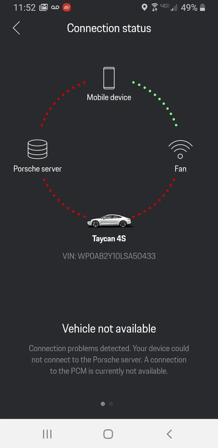

2. I cannot get the WiFi hotspot to work in the car. I followed the instructions under PCM Services. The app is saying that it is connected to the car but "without internet connection"? When I am in the connect app under Connection Status, it is showing all red dots from Mobile device to the Porsche Server, and to the Taycan. ( see attached photo). Is anyone else having issues with this?

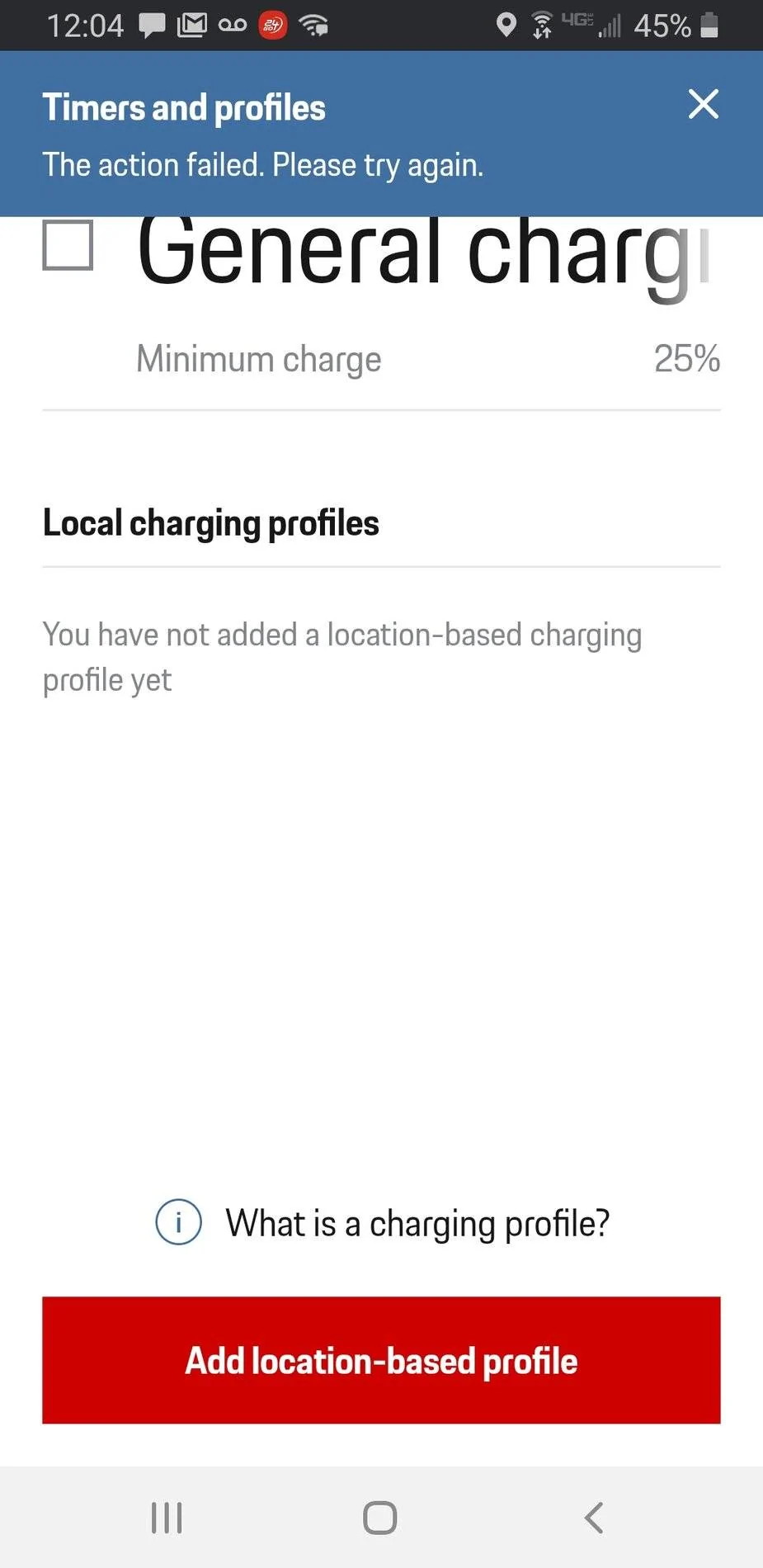

3. In Connect, under Charging Profile. I tried to setup General Charging at home. After I set the charging time and save it is saying "action failed. Please try again" (see attached photo). This happens over and over. Is this with Porsche Connect or am I doing something wrong.

2. The wifi in the car connects to the internet, but does not allow you to browse on your phone / tablet when connected to the hotspot. Perhaps a future iteration
3. Make a new profile in the Porsche Connect app or in the web browser. Set what time you depart, when you want to charge and what is max charge. I deselected the general charging after that.

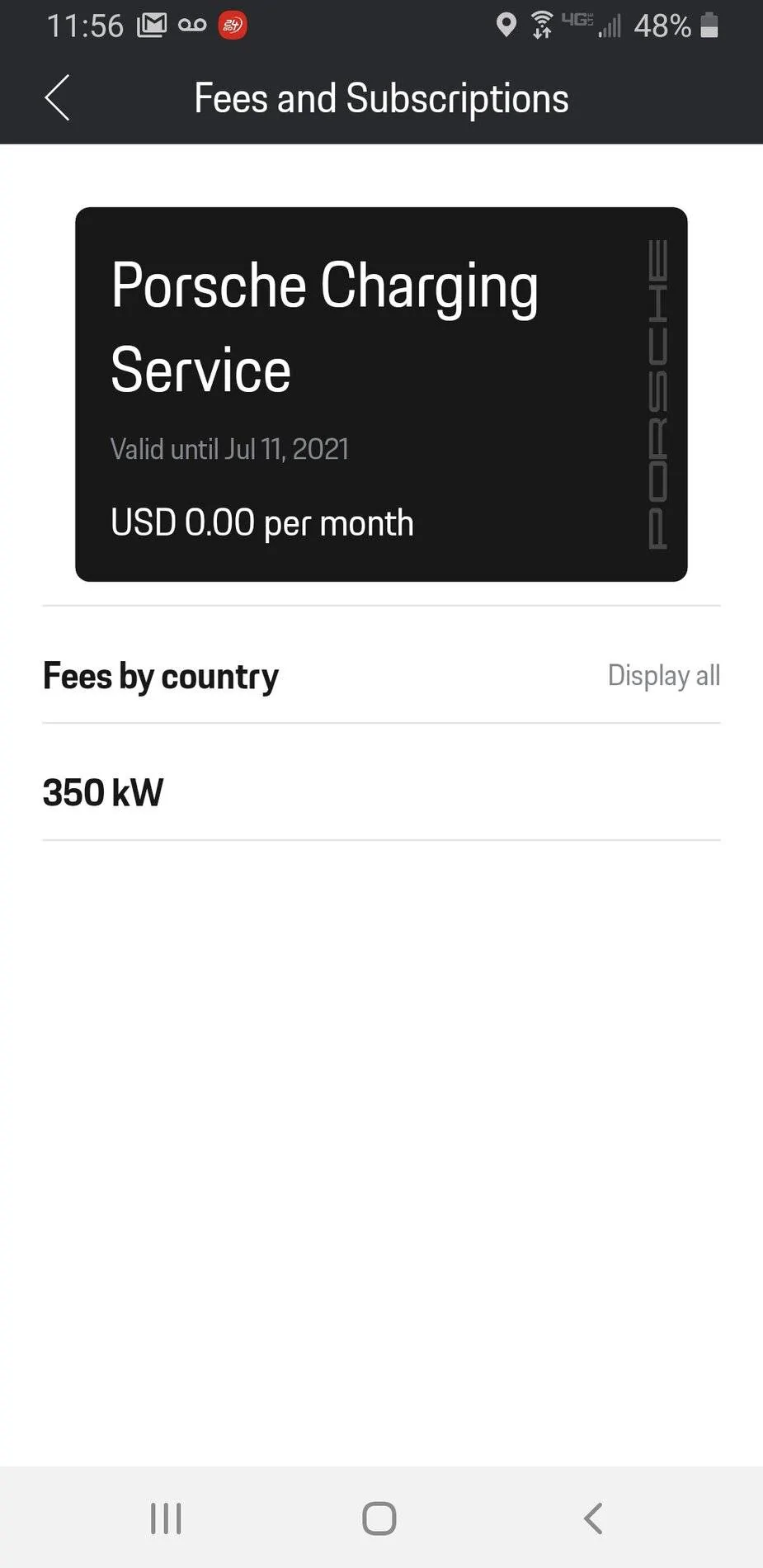

1. I don't remember if I got to the credit card part when purchasing the free charging. Here is the screen from Connect showing that it's active.
2. I see. I guess the problem for me is that since the WiFi connected, when I play Pandora on my phone, it is saying there is no connection. I would have to disconnect my WiFi from my phone and only use my cell service to play Pandora. I assume this is normal right?
3. Ok. I will try that.

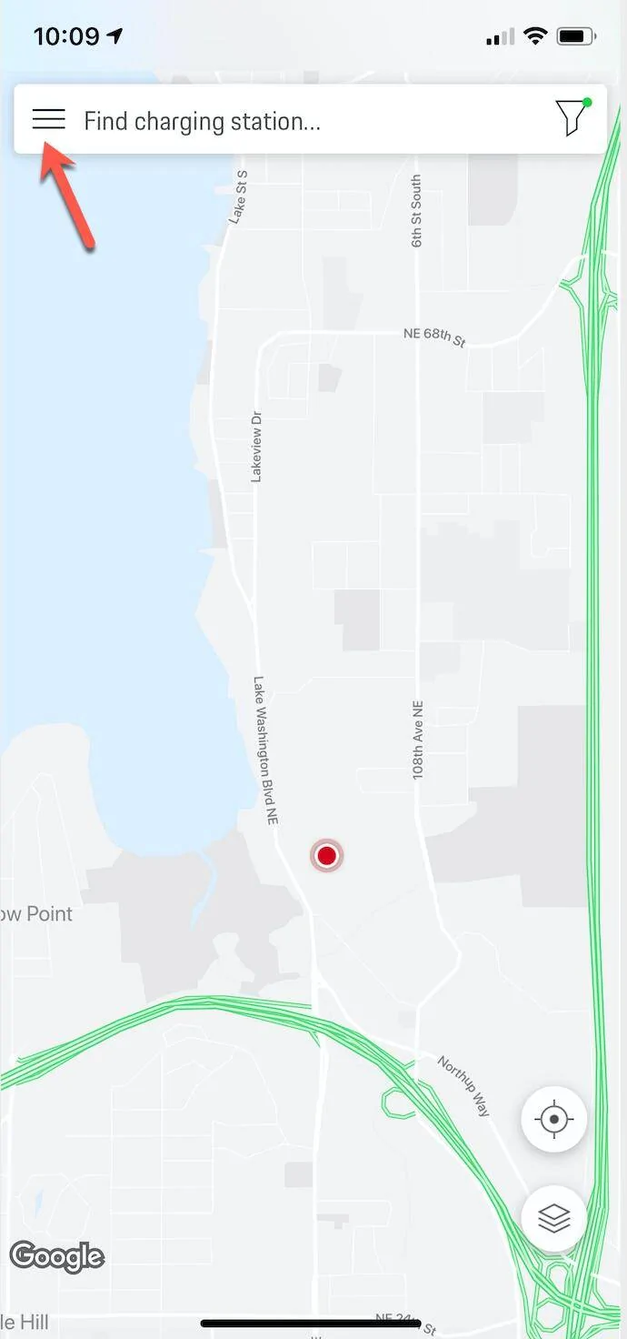

1. I needed to accept the offer of 3 years free charging in Porsche Connect, although I did it via a web browser not the iPhone app since it was easier to add the credit card this way.
Once you've completed that step, open Electrify America App on your iPhone. in the upper left corner click on the 3 parallel lines, and in the side menu choose Login. You can login using your Porsche Connect login credentials. Now when you try to initiate charging it will work.

2. I've not been able to get this to work either, and I think the reason is that it was intended for countries that offer the ability to buy a data plan for your car. The LTE connection definitely works, and is used by Porsche Connect to download map updates, destinations and routes, etc. However, I don't believe that the US offers the ability to treat the LTE network as a HotSpot. If that were allowed without a data plan, it's likely that some owners would use the HotSpot for all their data while traveling.
3. Regarding charging profiles: I think it's safe to say that Porsche is still working out bugs in their Porsche Communications Management (PCM) system, and in Porsche Connect. As reported by Don (@louv) in https://www.taycanforum.com/forum/threads/don-breaks-his-taycan-the-saga-of-the-12v-battery.1274/ there are actions that may cause your 12V battery to discharge unexpectedly.
One of those actions appears to be communicating with the car via the Porsche Connect App to change settings for a Charging Profile or a Charging Timer, while the car is connected and charging. This has led me to stop using Profiles and Timers and simple allow the car to charge to 100% whenever it is connected.
I can buy airtime for this in France through MyPorsche and the services for the car. But the cost is higher than just having a good data plan on your mobile so I do not see any value from that feature. If I need to I can put my mobile in hotspot mode also. The car will get updates to traffic info, map updates etc via LTE so the car has the necessary data connection.
In the charge app when you choose buy Porsche charging it takes you to a page you need to log on and complete the purchase (the 0$ thing). Scroll at the bottom of the app and there is a method of pay there (Visa / Mastercard / American Express). Choose the card type you want and that takes you to the credit card site where you have to login. Once you did that, the card is linked to the app.

Snstevens, so you use the Electrify America App? I don't have Iphone but I downloaded the app on my S9 and did what you showed in the post. I used my Porsche Connect login credentials but it didn't work. It's saying invalid user and password. Do you have to be at the charging station with the car plugged in to log in?

Regarding the WIFI hotspot. I don't remember my Panamera having this issue. I did purchase the ATT data plan for the google map services so maybe that's why it worked?

You need to download the "Charging NA" app from the Play Store. The Electrify America app is a nice to have, but it is the app for the general public, not specific to the Porsche program for the free 30 minute sessions.
With regard to the Wifi Hotspot, the ability to browse the Internet has not yet been enabled according to my calls with Porsche NA.
Exactly, or fit a 12volt or USB hotspot in the car with your own data plan. Ridiculous that we are forced to use an expensive & inadequate data plan.
