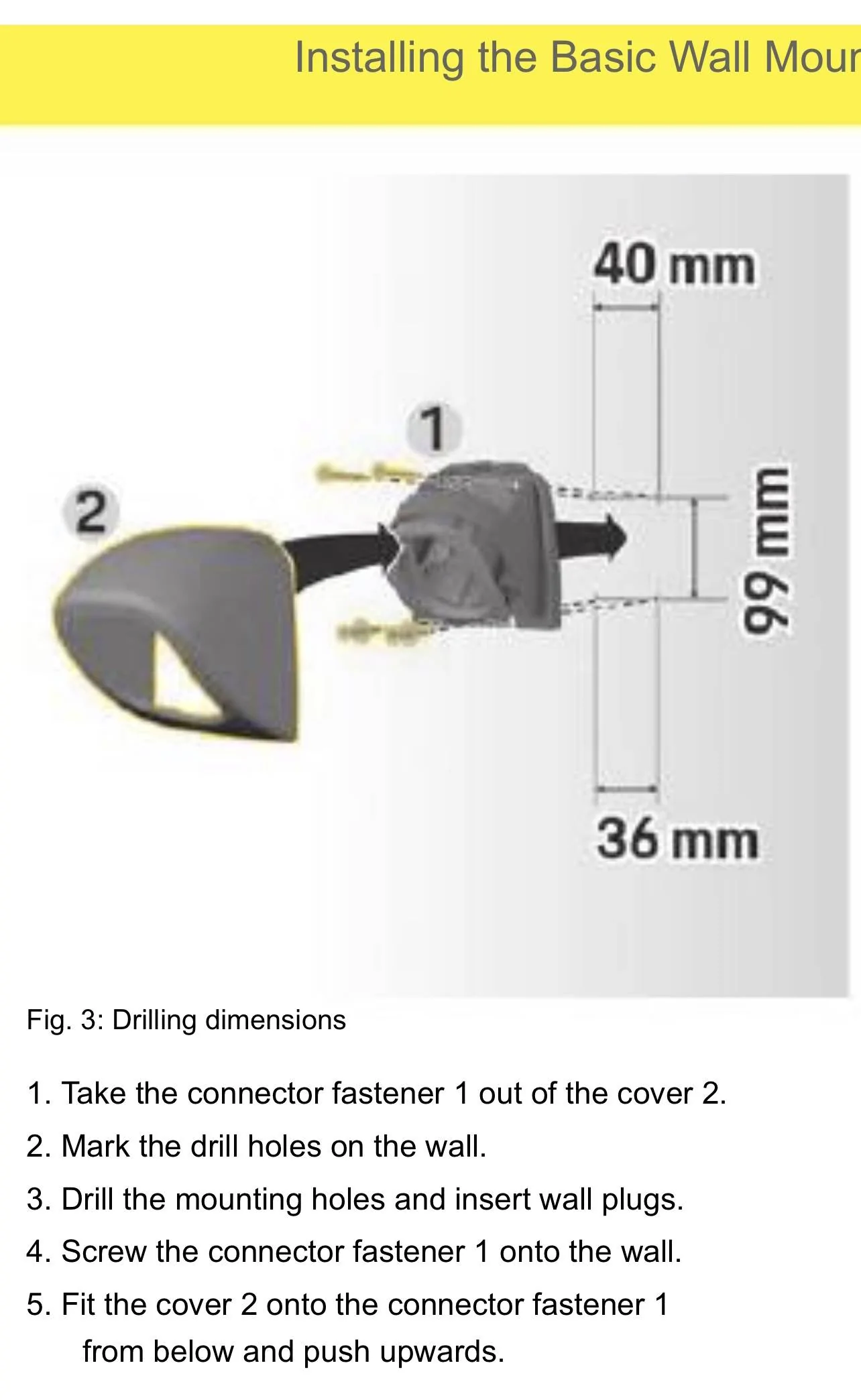

I’m replacing my Porsche Mobile Charger Connect with a Wallbox Pulsar Plus and need to figure out how to detach the handle dock from the wall. It’s two pieces where one piece is screwed onto the wall and then a cover snaps over the first piece (see the bad picture of instructions). There must be tabs that need to be depressed to remove the cover and I don’t remember where they are from the installation.
Can anybody provide some help or if you have a PMCC that’s not installed look at the dock and let me know what you see?
I may run by my dealer and see if they have any for me to look at.
Here are the instructions:

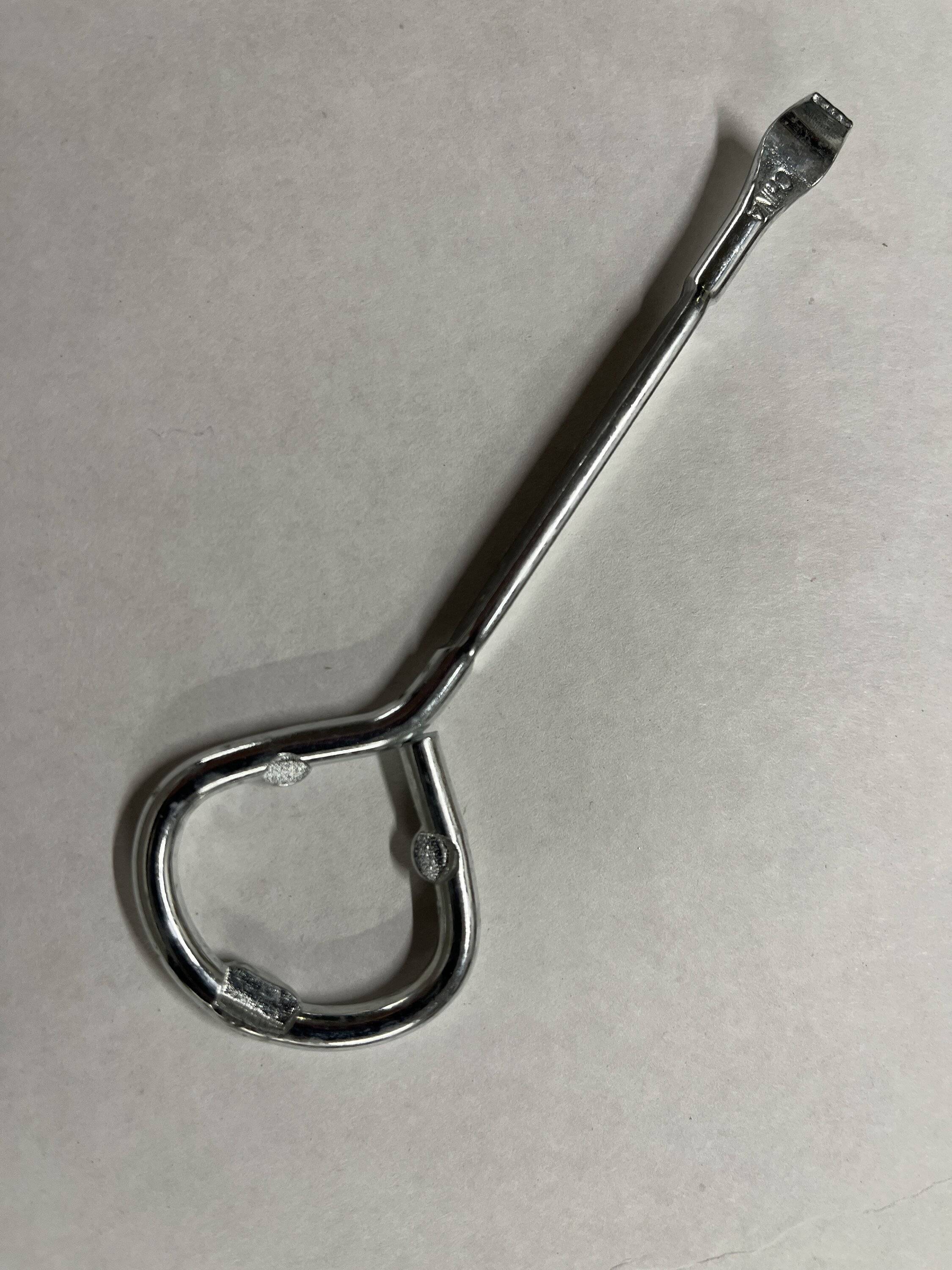

You can use a hooked paint can opener to pry the cover off. Slip the hook under the TOP edge of the outer cover and pull up slightly, The cover will pop right off. Prying under the side edges or bottom edge will NOT work.
The tool with the bent end that is included with the Taycan tool kit may also work.
That did the trick. I happened to have had a couple hanging nearby. Thanks!
