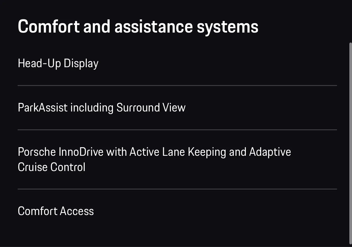

If it helps here is how it is listed in my options.
Any feature purchased outright, whether from new or via FoD is permanently linked to the car. The only exception is a monthly subscription FoD, which remains account based.
So what does Comfort Access actually give me?
  • I can walk up to the car with the key in my pocket and it unlocks automatically, with the door handles popping out. The steering wheel and seat move into position.
  • I can drive off without pressing the power button.
  • I can open the boot with a kick gesture.
  • The boot has an option to close and lock in one action.
  • The frunk opens with a gesture (although I’m not sure if this is part of Comfort Access).
Porsche Taycan Keyless entry access IMG_0256
I had exactly the same functionality as you describe for a month or so after oirchasing my vehicle until I activated my new Porsche account. From your explanation I would have thought that the previous owner had Comfort Access as a subscription, however there is no subscription service on offer to me in FOD, just the option to buy it once at £1200 ?
Frunk hand gesture is part of Comfort Access.
Seat and steering wheel positioning only features if you have the optional 14 or 18 way seats (or Driver Memory on the standard 8 way seats). Door mirror positions, HVAC and PCM settings are also stored plus you get the tilting passenger mirror when selecting reverse.
The FOD implementation of this doesn't have the additional lock and close trunk button either.
11,049
6,835
As of September 2024 subscptions were dropped for Comfort Access, PDLS+, Power Steering Plus, InnoDrive, Active Lane Keep and Porsche Intelligent Range Manager.
Lifetime purchase could be made only from that point. Existing subscriptions would remain until change of owner.
A £1200 fee for something that when factory fitted and had more functionality for half the price is simply outrageous. If resale is a consideration then it's probably worth £100.
