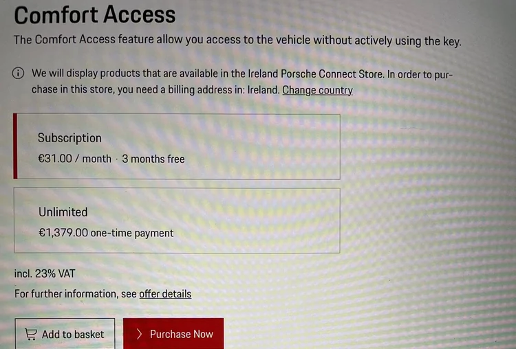

Every single Porsche Taycan has comfort access, the hardware is the same on all of them. Whether it is enabled or not is just a coding value or can be enabled via FoD:
Porsche Taycan Keyless Entry 1766850099340-fr
The reason some people are losing it, is because it was most likely either coded by someone with PIWIS Engineering after the fact or enabled by FoD and for some reason the car lost the FoD codes after the update.
So if you think not taking it you're going to have any fewer issues you're dead wrong as the hardware and software is identical. The keys and everything else works exactly the same, and the reason it doesn't unlock the car automatically is simply because there's a checkbox from FoD telling it not to.
In fact it checks two things - whether the function is released by FoD and whether it is activated in the PCM. So you can have the same exact behavior by just disabling it in the PCM on a car with it. Newsflash - it won't solve any of your issues or reduce your key battery drain.

The hardware is present in all J1.1 cars as it can be enabled with FoD. Not sure if it has changed since J1.2 does not have FoD.
Mine also had it active since day one without being optioned with it.
