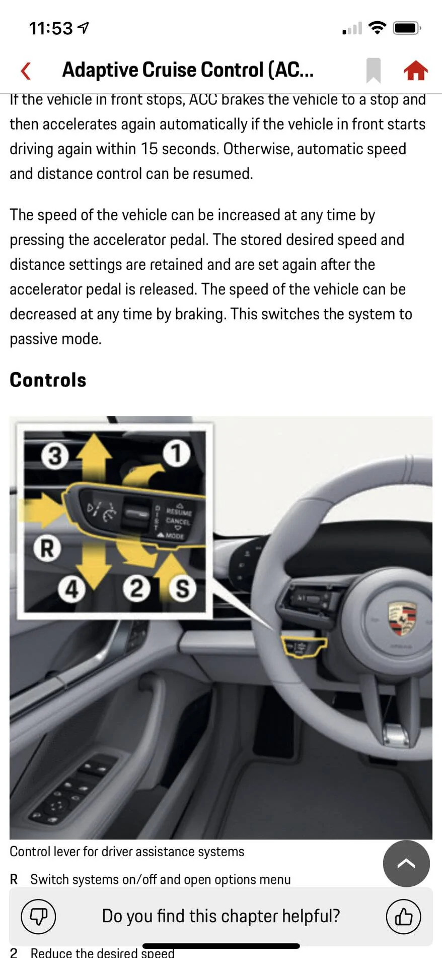

Out of the blue, lane keep assist has now stopped working. MY2020 Turbo. The graphic on the instrument cluster that shows the car in lane markers is completely gone. When I look under “Assist”, the box for “Lane Keep Assist” is still checked off. I unchecked and checked it again. Rebooted the car. Still no dice. Has anyone had this issue before and been able to successfully trouble shoot?

Did you turn it on using the control lever? Press the "R" button and then turn it on using the scroll wheel on the steering wheel.

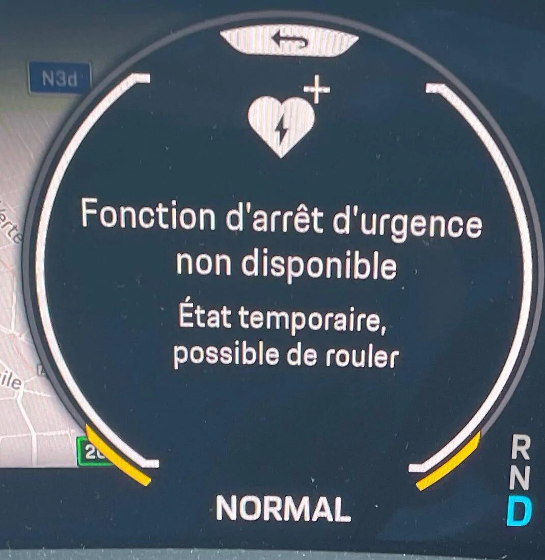

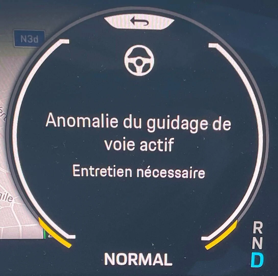

Same happened to me today as well. The dotted lines symbols had disappeared and I received 3 error messages on my dashboard. I switched the car off, had dinner and everything was working properly again.
what errors if you don't mind me asking?
JimBoBel
Jean-Marc
Jan 24, 2021
Display is setup to French, have a look.
- Emergency braking not available
- Anomaly with Active Line Keeping
- (and I realized I have not taken a picture of the third one) but it was related to the line assist
Thanks. I tried this and it worked for me. Everything is back to normal.
