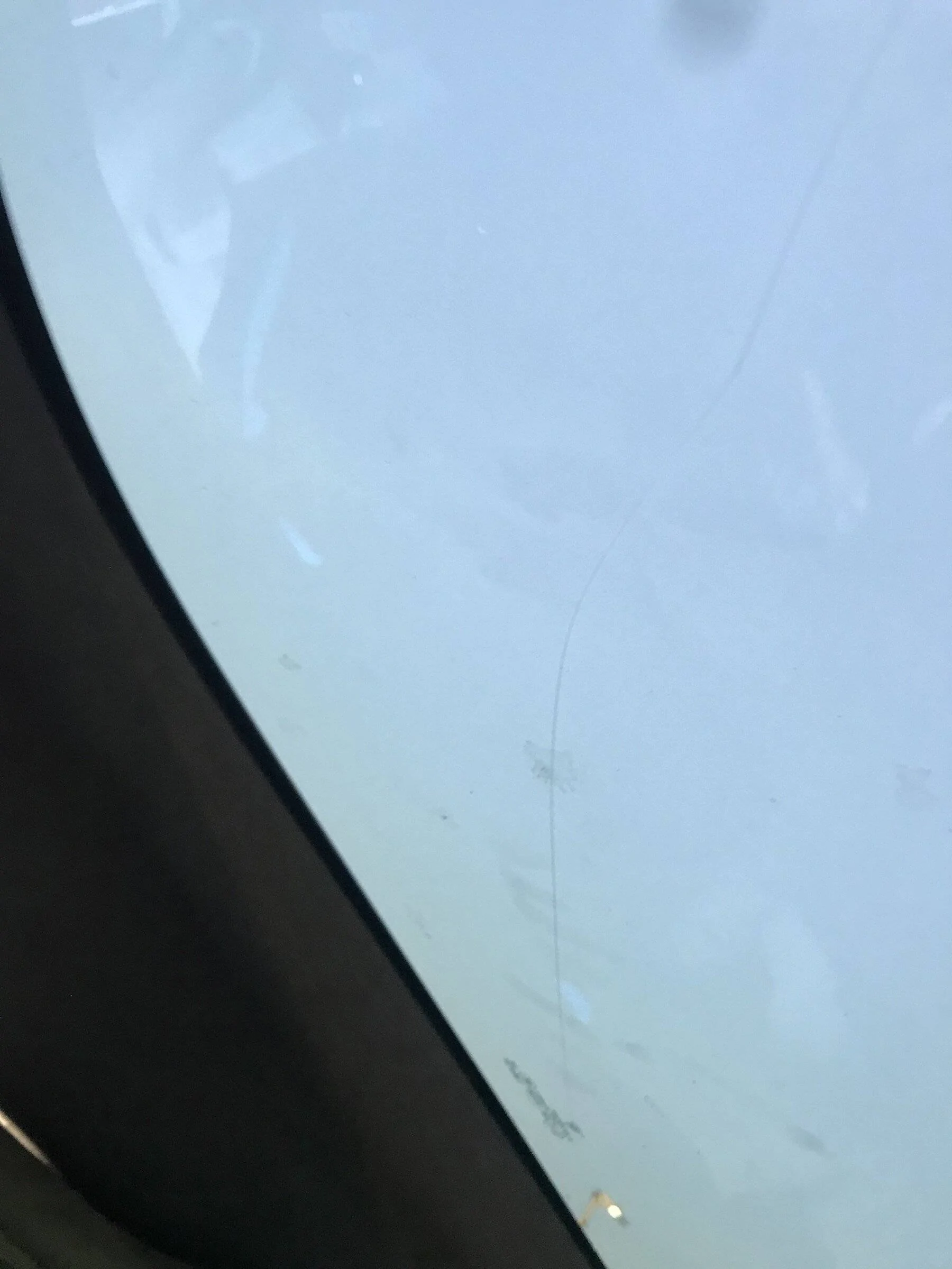

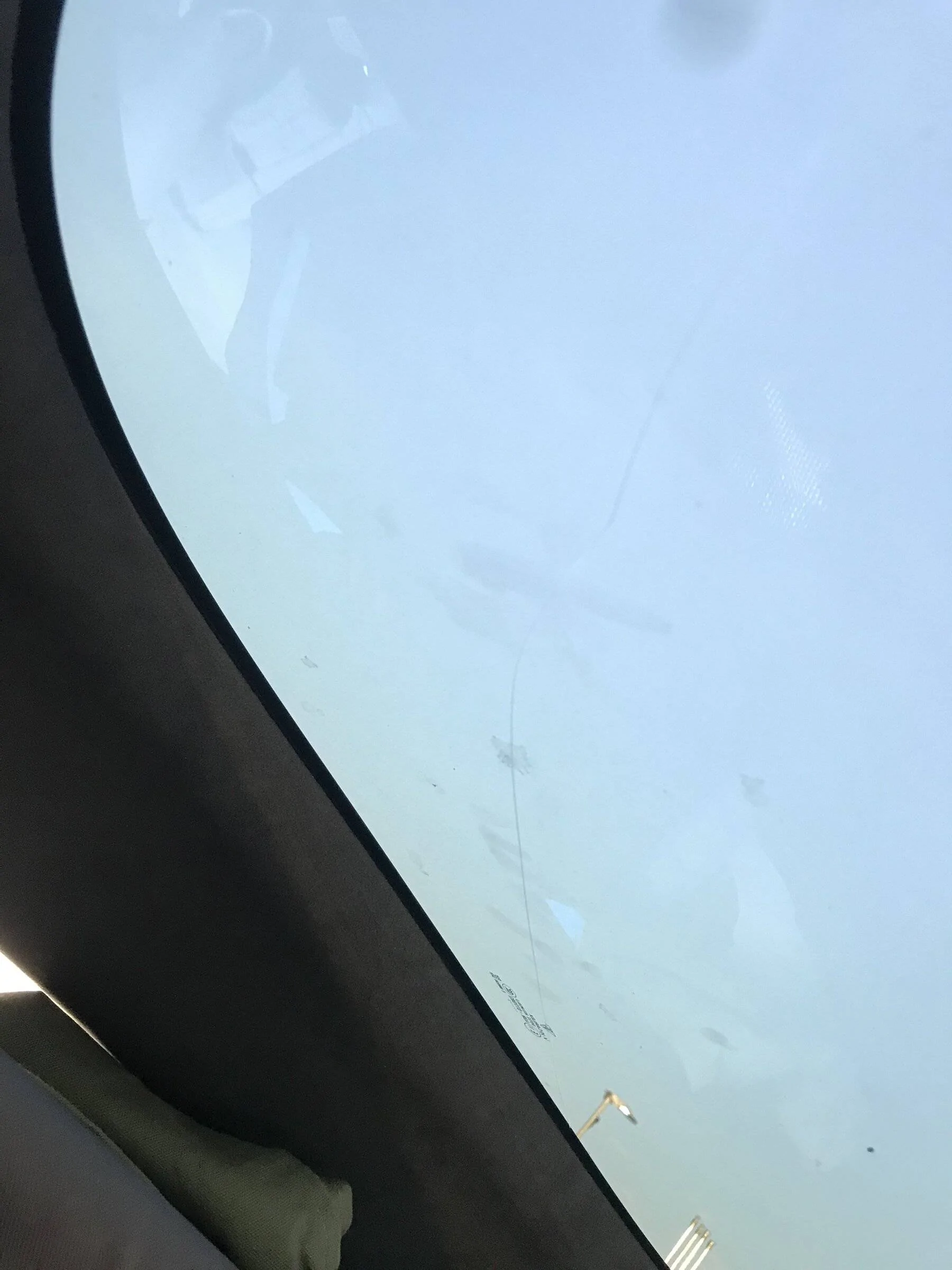

this is a fascinating thread and so timely. My CT Turbo S has just had the same thing. Here are some details and I’d appreciate any thoughts…
Car delivered 1st March 2022. Supplied with black roof bars (in error, should have been silver) with glass pano roof. The roof bars were changed at Porsche’s cost 3rd to 6th May. This was done at the UK dealer.
The car has now done 3,714 miles and the cracks appeared last Friday during a 240 mile journey.
I attach some photos, but the cracks are across the width of the roof right near the back. It’s at the dealer next week so they can assess whether it’s a warranty claim or "…it has been caused by an outside influence…" (dealer’s words).
I have washed and eyeballed the roof. The crack appears to be entirely internal to the glass with no feature visible or felt on the surface of the glass.

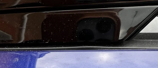

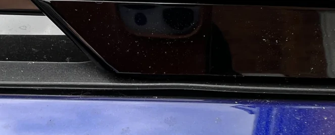

@MY22PCT Think that’s now four of us with cars delivered at a similar time, with roof rails and cracked internal laminate layer and nothing on the external glass. Does yours have the same external raises as mine I posted near the rear roof rails (possible over torque on rails, or may just be a bad batch from their supplier). Mine seems to have lasted the shortest time, 120 miles when mine went. 1700 miles since and no change to the crack, nothing external and fully watertight.

The information I was given by Porsche it that they believe that the screws under the roof bars may be too long hence the cracks on the roof.

That would actually make sense tbh, given zero external glass issue. On such small margins can a ?-up occur! I’m happy with the standard Pano, just hope it arrives soon as 7 weeks on now. Pointed out that it doesn’t really affect me too much, barring having to explain to anyone who gets in the car. However for each new person who sees it then doesn’t look like the high precision, high cost yet high value they like to project as a brand ?.

Ok, think got to the bottom of this. Looking at the car today, there is now clear warping of the laminate around the roof rails. This is on both sides at the rear, and the crack originates from that area on one side. Actually, it started on the side showing the least warping.
For further validation, the one other person I know who has seen this on a UK FB forum has said his originated from the front roof rail side though don't know if he has as obvious distortion yet. Looks like the robot in the factory must have been having an angry day affixing the rails..... I've passed onto my Porsche centre to hopefully help with root cause (and to make sure my new roof doesn't immediately do this again).

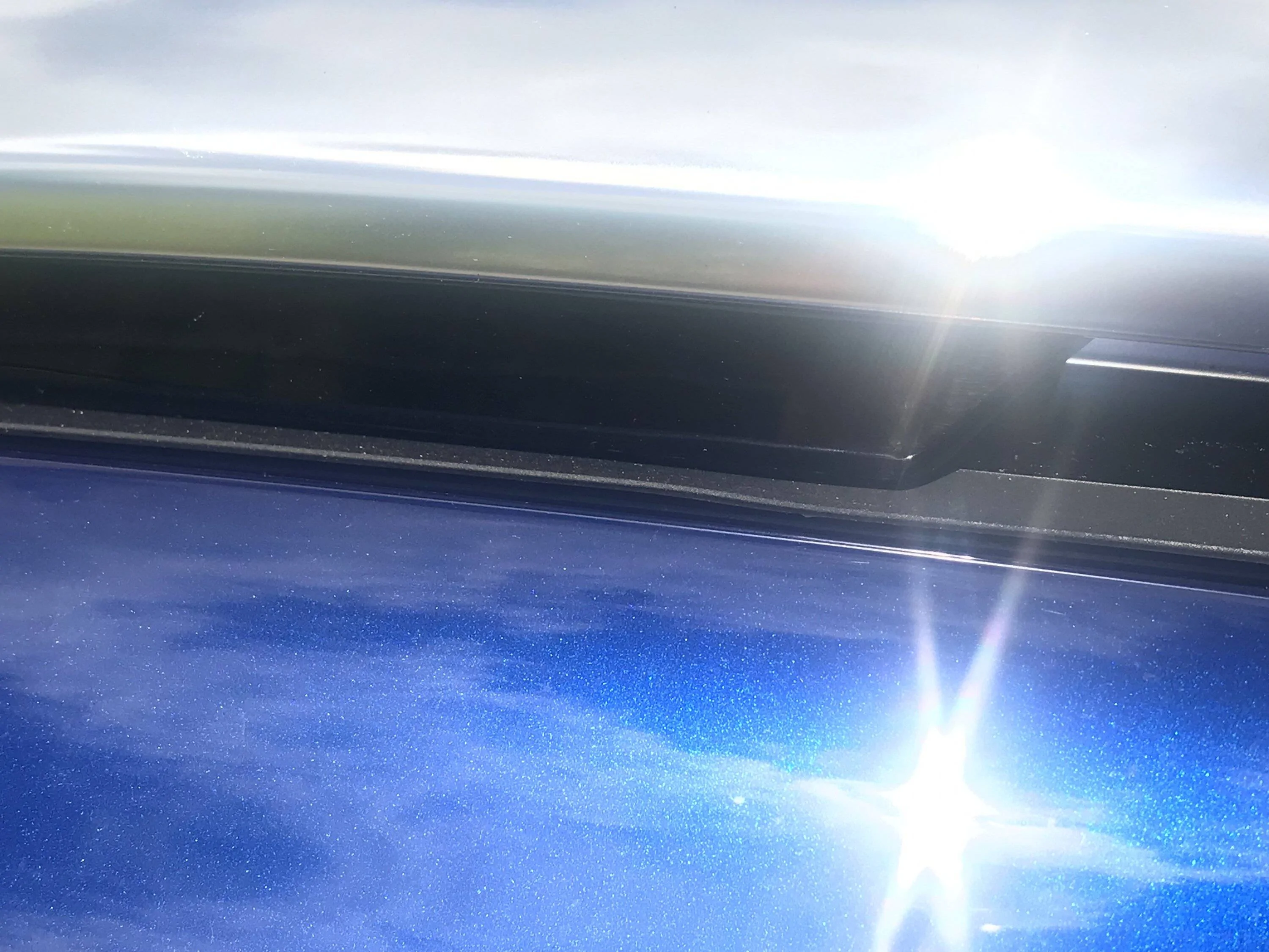

I can see a slight rise at all 4 roof rail fixings. The glass seems to be set into a close fitting rubber seal which at first glance looks like a chamfered edge to the glass. This is slightly distorted at all rail fixings - photo of 1 attached.
The crack is definitely in the internal layer since I can’t feel anything on either external face.
it may not be clear from my first photos of the crack, but it is a single crack from the driver’s side, forward of the rear rail fixing. It then travels backwards to roughly centre of the back edge.

Hi thanks for the photo, I have just been out to look at,my sorry dirty car and I have the same issue.
i will attach the photo and apoligises for the dirt.
