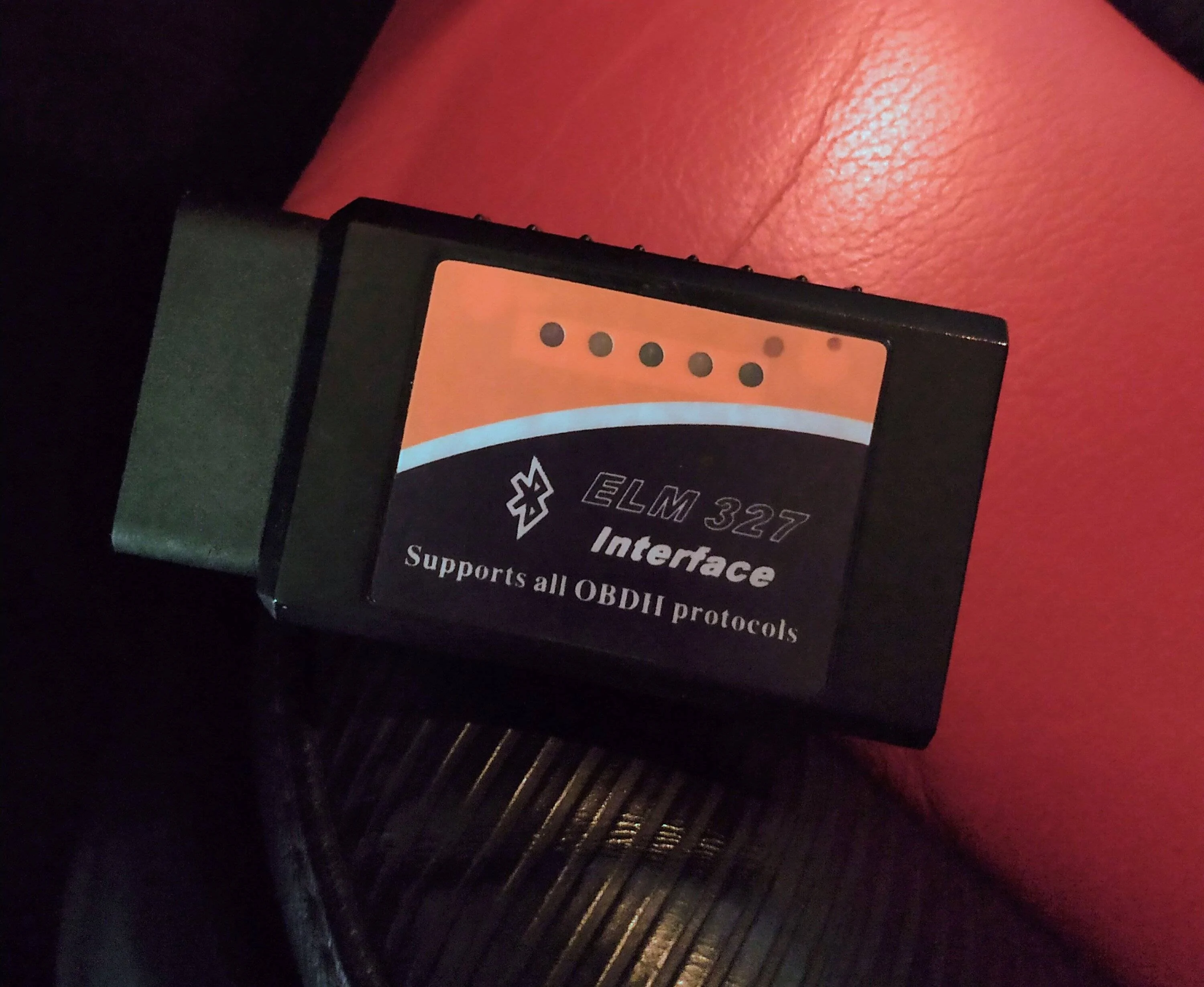

Or the original ELM327 but there are a lot of Chinese clones.

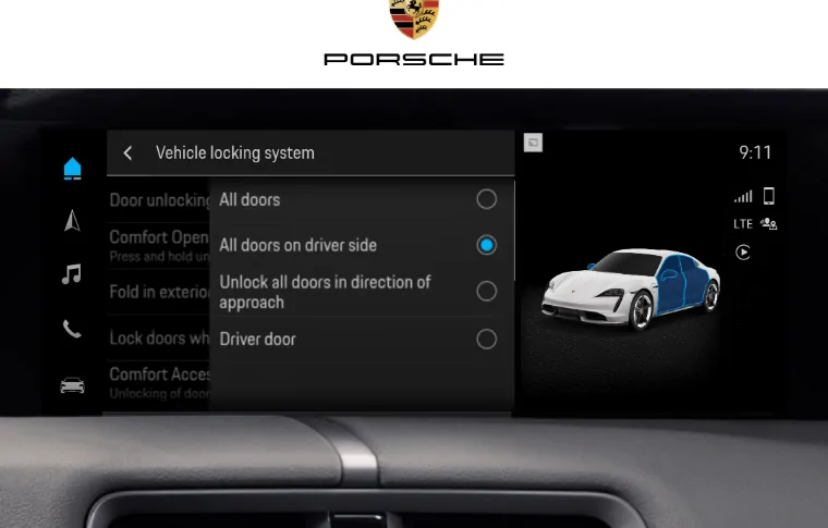

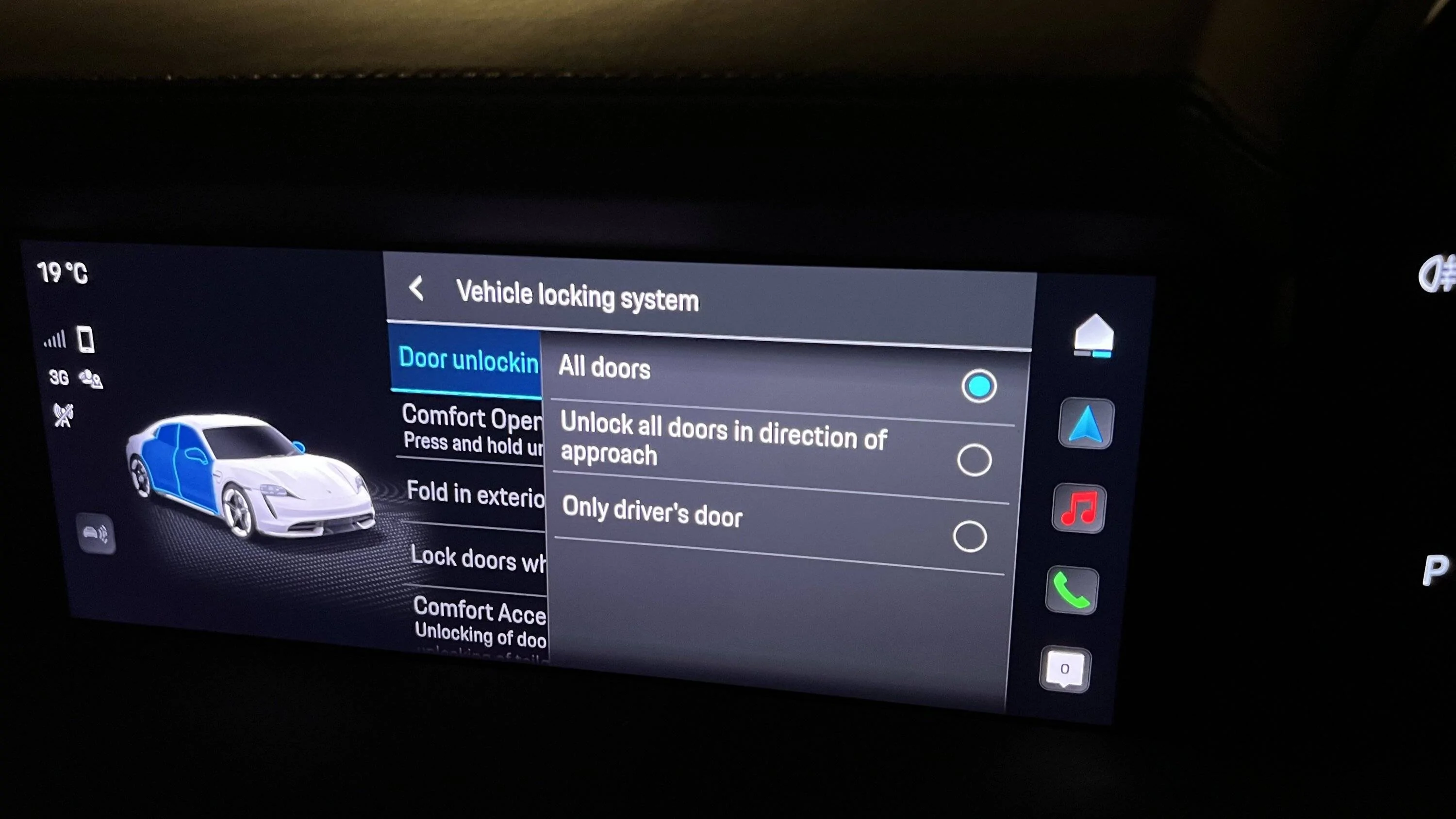

Is the middle option – unlock all doors in direction of approach – a new option with the recent software update ?
I still would prefer the option: "Only front door's".
No, it's not new.
Already there.
[Edit]
The small change is: "all doors in direction of approach"
It used to be only "all doors at driver's side":
Porsche Taycan Latest Taycan Software Update Findings and Reviews Thread IMG_20220822_100436348
I also found this on the PCM simulator (https://your-digital-co-pilot.com/en):
Porsche Taycan Latest Taycan Software Update Findings and Reviews Thread Screenshot_20220822-101012
Now I'm REALLY confused...

No, it's not new.
Already there.
[Edit]
Apologies @tigerbalm - my mistake, it is there and is on the 'old' PCM simulator too - not a new addition.
