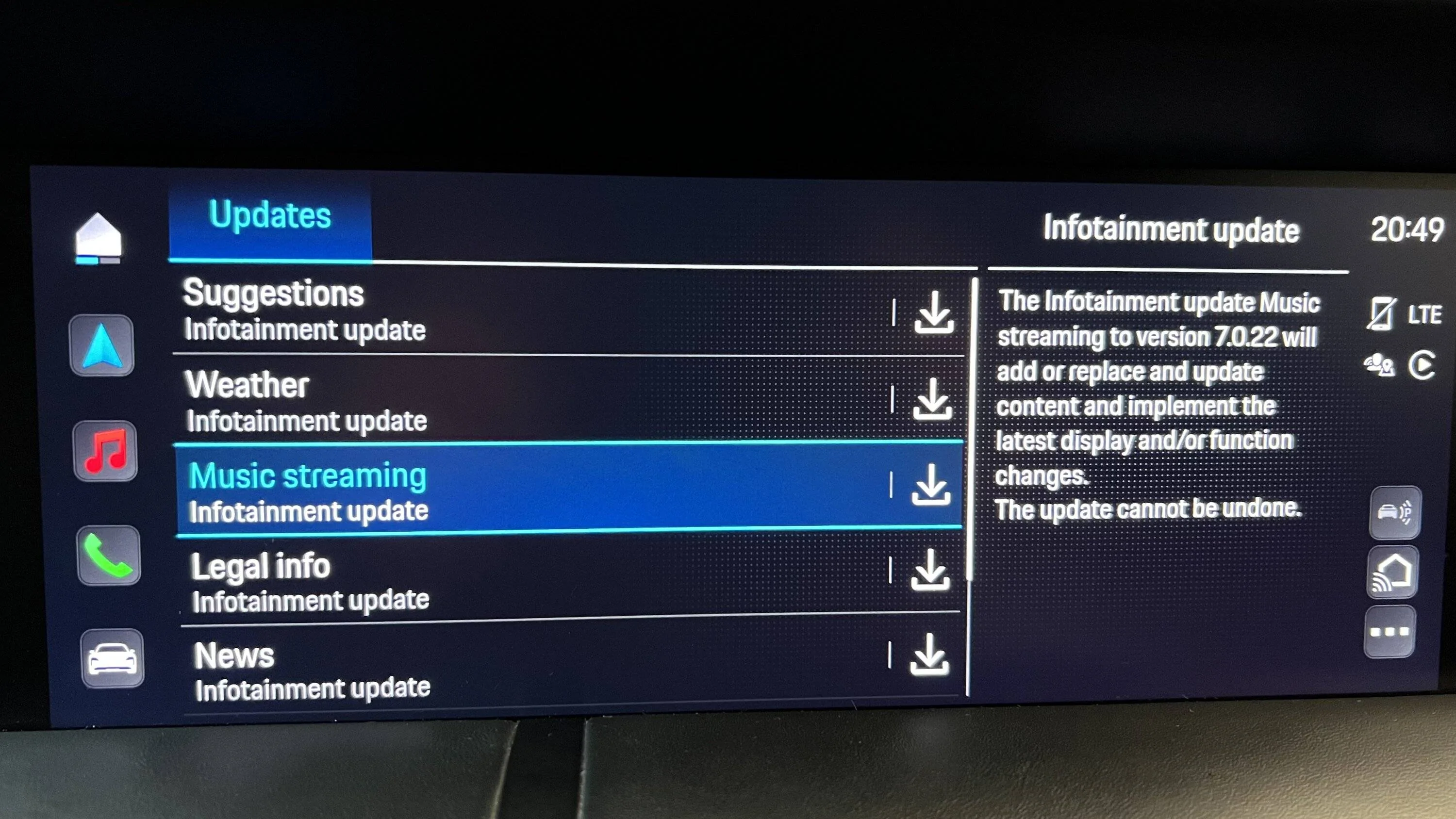

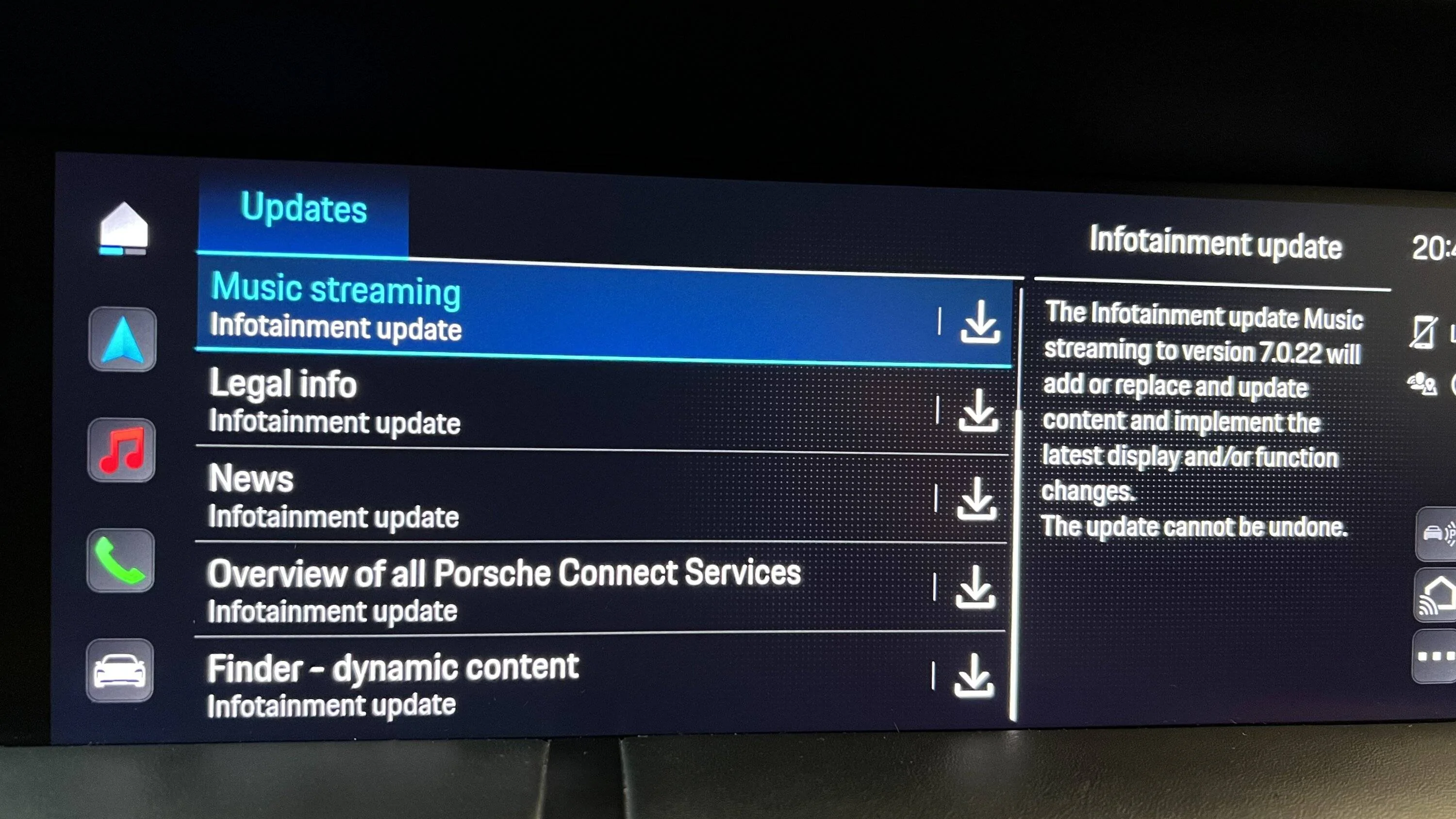

For anyone missing some of the expected features after the PCM uPdate (e.g Spotify or Android auto), I managed to “force” the install of missing components by the old trick of reboot PCM by pressing two fingers on the clock in the upper right corner.
This prompted the OTA download of several missing elements, including in my case Spotify.

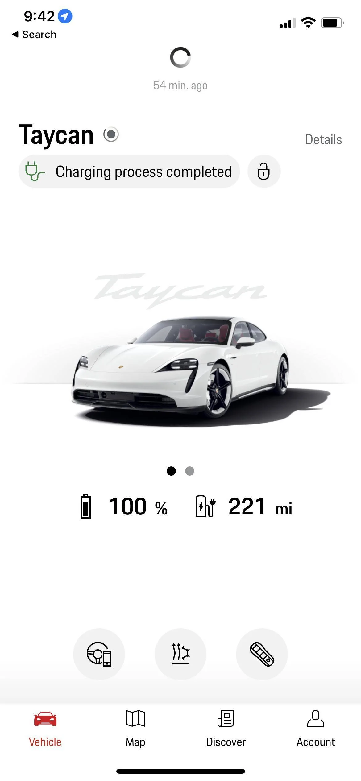

I did see a little boost. My Base ‘22 79kwh battery shows 221 miles at 100%. Before I was seeing around 200. I’ll take it!!
Software patch to make you believe it has better range....
