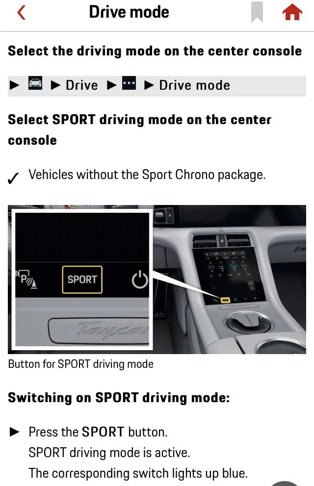

That’s a good point. I saw that @Valerian said the car was in Sport mode, but without the Sport Chrono package you must set this via the pcm. In there you can set the suspension to Sport without setting the Drive Mode to Sport. I guess I’m saying just be sure you are fully in Sport mode.
I guess there is a shortcut on lower center screen. Page from Good to Know app.

Thanks. I thought I had selected sport mode via the control on the right of the right hand dash display. It says sport and if you touch again sport plus but I never got the launch control ping Etc. I will try putting into sport mode via the central console tomorrow and see if that works. Thanks.
