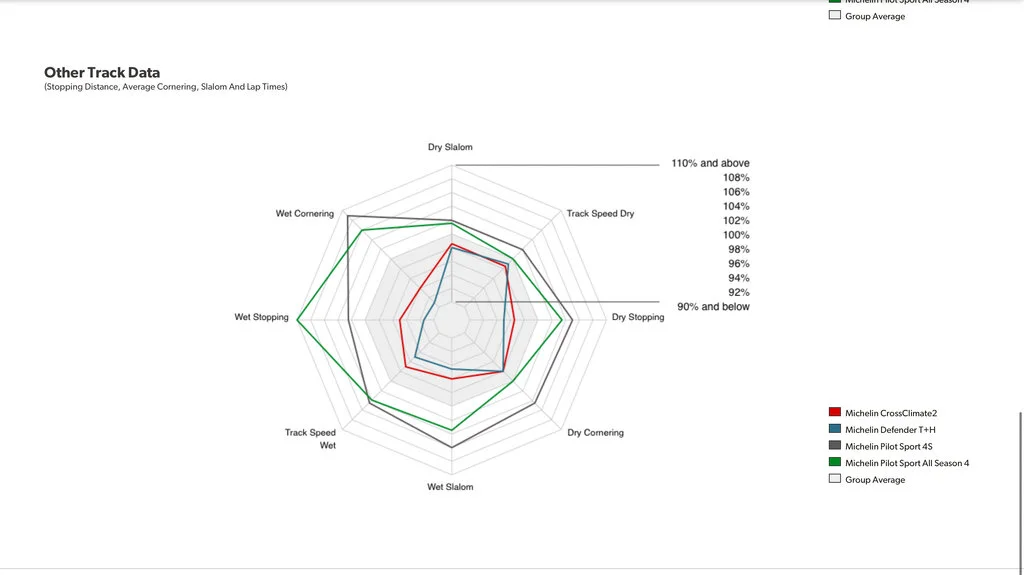

That model receives universal rave reviews. In the three German car forums I’ve frequented in recent years, I’ve never come across a detractor. Even copes with light snow reasonably well for an all-season tire.
I’m happy running DWS 06’s on 21” rims right now. Have not yet tested on snow, but great in the cold Seattle rain. I’ve had them on other cars and they are quite good.

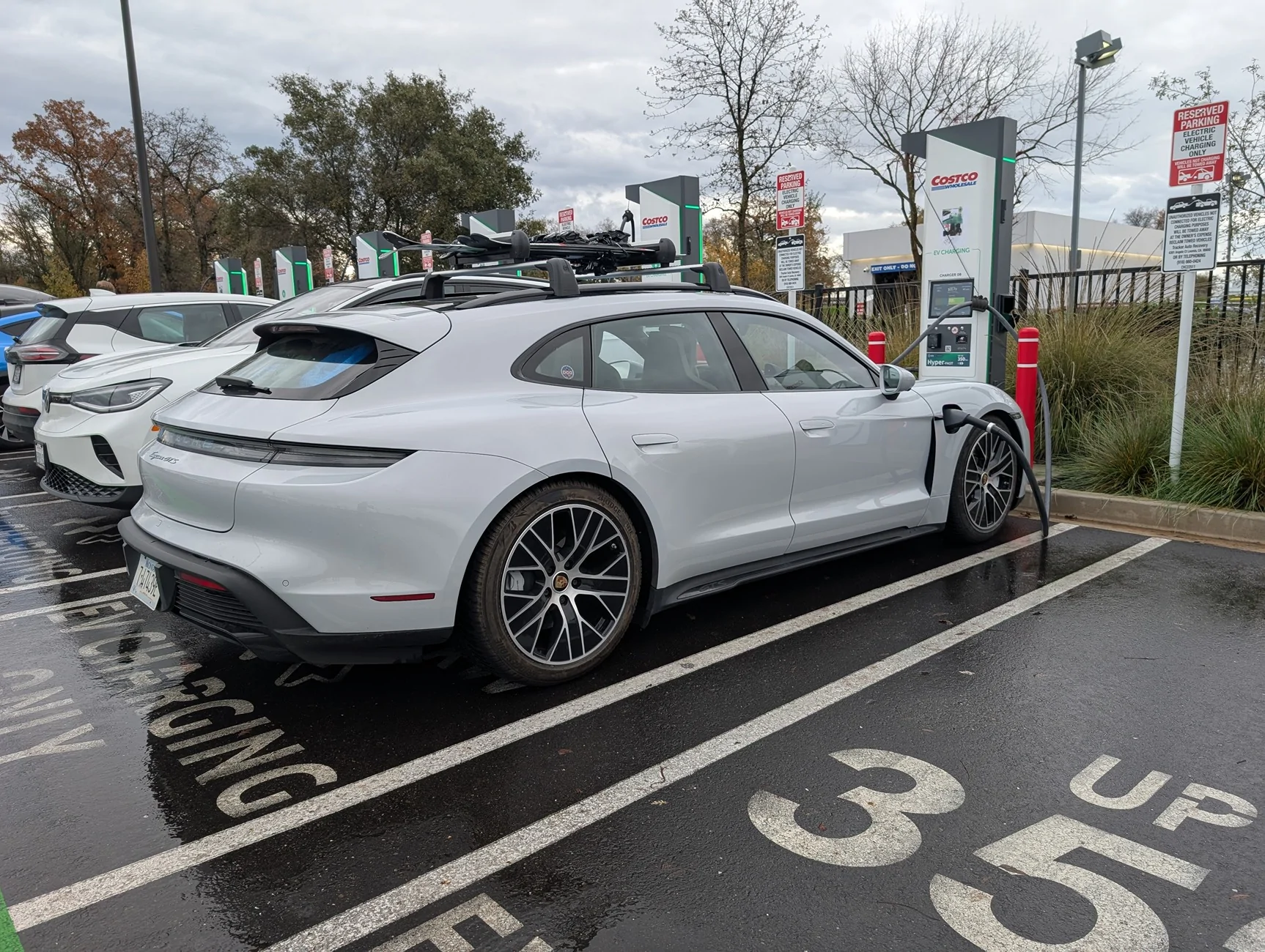

You and I are in a similar situation. I use Blizzak LM0005 on OE 20s this winter and got me through a snow storm.
Yesterday I just installed my OE 21s, still currently on Continental RX tires. I decided to run non-Porsche spec PS4s by spring next year. One thing I noticed was that my 21s had excess wear on the outer parts of the thread.
Anyways, bc I have dedicated winter tires, I elected to go with a summer tread for optimized performance, I'll probably regret it and sacrifice a lot of comfort.
Porsche Taycan Let's talk tires & rims PXL_20251221_213727489
