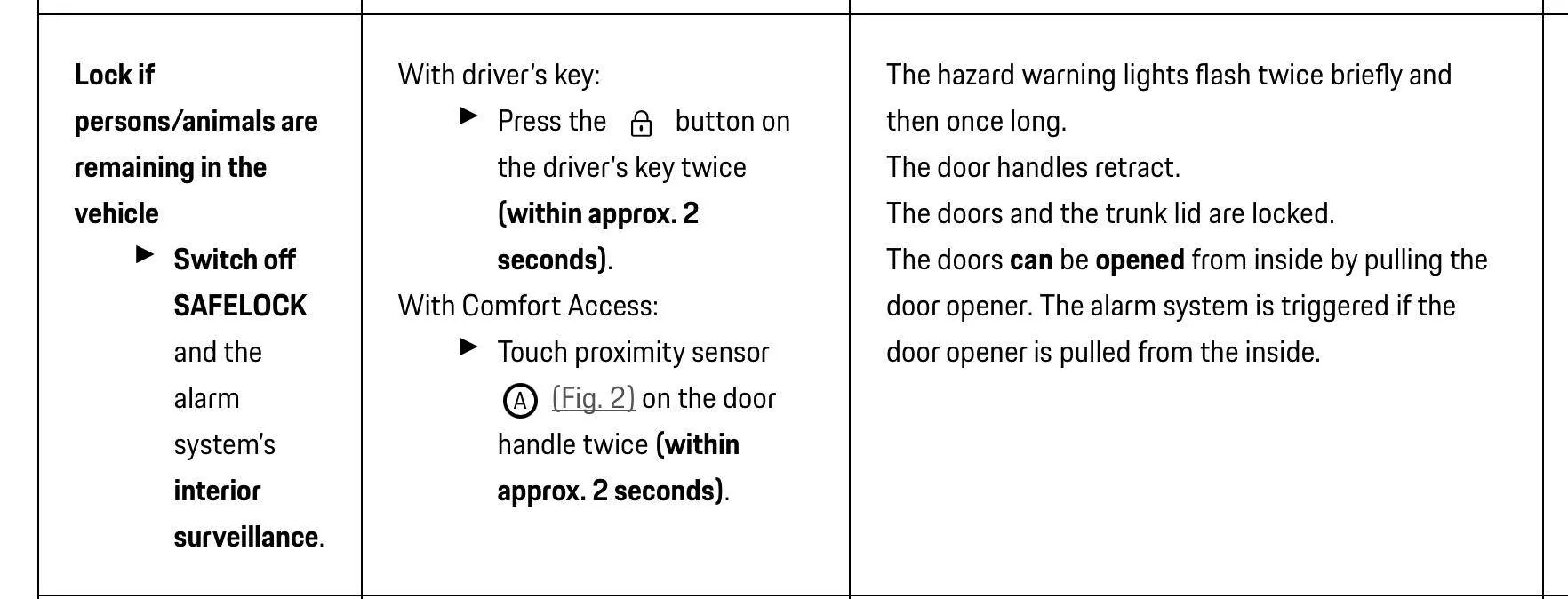

From the User Manual….
Thanks. May have to just experiment with the windows.
