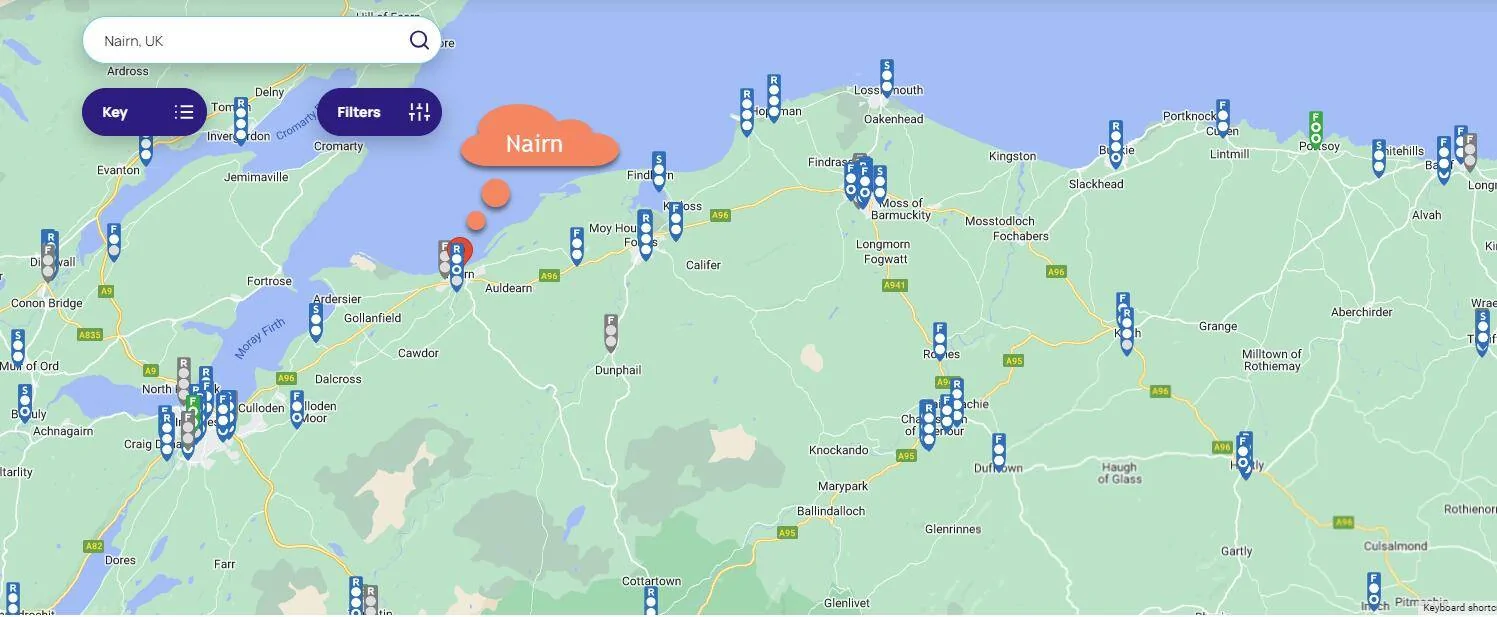

Snapshot from ChargePlace Scotland.
Porsche Taycan Longer Journey Advice 1710414758964-g0
Nairn has 50kW DC & 22kW AC Chargeplace Scotland units at a minimum.
