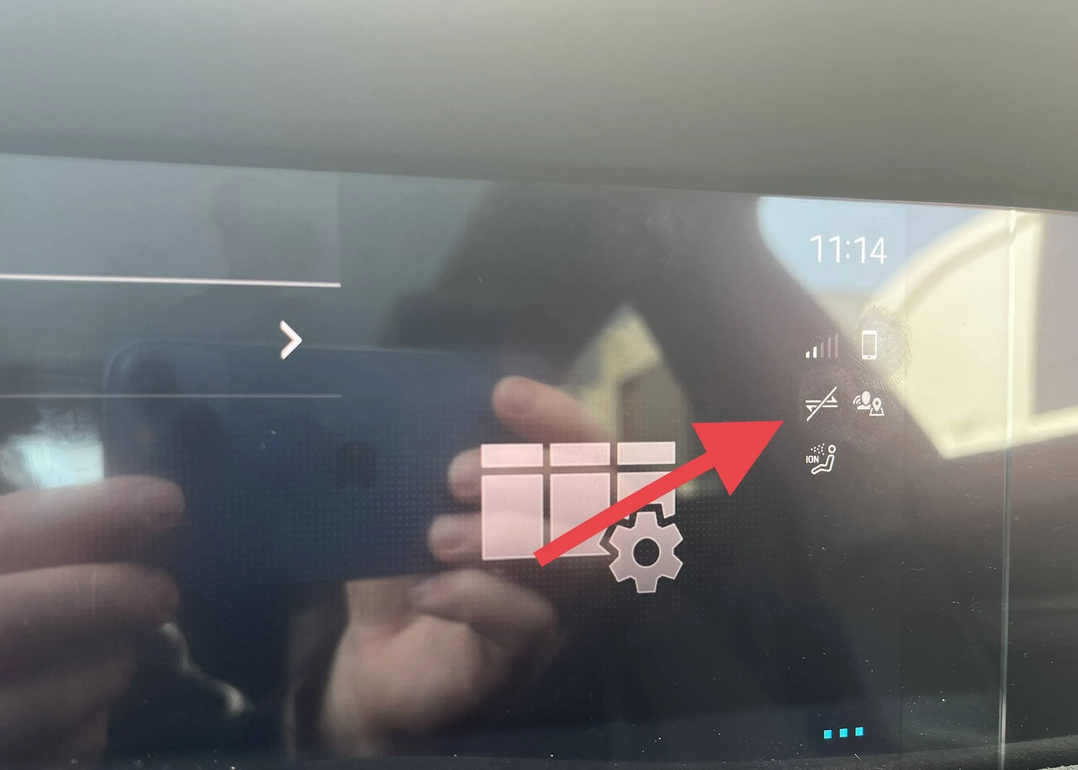

I collected my GTS last Wednesday, but from the beginning there is an issue with LTE connection.
PCM starts in privacy mode, I can deactivate it but I’m not able to add my account(Porsche ID) because there is no LTE connection.
My Porsche app is also very limited, all functions are greyed out.
I rang Porsche connect, they’re trying to fix it but no luck so far.
Porsche Taycan LTE connection 4BEE6F05-032A-4087-A5CD-A185D6199284
Is there any way to fix it ?

Without LTE the car won't be able to pick up your account when logging in. Take it back to the dealer and they can either swap the sim or it might be a dead modem. Or loose cable.

It is a known software issue. The odds that it is hardware related is slim.

Disconnect the 12v battery for a couple of minutes and then reconnect to force a hard reboot. It may help.

It is?
And how do you know by just looking at a symbol on the dash?
The symbol on the PCM indicates that there is no LTE connection. What are the odds of a previously functioning SIM card failing? Possible, not likely. The other possibility is the Control Module. Some have reported failures but in most cases the problem lies with the software.
You will have to visit the dealer and Porsche in concert with the dealer will diagnose and likely reprogram.

Of course its a guess, an educated guess. I have not seen the car, plugged it in or know everything that has occurred. The OP did not reach out to an online certified technical website. I am quite confident he is reaching out to those that have either experienced the issue or know someone that has. I have experienced the OP's issue. I am simply relaying information that I have obtained from various technical sources about this issue, which include some senior folks at Porsche. In the end, it does not matter as the OP will have to visit a service center to resolve the issue. Hopefully, it is a hardware issue that throws a fault. It will probably take longer to correct if its a software issue. There are not many folks at Porsche that work these problems and the local service tech's have no authority to fix anything without factory approval.
To the OP: They will likely reset the ORU warning and perform an automatic coding locked vehicle step for 30 minutes. This cleared the issue for me.
