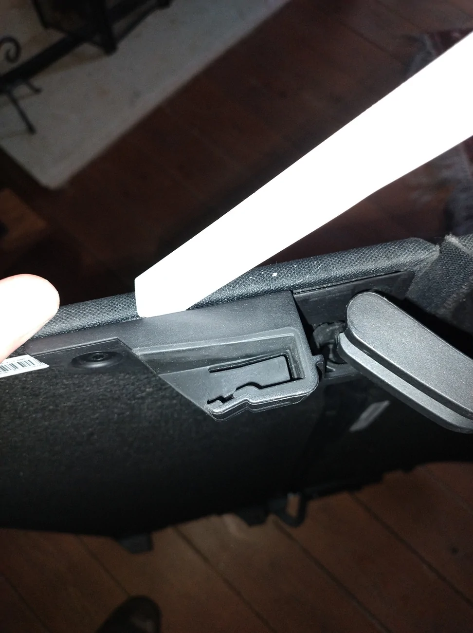

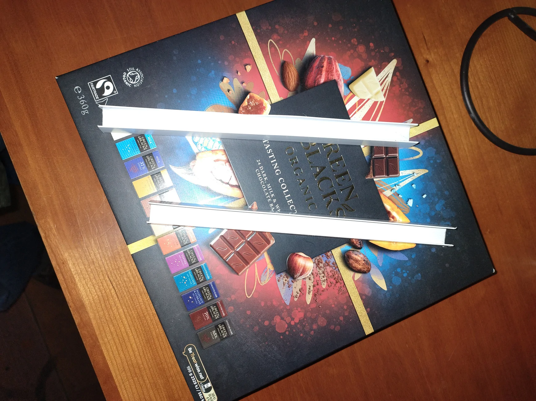

Alright. Inspired by recent demands from my various offspring to help with household moves, I expended some grey cells on the problem discussed and wish to share with this community the awesome solution I came up with in the interest of road safety. The solution kills two birds with one stone and is staggeringly simple, elegant and cheap. Here goes.

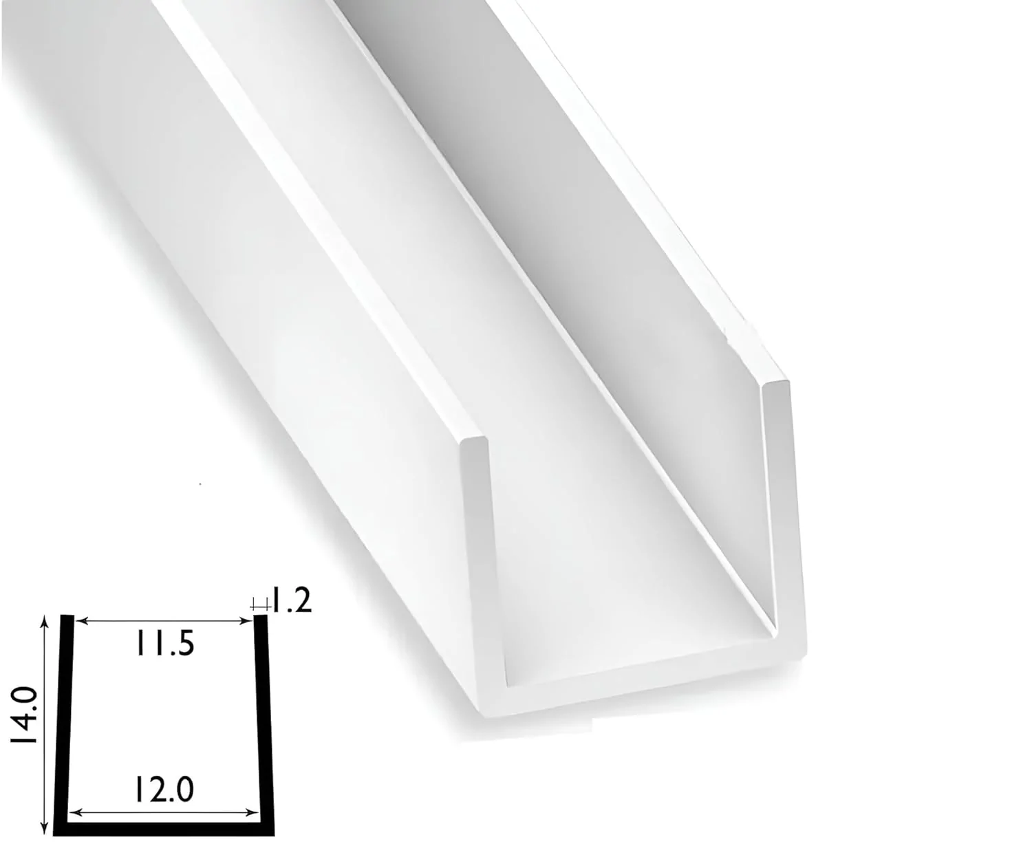

What you will need:
1 - a PVC U-Profile with the displayed dimensions. You want a black one but Jeff Bezos only had a white one available. That sucks for me but is great for you because it makes the pictures below clearer. Ideally you find one that "pinches", like the profile shown.
Porsche Taycan Luggage partition net for CT with sunroof 1769262208828-90
These things come in various lengths. You only need to cut 2x pieces ca 20cm in length. Precision is not required. The PVC cuts easily. I used a metal saw but you may get away with a kitchen knife. Deburr the cut.

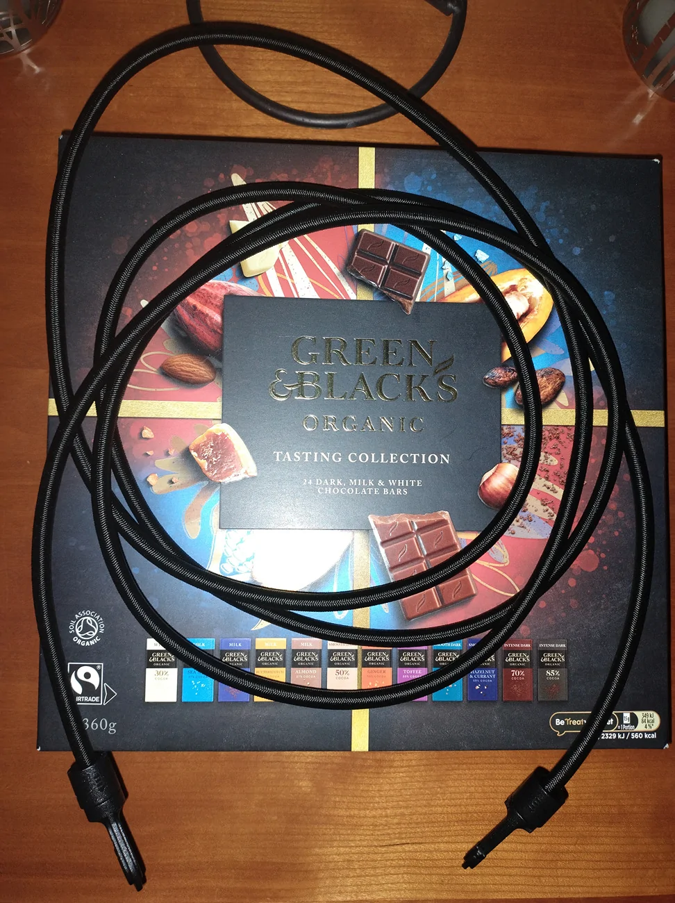

2 - a bungee cord, terminated with carabiners (or hooks). I used 6mm x 230cm, as shown. Again, you have flexibility.

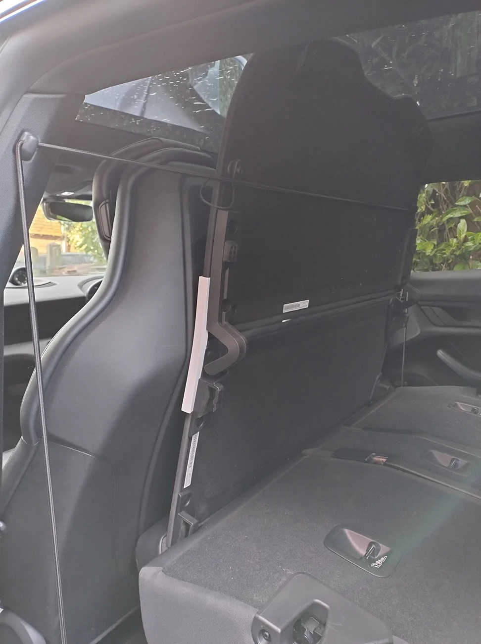

Let's proceed to accomplish two things: (i) protect the cockpit from curtain poles that turn into missiles in the even of a crash; (ii) find a home for the parcel shelf while abusing the Taycan as a removal van.
First, transform the articulated parcel shelf into a bulkhead.

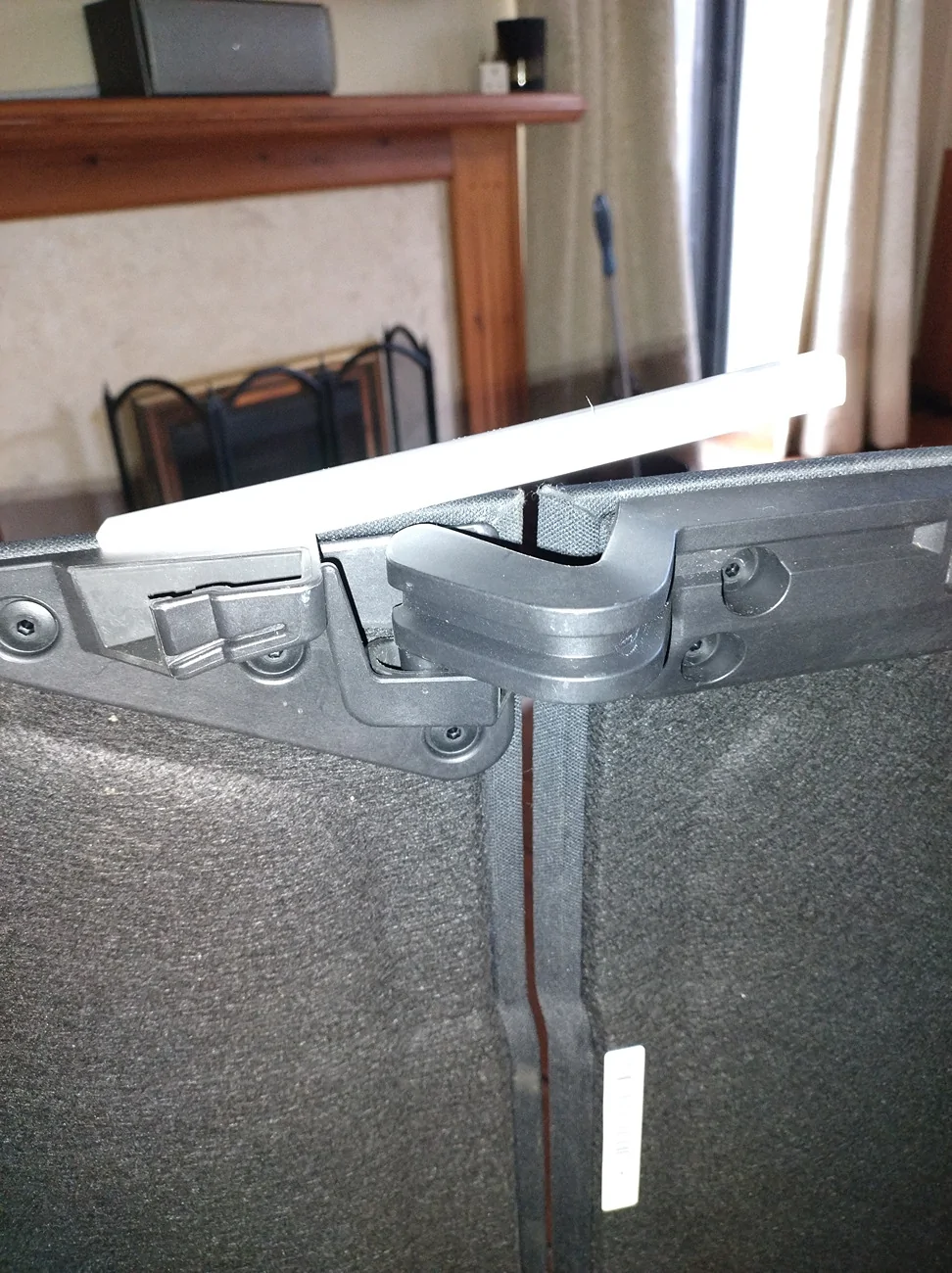

To do that, remove both panels from the car and loosely fit together outside. Then turn the assembly on its side so that you face one hinge. Now, using only the force of your fingers and palm, wedge one U-profile between the hinge fittings and the panel, like so:
Porsche Taycan Luggage partition net for CT with sunroof IMG_20260124_121419862
It may be a bit stiff but you can wiggle to get it in between. Next, fold down the U-Profile to span the gap to the articulated part of the shelf, and repeat over on the other side. As flimsy as each profile is, together they now perfectly lock the hinge. (Porsche could easily provide this solution be incorporating a locking bolt into the hinge. Help yourself, Porsche.)

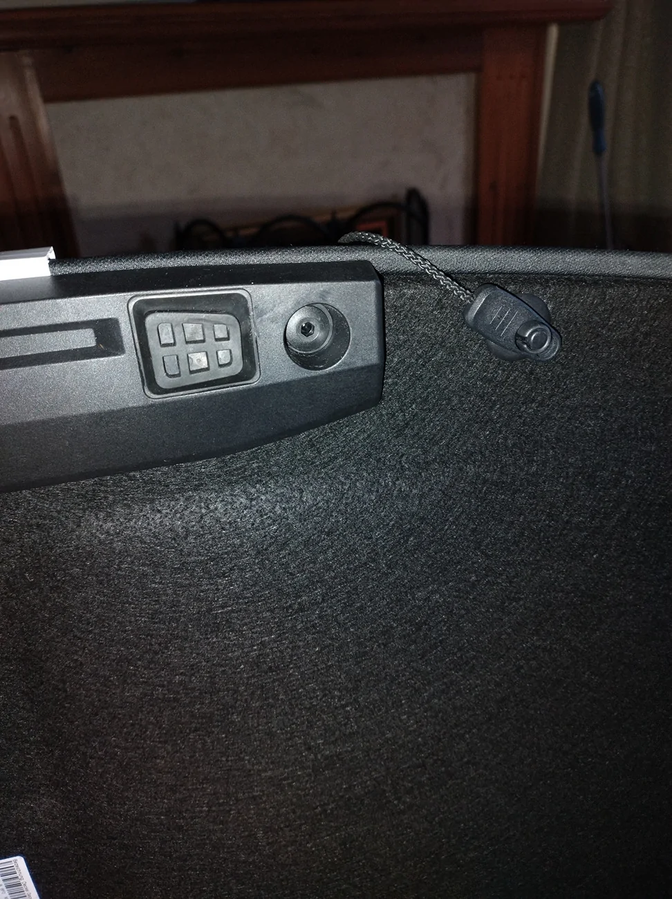

Next, a small detail, wrap the two cords around the back and attach to their base - it will stop the cords from flapping around later.
Porsche Taycan Luggage partition net for CT with sunroof IMG_20260124_121324013

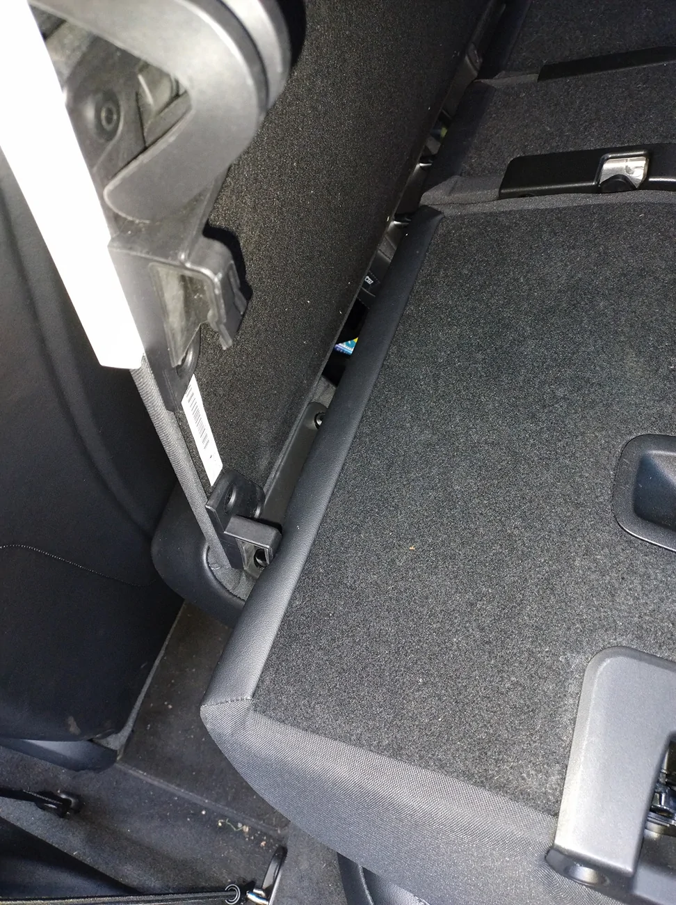

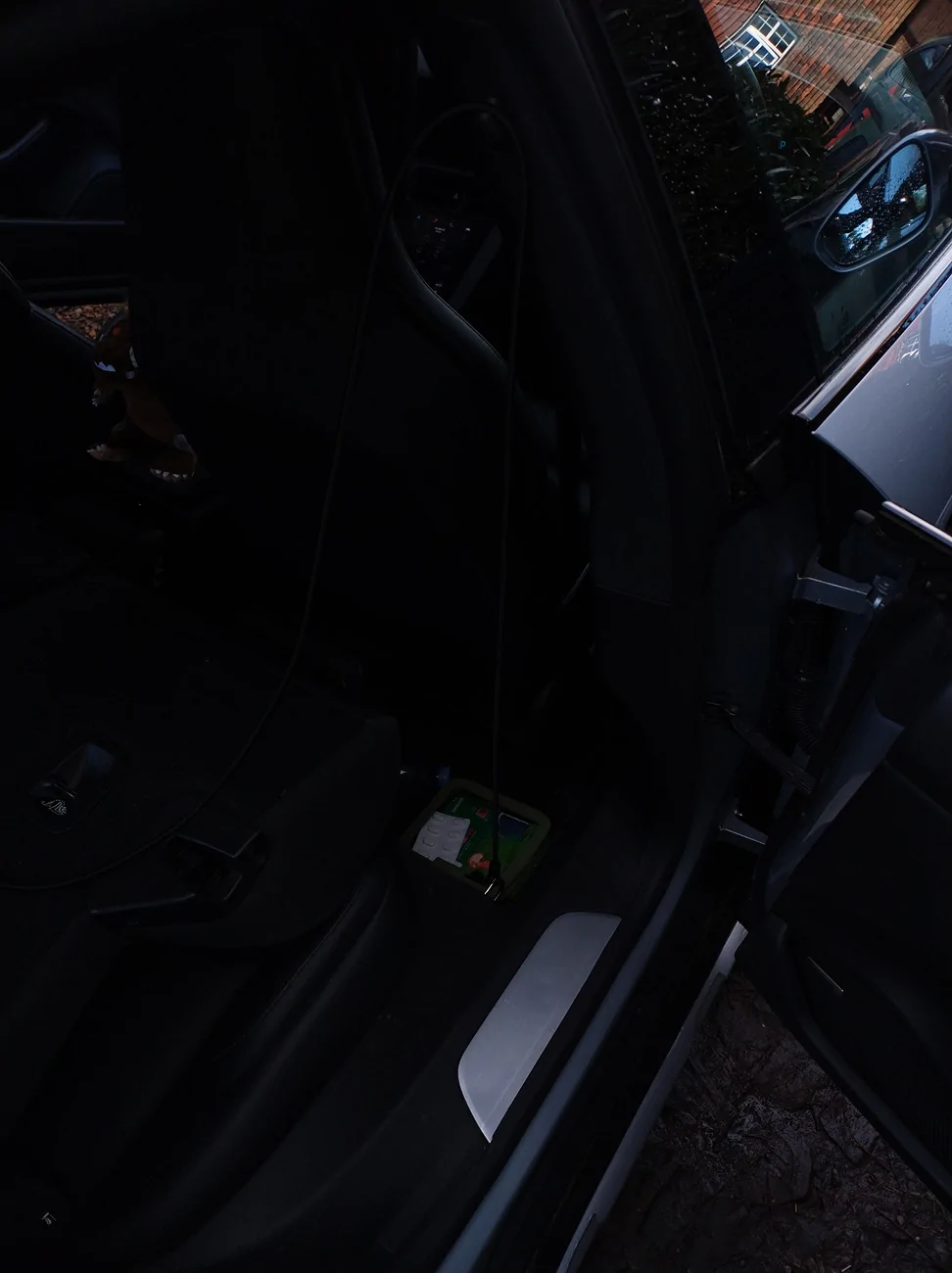

Now, left-handed drivers will want to work on the rhs of the car, right-handed drivers on the lhs. Both start on the respective opposite side. Fold down the backrest half way and extend the headrest. Ideally you extend it beyond the point it will go, ie you proceed as though you planned to remove the headrest (see manual).
Next, lash the bungee cord to the lashing point in the rear passenger footwell, routing the cord over the coat hook and loosely letting the end fall on the flat seat back. (I took a picture but the black bungee cord had its revenge against my black seats. So you need to imagine the whole thing.)

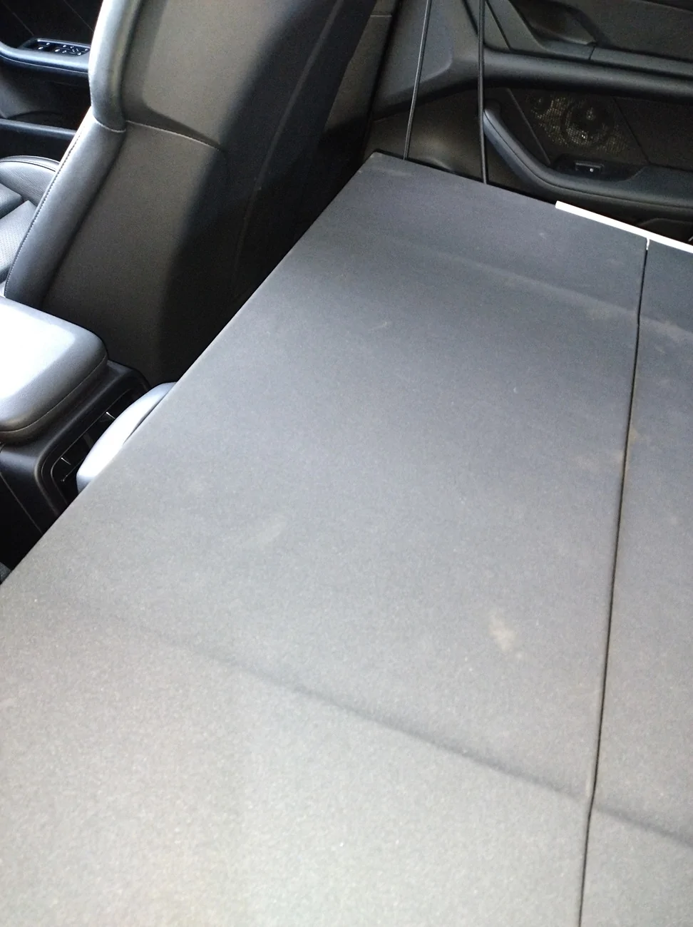

Moving over to the main side, put down the back seats in the same manner. (I find it helps to move the front seats forward and work the headrests at the mid-point, rather than flatten the backseats fully and then attempt to remove the headrests.)
When the rear seats are down, lay the straightened parcel shelf flat on the floor of the cargo area, then pull the thing forward such that it comes to rest ON TOP OF the loose bungee cord with the edge of the panel aligning with the gap between seat back and headrest, like so:
Porsche Taycan Luggage partition net for CT with sunroof IMG_20260124_120649796

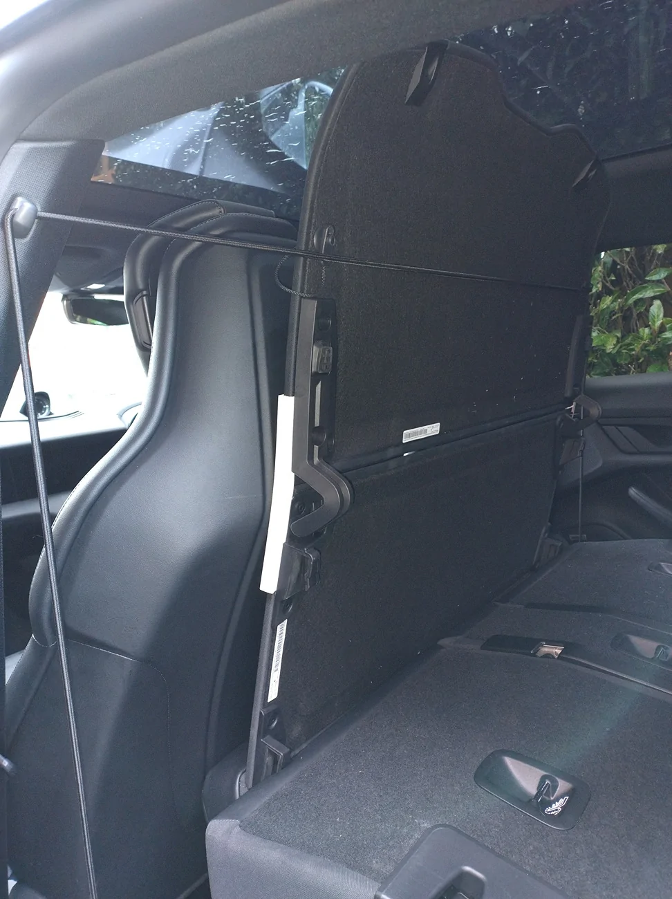

Now simply pivot up the shelf such that it stands on the rods of the 3 headrests.
Porsche Taycan Luggage partition net for CT with sunroof IMG_20260124_120608340
As you do this, finish the assembly by reaching for the loose bungee cord to pull it across the other coat hook and lash it to the opposite lashing point:
Porsche Taycan Luggage partition net for CT with sunroof IMG_20260124_120553269
You would struggle to design a better fitting bulkhead if you tried. Perhaps it should be wider. Perhaps it won't be strong enough to stop gold bars penetrating the cockpit. But leaning against the front seats, it will easily stop loose items from flying into the cockpit.
PLUS - we found a place for the panel which we can restore to its rightful place as soon as the cargo has been delivered.
Safe travels, fellow dads.
PS: The profiles are very flimsy. You might have to run a flatheaded screw driver or similar to remove them without damage. But the required bits weight nothing and easily store away under the floor in the back when not in use.
