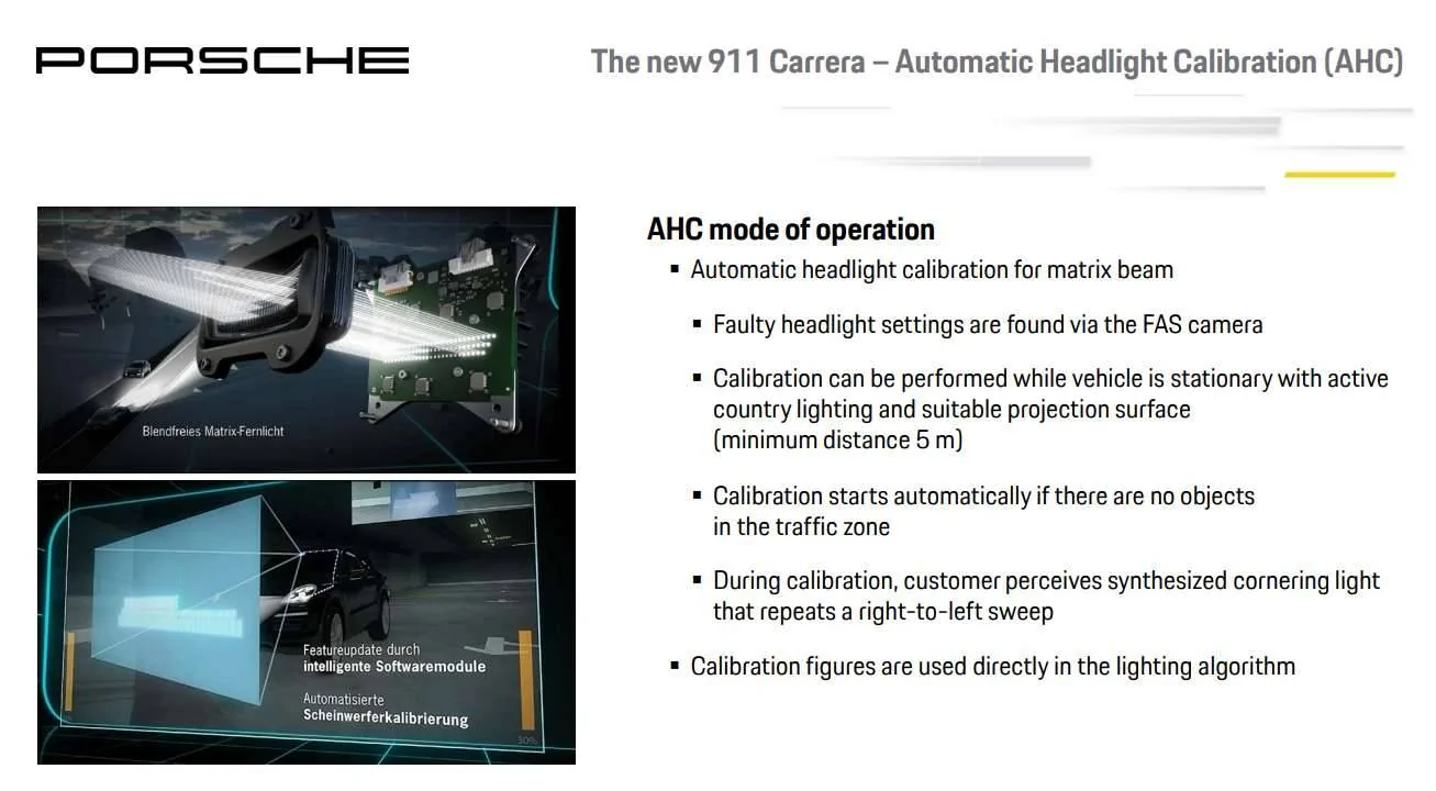

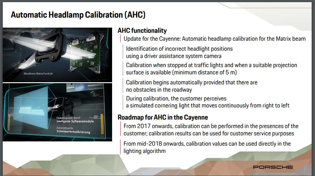

Hmmm, I've just done a quick search and whilst I can't find any Taycan specific reference, here's some info on the AHC auto calibration for other Porsche vehicles with Matrix lights.
Porsche Taycan Matrix LED Light Issue zzzscreengrab1720608574001
Porsche Taycan Matrix LED Light Issue zzzscreengrab1720608472001
Porsche Taycan Matrix LED Light Issue zzzscreengrab1720608373001

Just to update on my car, I finally found somewhere where I could park just over 5m from a flat wall during a journey out at night, which has been way more difficult a requirement than I had anticipated!
Anyway, with the dipped beam on and the car in park, it wasn't long before the auto calibration started and the lights on the wall started dancing around in waves as the various sections of the headlight matrix went through their motions. I left it for a while and it seemed to have a process which took maybe a couple of minutes which it repeated a few times. When I was happy I'd seen it do the same thing a couple of times I drove off as normal.
Fingers crossed, but it seems to have done the job and whilst I wouldn't describe it as perfect now, it's loads better now and perfectly useable. I felt that the matrix beams avoided other cars and I didn't get flashed by oncoming traffic once for the half-hour remainder of my journey, so I think possibly mine is solved now.

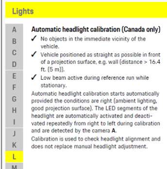

Procedure is documented in the owner’s manual but I guess the Porsche techs always either know better or overlook this useful reference source.
Glad you've got a solution (more or less).
Porsche Taycan Matrix LED Light Issue Screenshot_20240717-063458_My Porsch
88
8,307
7,320
