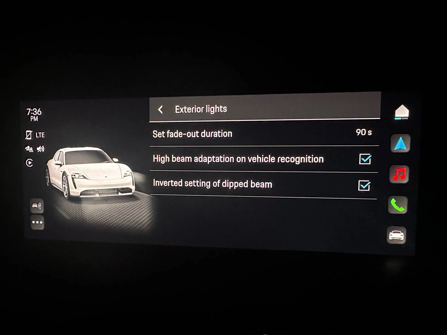

Any chance your car disabled the inverted beam for RHD? I know this is a remote possibility, but perhaps disable the inverted beam and automatic high beams, then re-enable them.
I'm only suggesting it because after a recent service (changing out onboard charger, which requires full car power-down, HV and 12V) my Taycan had completely non-functional high beams. This was after it was parked overnight, so car should have reset itself. Turning off automatic high beam and turning it back on, brought the full functionality back. This tells me that it is possible for the settings in the PCM to not reflect settings in other ECU's until you explicitly change them.
Oh wow, you might be onto something there! I was sure I had played with these when I first got the car, but having toggled these 2 settings a couple of times tonight and waited for the car to confirm it had applied the changes I see a noticeable difference in how the lights are behaving :D
Porsche Taycan Matrix LED Light Issue IMG_3490
I’ll test more as the week goes on, but I feel like although it’s definitely still not perfect and I’m still lighting up the left hand edge of the car in front when turning right, it’s significantly less now.
I feel light the lights and the shadowed areas they generate are a lot more coherent now and I can tell what they’re trying to achieve whereas previously they moved around a lot, but I found it hard to define what they were up to, as though the left and right ones were conflicting if that makes sense? Some definite progress for me here, thank you :please:

Reading the manual, it appearrs the "inverted setting of dipped beam" should only be ticked if you're driving on the opposite side of the road. So for a UK car, driving in the UK, the tick box should be off in general?
There was a previous bug where this would "toggle on" without any user request; but that looks to be fixed.
It's conceivable that there could be a bug where the displayed setting (ticked or not) does not correctly match reality (and that toggling the tick box could re-sync) - but I guess for "driving in your home country" the box should be left unticked?
The manual describes the feature "flattens" the dipped beam so that the nearside illumination (eg the verge closest to the car) that is normally highlighted, is not. I'd be surprised if this affected full-beam/ matrix LED though?

Correct. Inverted in UK is only needed when in an EU country driving on RHS of the road. PCM NAV should auto select when say in France.

Back when I was still doing calibration on the dyno I had so many customer cars come in with this setting selected (or similar). I saw it right away on the beam pattern on the dyno wall. Almost every modern car has it.
People just tick all boxes on without understanding what they do with the logic that "more is better". All of these drivers were blinding other motorists, I hope I made at least someone's day better by fixing the setting.
But if it is indeed the issue in this case, then SHAME on the Porsche dealer for not checking such a simple setting. Completely incompetent.

I don't think having the box ticked blinds anyone; my impression is:
  • unticked = normal: the beam pattern is flat, with an upward kink on the nearside (to illuminate the nearest verge for pedestrians, animals, signs etc)
  • ticked = opposite driving side: the beam pattern is flat, without the upward kink on the nearside
I haven't tried it on the Taycan but on some other cars it inverted the cutoff pattern so the left and right was swapped.
That is what it did when I played with it on my Taycan (after enabling the EU matrix function on my US car).

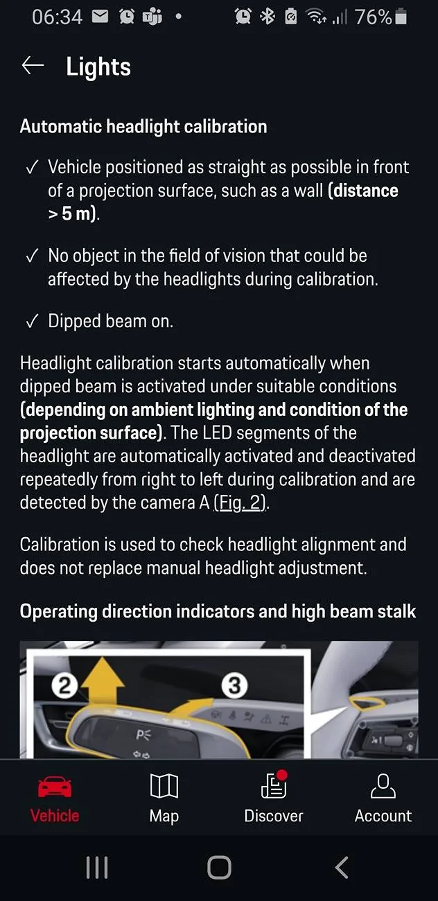

Procedure is documented in the owner’s manual but I guess the Porsche techs always either know better or overlook this useful reference source.
Glad you've got a solution (more or less).
This instruction doesn't seem to be there for the MY25 manual. What setting controls "dipped beam on"?
I played with this tonight- I found it quite hard to get the self-calibration to run. It will do it in drive, hold, park, or even with you (and the key) out the car. Has to be on level ground in medium suspension height, steering straight, auto lights on dipped beam, the right distance from the wall.
The video shows roughly what should happen. Interestingly my calibration somehow fails to leave a straight line - which hopefully explains why I am getting flashed and can be easily sorted out at dealer 🤞

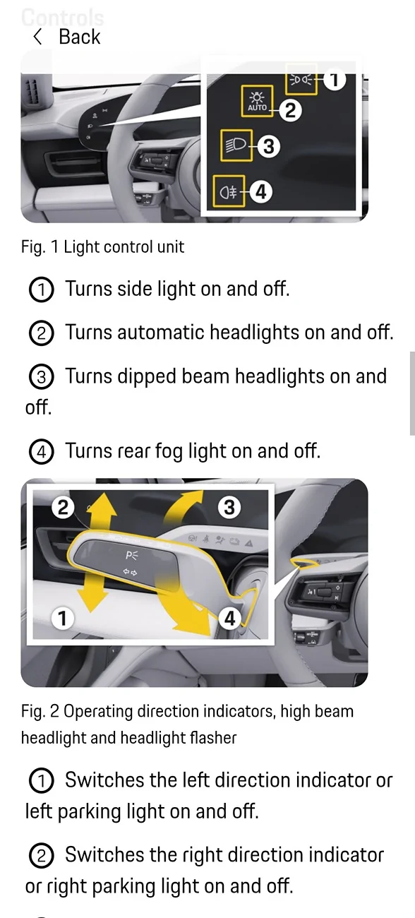

Power on the car, tap the dipped beam icon on the main instrument panel - glows green.
Suspect they prefer owners to get calibration checked by the Dealer.
