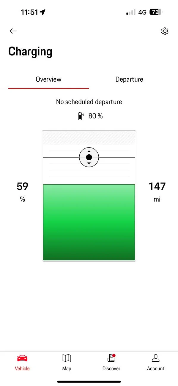

In the MyPorsche app I don’t have any options for timers/profiles - just Departures - and there’s nothing obvious in the car’s Charge settings either (unless that’s moved?).
Do you have the Porsche Connect services active - there are several and at least one relates to charging?
Check your Owners manual but it appears you are missing some features in the app.
It could be that MY25 has simplified things - the slider control is new for example.
Your online manual via the app will be tailored to your car so check there first.
Perhaps it's implied in the slider when you set the charge level? What happens if you tap the centre of the slider?

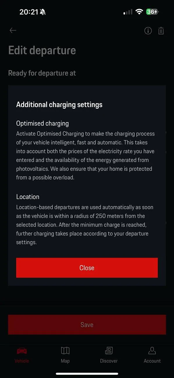

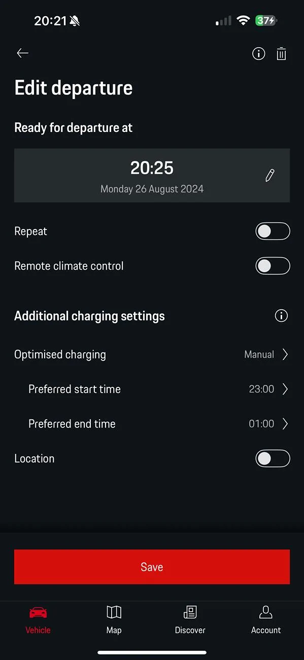

They have kept the location side of things in the Departures setting - and that led me to have another dig as there’s an “Optimised Charging” option in there (although the description doesn’t seem to help much - I haven’t found anywhere to enter electricity prices for example and the manual seems to suggest that’ll need extra kit). However if you set that to manual it does then let you specify a preferred charge window. This doesn’t seem anywhere near as clear as the previous system (and the manual really is not clear either) but it looks as though the functionality is there at least.
The optimised charging relates to the additional Porsche Home Energy Manager (HEM) equipment
eor quivalent. This enables the use of dual power sources for charging (grid and solar) and is also where pricing information can be entered.
Preferred Charging times is where you want to be and is part of the original profile setup.
My guess is that if not using your Octopus controlled setup then the profile is now to simply slide the bar on the battery display to set the minimum charge and then set your preferred timing window. The departure element is part of the timer and let's you set 'ready by' along with cabin preheat / cooling.
Annoying that owner's manual is model year specific otherwise I could stop guessing.
