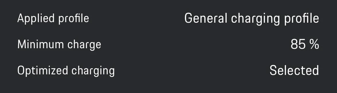

I want to charge to 85% whenever I plug in. I don’t care what time it is.
General Profile
85% Minimum
Optimized Charging
I’m basic. ?
