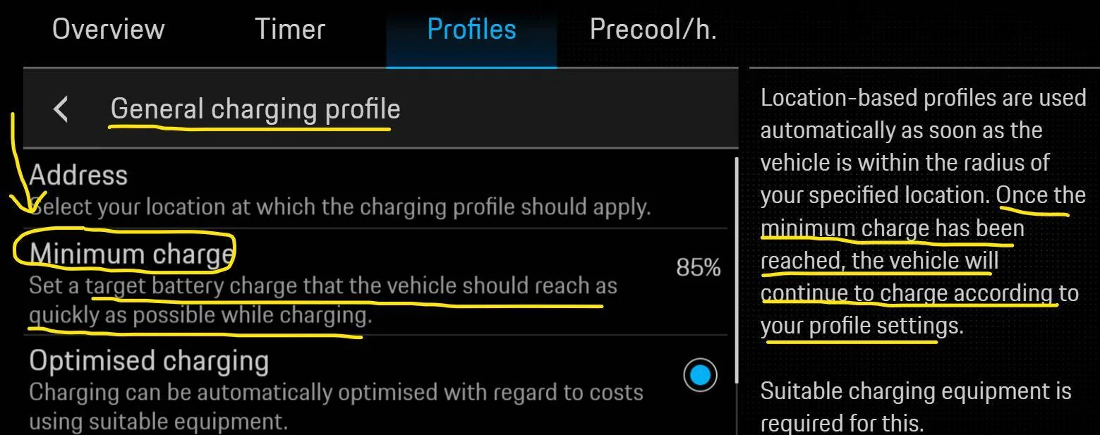

That profiles stop at the min? I agree that’s key, but, I guess I still don’t get what everyone finds so confusing about it all.
Today I used charging menu to change general profile amount of charge. I saw the following in PCM:
Porsche Taycan Taycan Charging Quick Reference [Profiles and Timers] 1692561236467
PCM says the same thing as @Jhenson29 keeps repeating in multiple posts.
Amazing! ;)

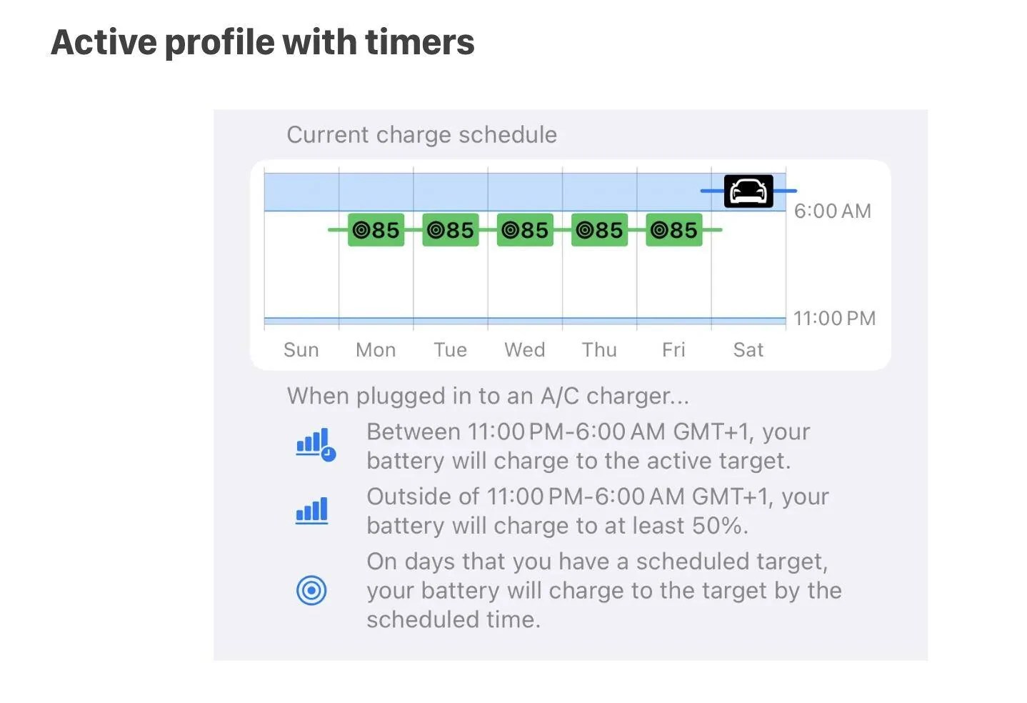

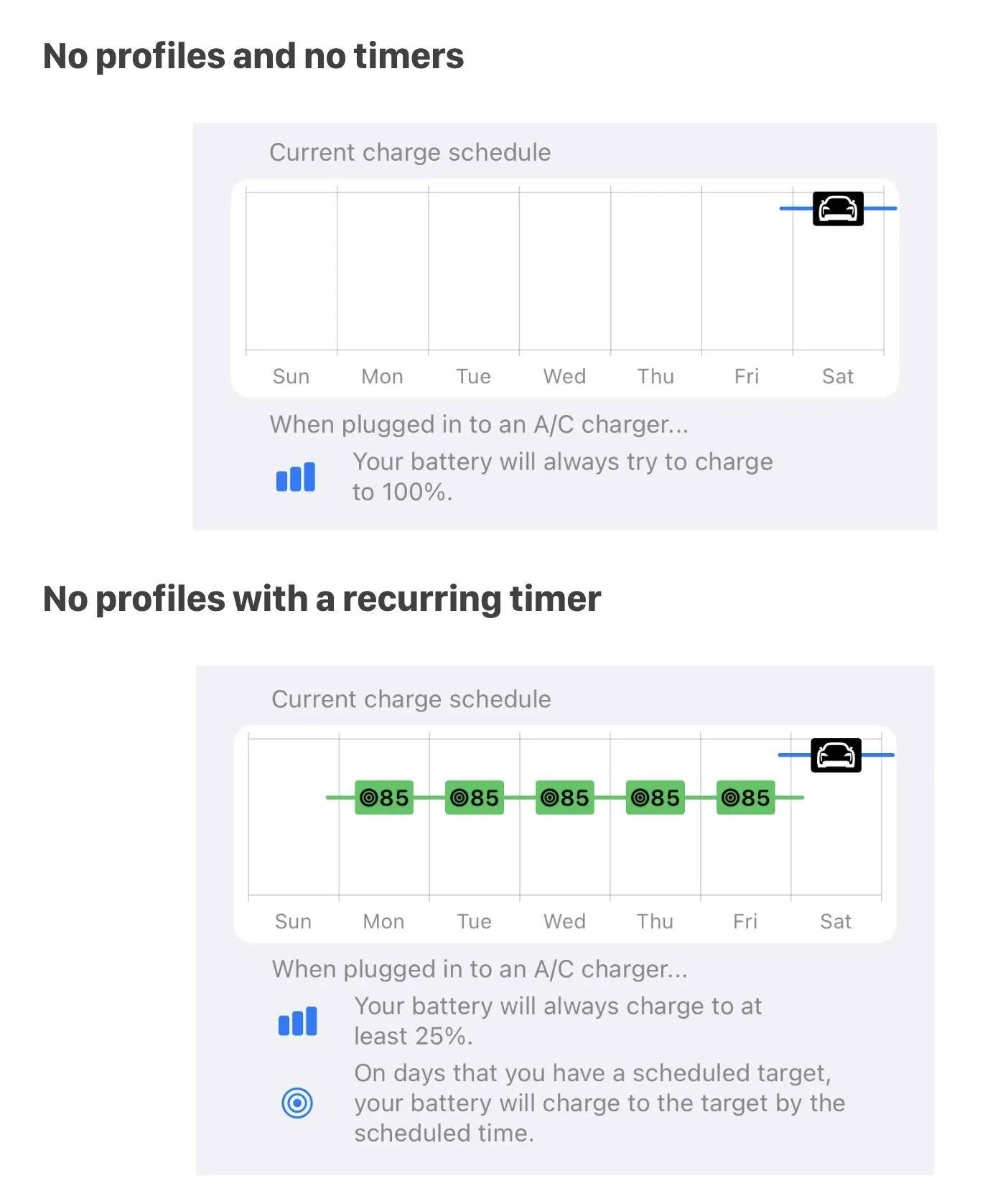

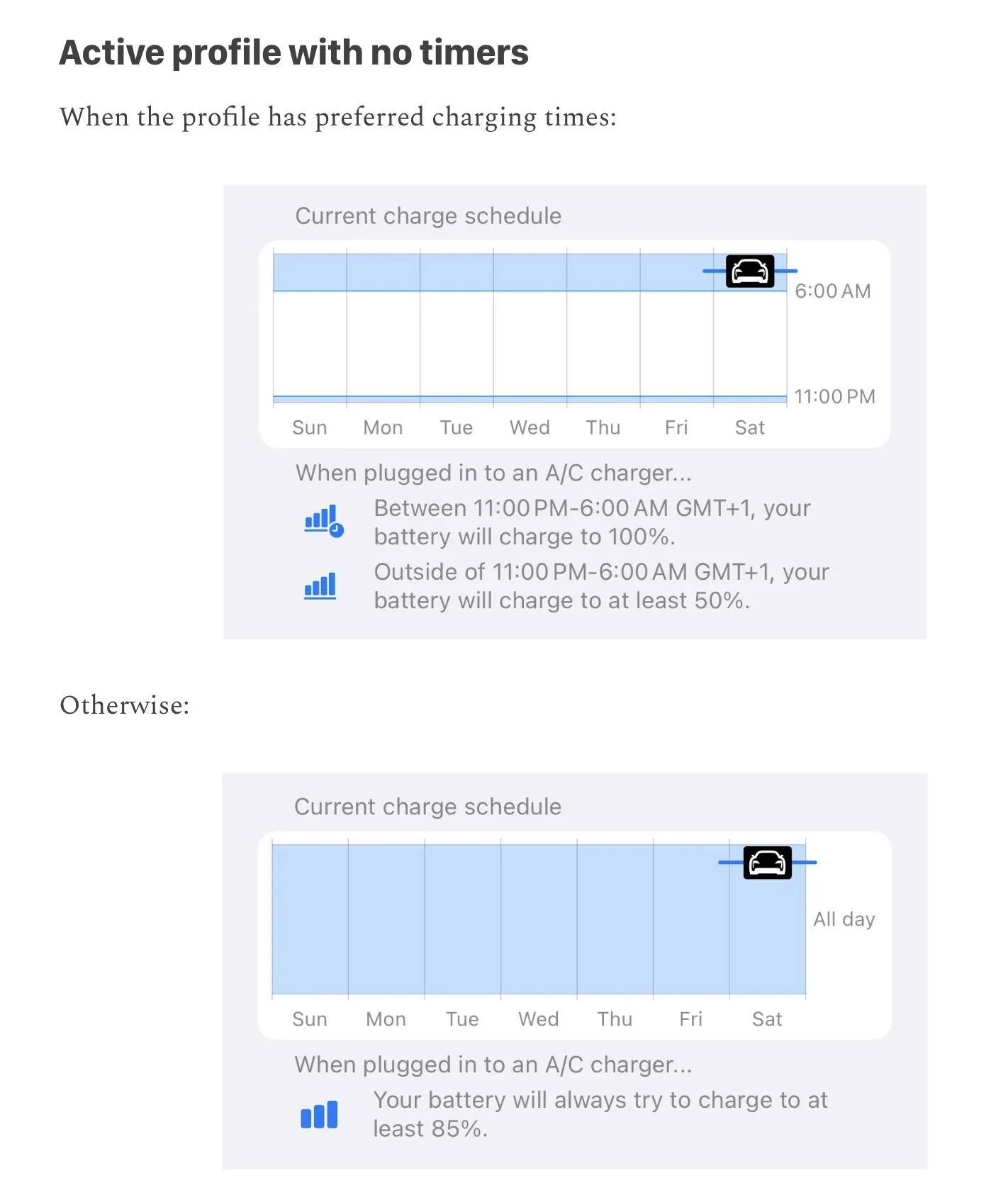

I've just added support for visualizing the complicated logic behind the Taycan charge schedules to Electric Sidecar v1.4.0-42 as part of the Storage Mode update. I think there's quite a bit more that could be done to make configuring these schedules easier, would love any feedback on the new UX!
https://electricsidecar.substack.com/p/storage-mode-in-electric-sidecar for full design details.
Porsche Taycan Taycan Charging Quick Reference [Profiles and Timers] Screenshot 2023-12-09 at 5.24.24 AM
Porsche Taycan Taycan Charging Quick Reference [Profiles and Timers] Screenshot 2023-12-09 at 5.24.27 AM
